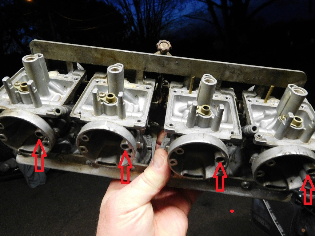

          All good suggestions. What I do for a quick pilot orifice carb clean is remove only the pilot fuel screws (remember how many turns out) and pilot jets. Blast some carb clean through those orifices' and also the air pilot jet where the air box connects to the carbs. Blow some compressed air through and put it back together.
