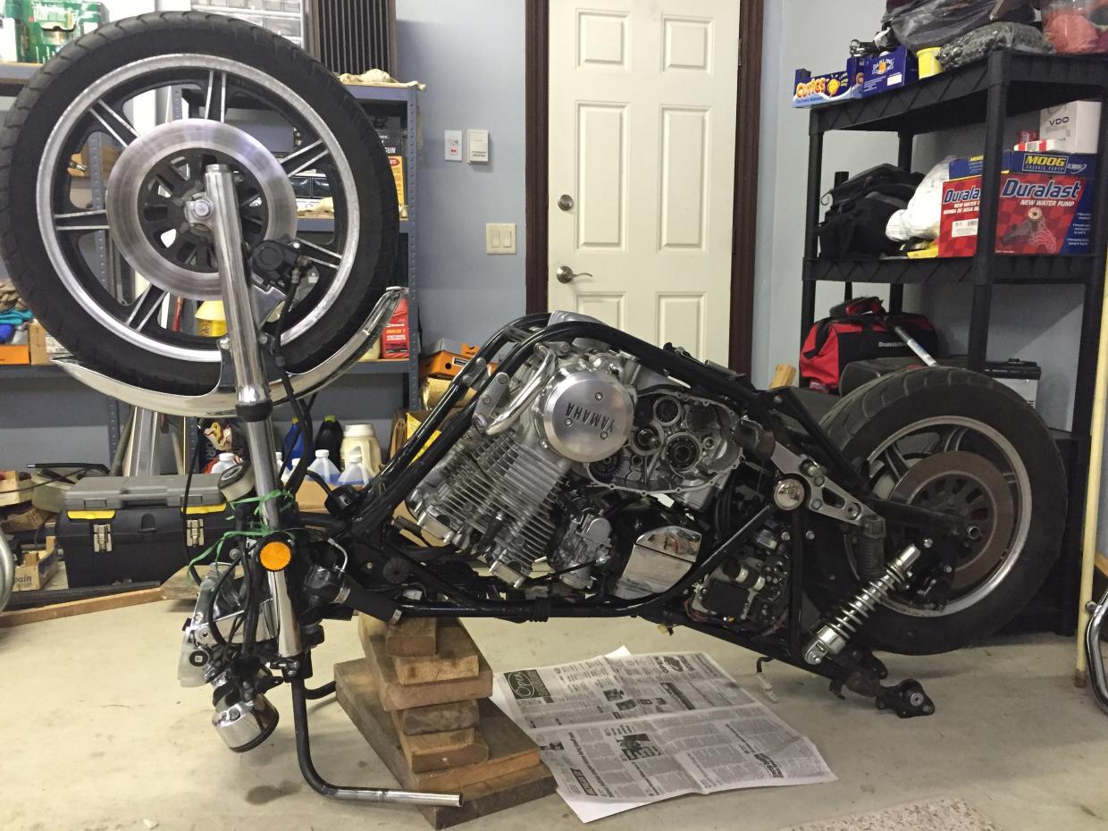

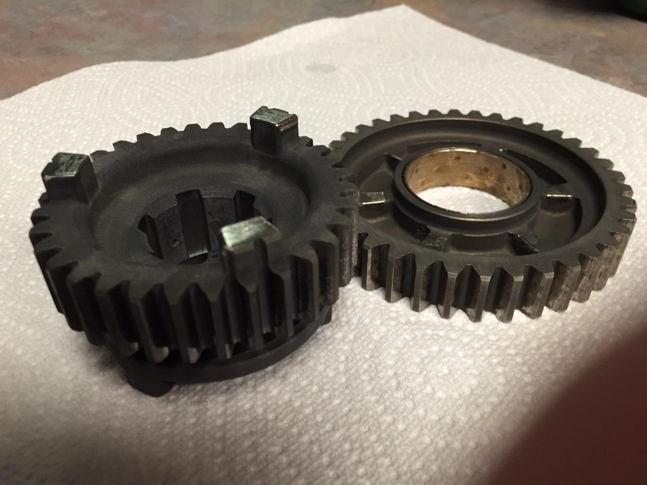

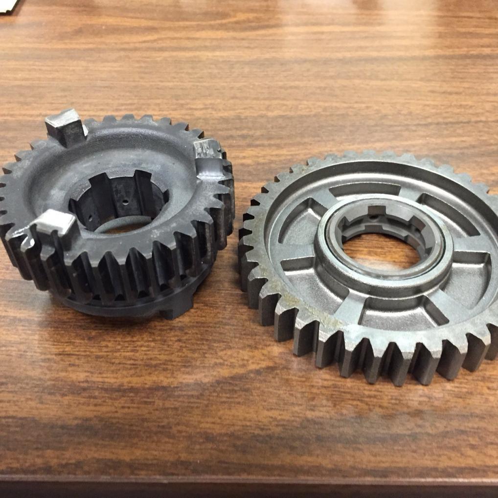

      I had the same experience as you. I bought my bike non-running with 15k miles on it. When I got it running, I was disappointed to find first gear slipped horribly. I was to fix it using the information in these posts. I found a new first gear, and a new 5th gear, but I had hire a machine shop to grind the dogs on 4th gear ($40).
      Click image for larger version  Name:	IMG_0077 Rotate.jpg Views:	0 Size:	173.2 KB ID:	882428 Click image for larger version  Name:	IMG_0113 upright.jpg Views:	0 Size:	112.8 KB ID:	882429 Click image for larger version  Name:	IMG_0139.JPG Views:	0 Size:	133.0 KB ID:	882430
