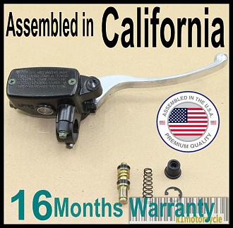

        I've had decent luck using units similar to this on other bikes, you'd need to swap out the brake line and go with a single hose from the MC back on the XS11.

          LAB3, do you think that Chinese unit is safe for a large bike?

              Lab3, that'd probably work but it's not altogether disimilar to what I've got in hand already. Also seems too good to be true. You can barely get that much raw aluminum for that price.

                As mentioned, a similar unit. During the early part of the COVID freakout I rehabbed an 82 Goldwing and used a generic rear like that one but I did make sure to get one of a similar bore size to the original.
                The cheap front MC's that we've both touted on here are probably cheap Chinese units as well.
                  • 2001
                  That is correct, they are also Chinese. Point taken.

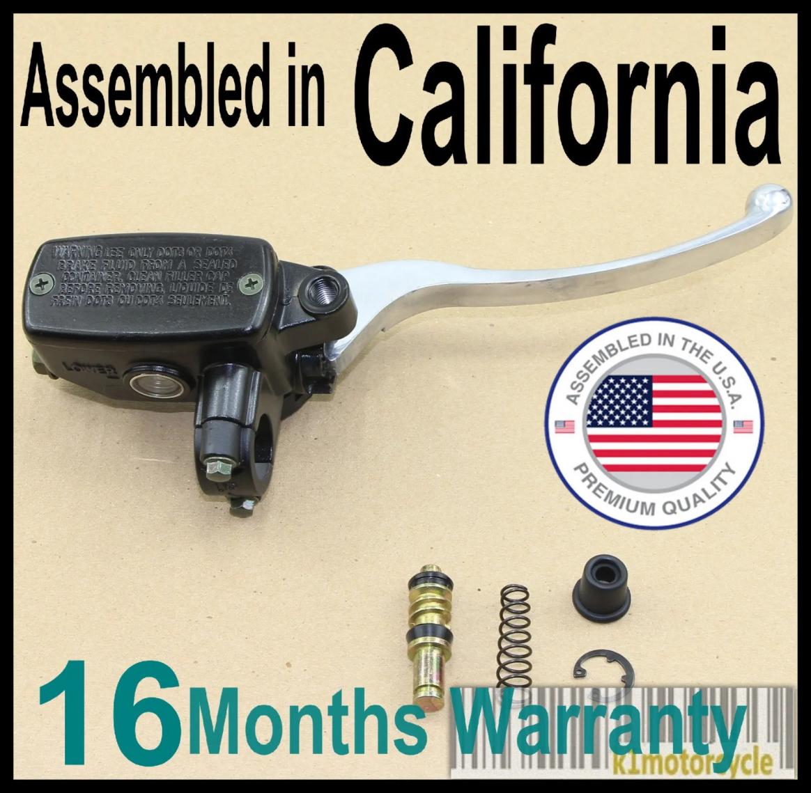

                    There is a substantive difference between the chinesium stuff made out of soda cans and the stuff they reverse engineered or stole the prints for. All manufacturing is overseas now, discernment is the name of the game. Price point is usually the first clue.
