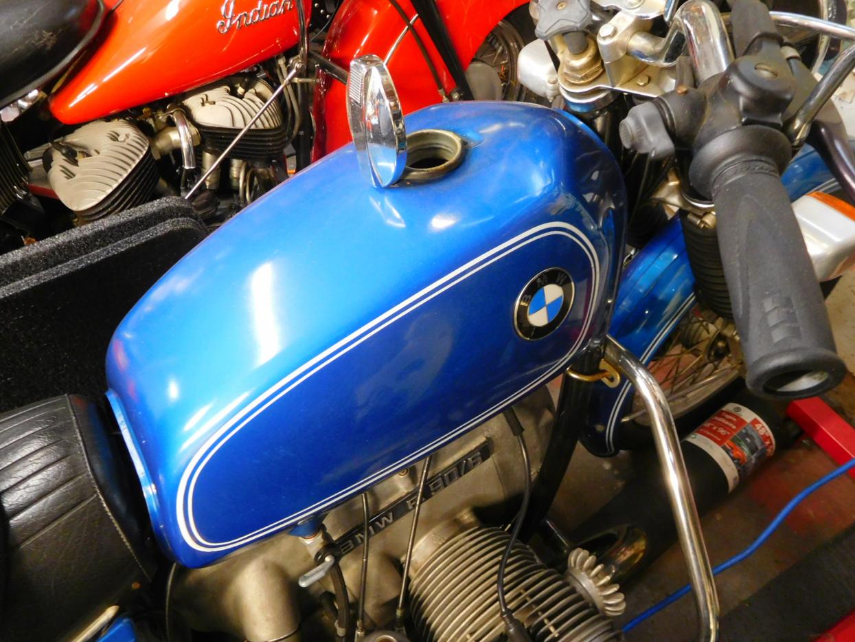

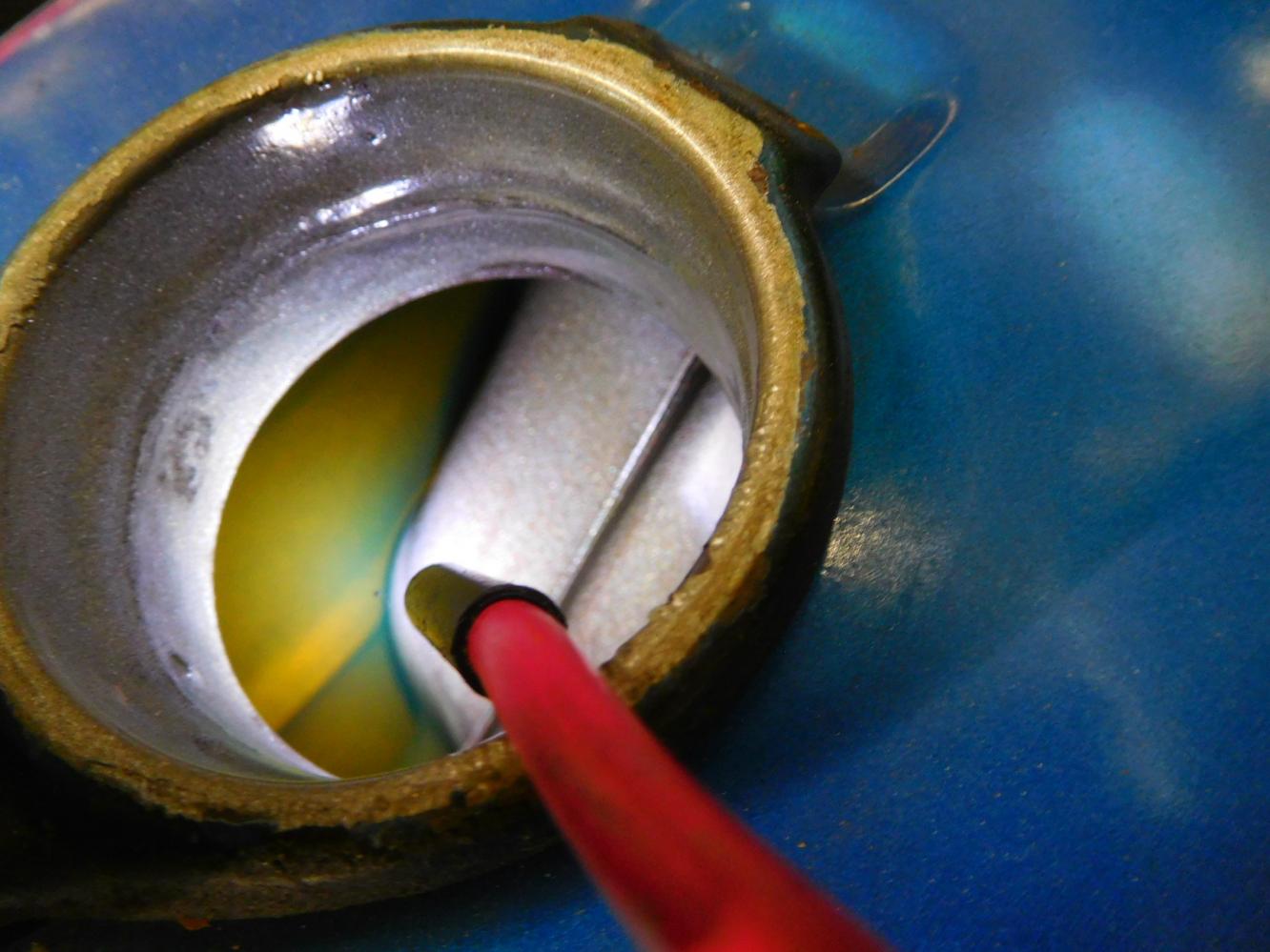

          This is a 74 BMW I did in 2006. Stripped out the red factory liner and then used POR15. Still looks great in 2023. Click image for larger version
ID:	872940 Click image for larger version
