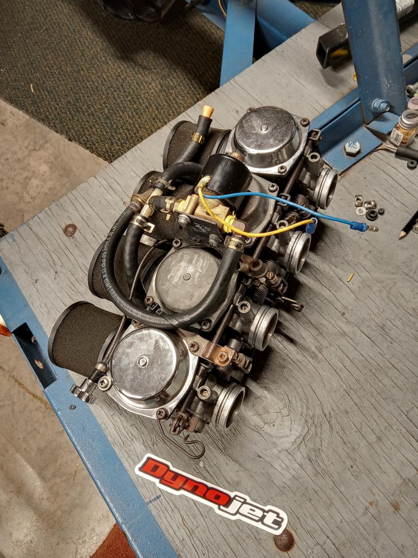

                    Single line, now plenty of room for electric shut off valve. Used a nylon T on this set.

                      Ok, now we need to know more about the electric shut off valve. Are they availabe? Source?
                        • 8938
                        Ok, now we need to know more about the electric shut off valve. Are they available? Source?
                        It is basically a 12V solenoid operated valve that works with all types of fuel/liquid/gas. The one in the picture above is the cheap china variation which is nice because of the mounting holes it has, allowing a mounting bracket to be easily fabricated.
                        The better quality American made one doesn't have the mounting holes but is a much better made unit. This type I would zip tie to the top of the carb bank.
                        You will need to buy some 90 deg. 1/8" NPT fittings separately. Wiring it up is simple, one wire to ground and the other to key switched power.
                        Better unit (AFC-111)
                        https://www.ebay.com/itm/175292574550
                        China made unit (2w-025-08)
                        https://www.amazon.com/Brass-Electri.../dp/B01M5IXT4D

                          That's a cool idea, if you use one why would you bother using a petcock? Seems to me the second one might be a tad small only being 1/8"
                            you would loose reserve.
