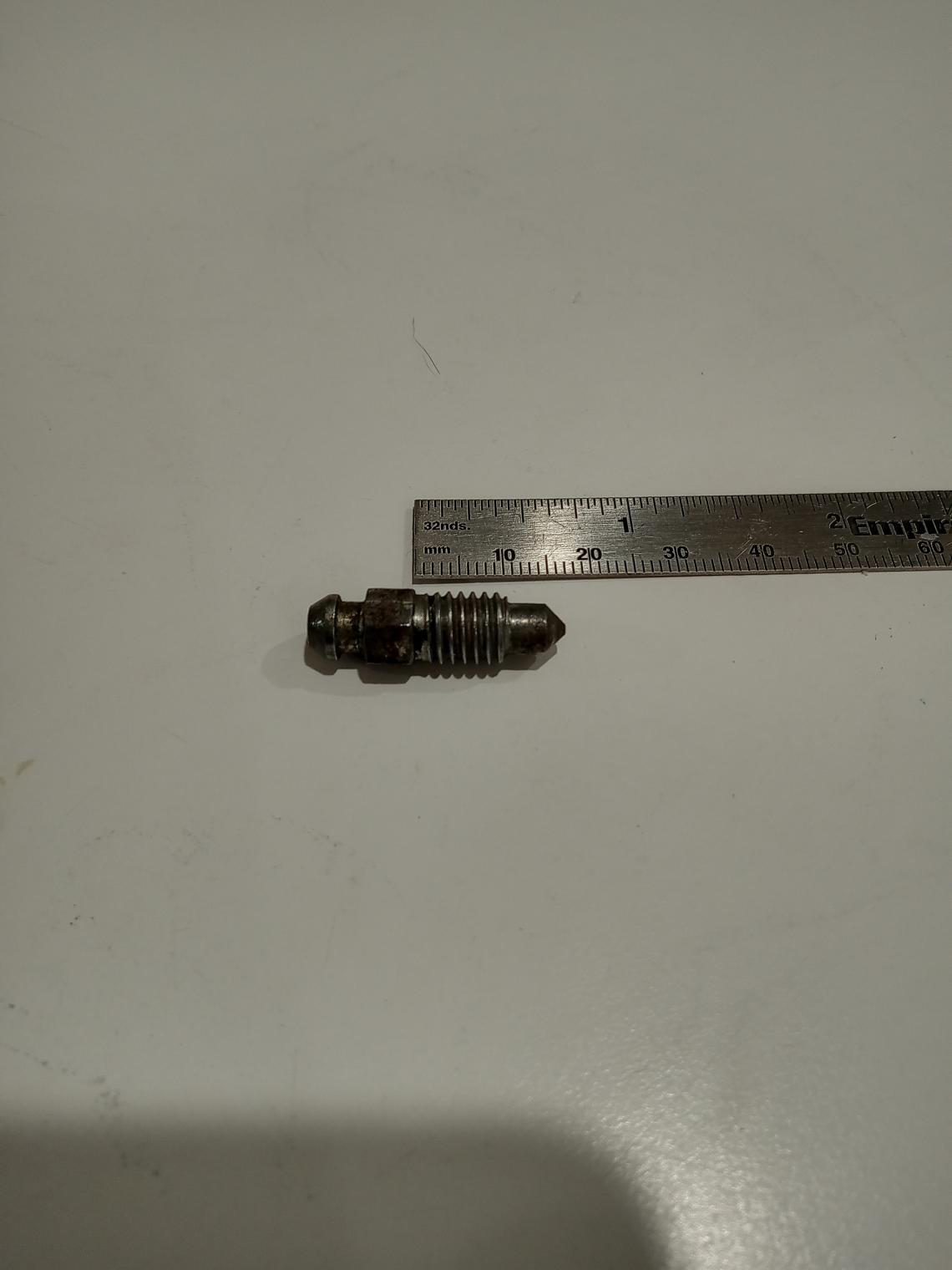

    Hi folks, I feel like should start my own club dedicated to my problems and questions. On that note, are any of you aware of a less expensive replacement for the ’79 Special brake caliper bleed screw? I know I buy a pair at Partzilla for $40, but I was wondering is there was an equivalence out there that could be used, say off another new bike model? The Part No is 1J3-W0048-00-00.
    • 8905
    One for an auto caliper is the same, I'll find the size for you shortly.
    I don't know if you have a NAPA store over there, maybe Canadian Tire should have them.
    It's M8X1.25

      Great! Yes we have NAPA auto parts up here. I’m sure the auto equivalent will be significantly less expensive than the one specifically listed for the XS. In the same way, I saw that the drain screws for the float bowls and O rings on my later carbs are being sold for $20 and as much as $70 each. I suspect that there are equivalents somewhere out there on other newer bikes that I could source. And take for example a post on this site that suggested to use a Toyota Camry thermostat gasket as a great alternative to the NOS gas cap gasket. I used it and it worked great with only $1.25 out of pocket. Anyways, thanks again Bikerphil. I look forward to your findings.

            Thanks Marty, now thta's a reasonable price. Just need to figure out which bleader size to grab?
            Oh...I just saw the Bikerphil did give the size in his last post.
