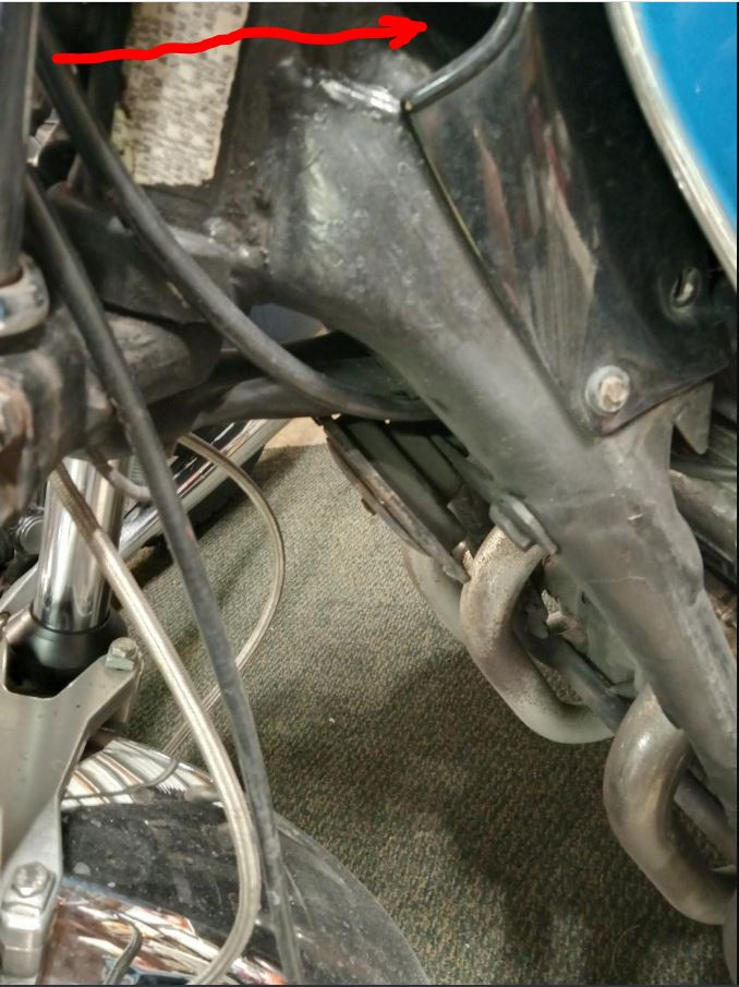

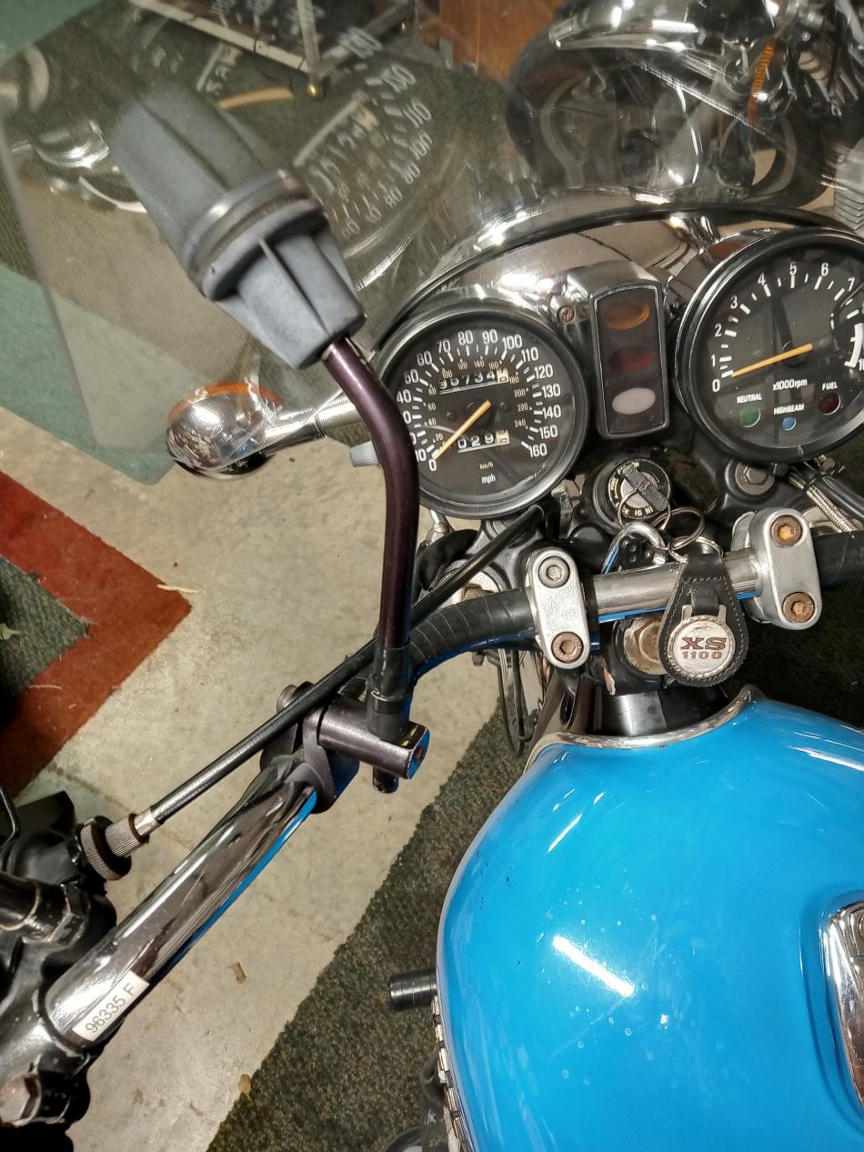

      • 8928
      Couple pics, 79 Special...

        "I see! I see!" said the carpenter as he picked up his hammer and saw. Thanks Bikerphil. Very helpful.
          • 8928
          Yep, the cable routing is subject to change depending on which style handlebars are on the bike.

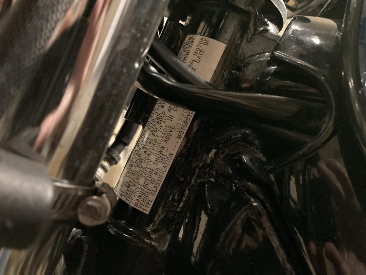

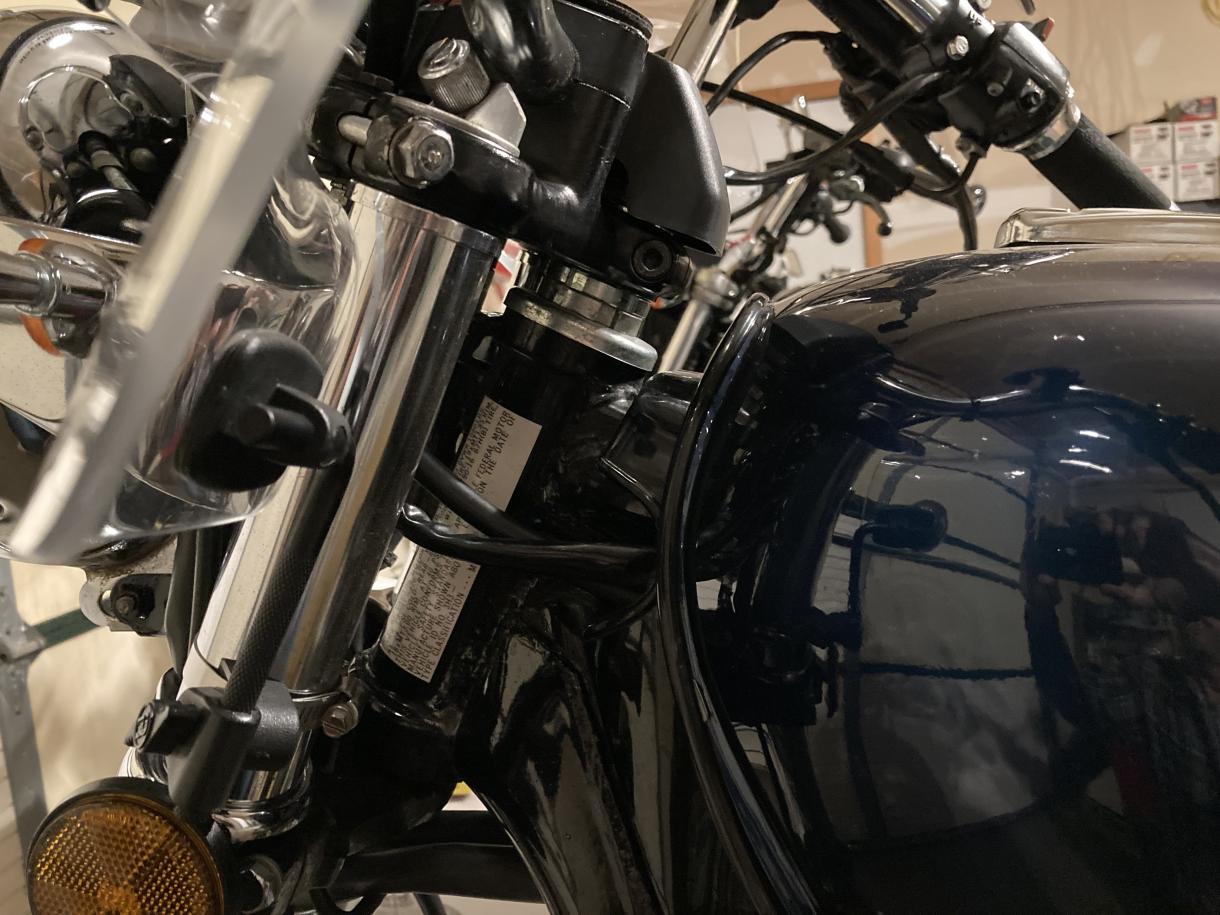

            • 2158
            My Specials (including the '79 SF) have the cable routed differently:
Name:	Clutch Cable.JPG
ID:	870907 Click image for larger version
            I didn't offer any pictures before because they were requested with the tank off.

              Thanks. This is great! Maybe I can turn right now!
