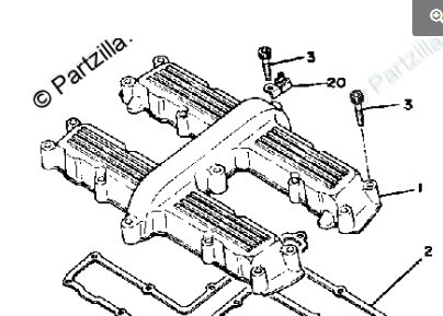

    Piecing together a 1980 xs1100 Special and wondering where these items go?
    The cable clip seems to belong on the cam cover somewhere, i've seen a diagram that shows it front and center but all I see on the bike there is the oil cooler, no cable to hold.
    And the two rubber bullets, yeah I've no clue :/

    2nd pic is where the throttle cable is routed. That what the part looks like.
      • 8083
      I don't recognize the rubber bullets. That clamp mounts with a valve cover bolt and the throttle cable goes through it as stated by oldyam80sg .

      It's #20 in the illustration.
