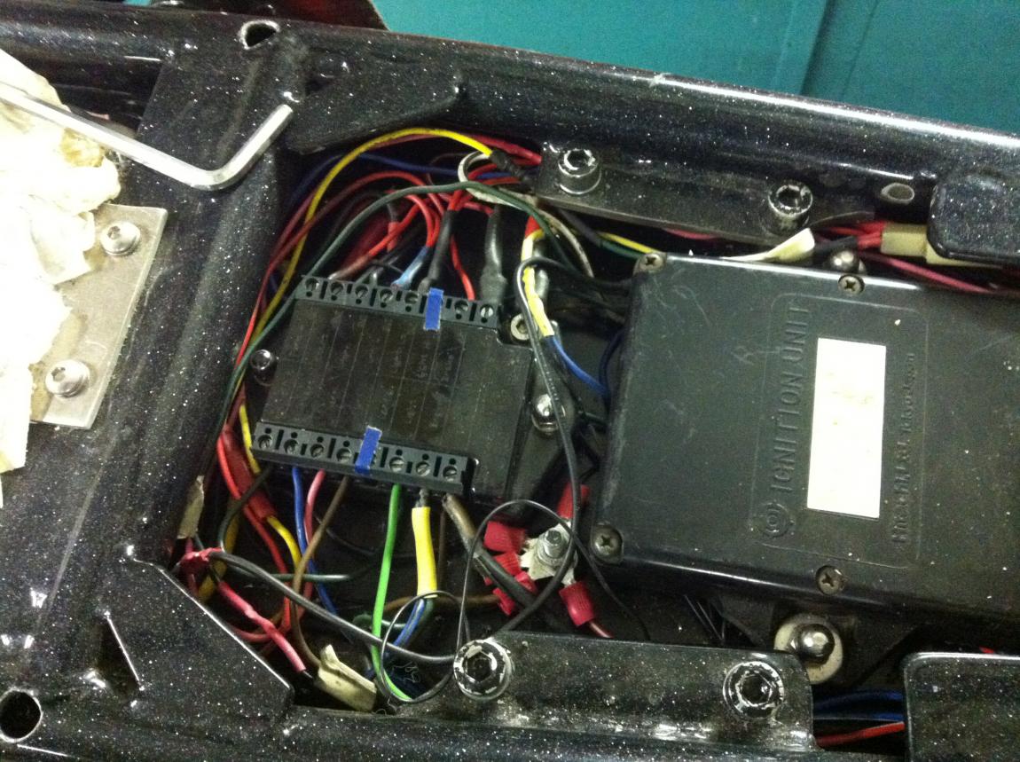

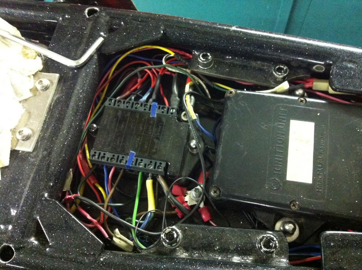

          Click image for larger version  Name:	IMG_4823.JPG Views:	46 Size:	169.9 KB ID:	865644 The M-unit I mounted on my friend's bike (5K7 Sport) years ago worked with negative pulses only. With that I mean making contact to earth and go back to neutral. Like a horn or starter button. Before I knew that I asked the manufacturer if the system would work with the stock handlebar controls, And he confirmed it would do so.. Well .. it did not.. For example light on/off, low beam, high beam, indicators or brake switches work by making a positive connection and keeping that connection open as long as needed. When testing it we got strange effects like a burning brake light with everything turned off. Seems the system we had could not cope with open connections, not even earh ones, it only accepts negative pulses. Once we knew that we had to change everything to single wiring and pulse switches glued into the electrical handlebar controls. After that everything worked fine. Keep in mind you still need your starter relais and the entire ignition and charging sytem stays separate. That was years ago, I do not know if there are new versions at the moment so you have to make sure exactly how it works and if you have to change your normal controls. When you get it working you will be rewarded with a couple of plusses like alarm, no fuse box needed, small wiring harness, less relais, incorporated programming like indicator time and so on. But make sure you get what you want.. Added is a picture of work in progress...
