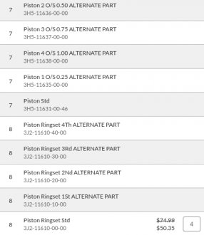

    I need to find out if this piston is a standard size piston. From the pics I see a 3H5 on top and a 3H500 on the bottom. I take it that the 00 of the 3H500 means 00 standard size, not any of the oversizes.

    According to the parts fiche, the ring part #'s kinda work that way, the pistons have their own part #s. You may want to measure them to be sure. According to the FSM, Standard piston size is 71.50MM and 1st oversize is 71.75MM and so on.
    Click image for larger version  Name:	PistonChart.png Views:	0 Size:	42.4 KB ID:	865550
      thank you for the piston size numbers Phil. I will measure the pistons.

          I measured the pistons and they are 71.5mmm which means they are standard bore. I found 4 new ring kits but by the time they are shipped to Canada from the US it will cost me $400 Canadian dollars.. jeez.
