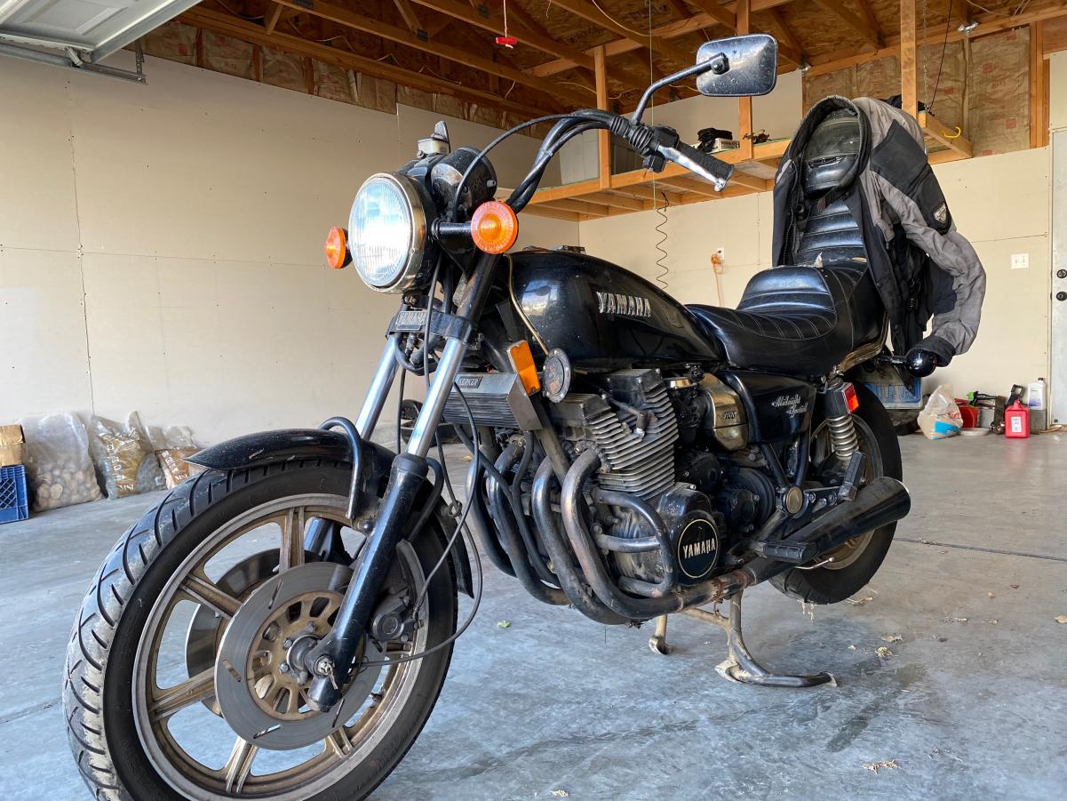

    Click image for larger version  Name:	IMG_1042.jpeg Views:	0 Size:	164.4 KB ID:	861974

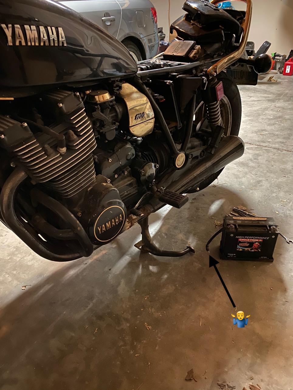

    For some background, the solenoid shorted out prior to storage, and I figure there's a short to track down. Pulling the battery out, the negative lead was snapped off at the connection to frame (on the neck to the fitting). Heh. I feel pretty good about tackling the electrics, but the front tire is currently not spinning. Prior to storage, it has always been really easy to push around. Initially the wheel did turn, but pulling it out of the storage unit and getting it on the trailer was very difficult:
    Click image for larger version  Name:	IMG_1032.jpeg Views:	0 Size:	150.5 KB ID:	861981 Click image for larger version  Name:	IMG_1033.jpeg Views:	0 Size:	172.2 KB ID:	861982

    As of today, I've got the bike up on the it's center stand. It occurs to me that if I could get it to sit on its back tire, it might make the front wheel and calipers easier to diagnose.
    Click image for larger version  Name:	IMG_1036.jpeg Views:	0 Size:	192.7 KB ID:	861979
    (You can see the slide marks from dragging it into place. After the 800 mile ride on the trailer, the front refused to spin at all.)
    Would a jack pushing up the front of the frame with a small foot in between the center pipes be a terrible idea, or is there a better technique and a particularly adequate tool?

    Place an automotive jack stand under the forward engine mount. You’ll need a strong helper to push down on the grab rail to raise the front end. Otherwise, you do that while your help places the jack stand.

        I used both a bottle jack and jack stand when working on my bikes front end. If you have a little money, go to harbor freight and buy the motorcycle lift!!! Best $300 I ever spent!

                      I see you have rafters in your shop, I would hang it by the frame with ratchet straps instead of jacking it.

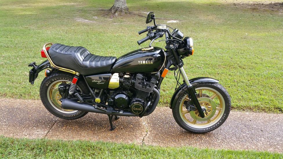

                              Hi Cajun31, great looking midnight! I also have 2 midnights and if you don't mind, I'd would like to hear your recommendation for gold wheel paint, as well as your black stainless brake line source. Thanks! Bob
                              Hey Bob, Here is my info on the gold paint. Mind you I have searched hi and lo for the Nebula paint and after many years trying I basically gave up. I went as far as buying a pristine NOS rotor so that I could take it with me to the paint store to have it scanned only to be told that there was not enough area for them to employ the scanner. I am hard headed though and wouldn't take that as the final answer. Of course I know the paint shop guys fairly well so they worked with me. They pulled all the placards they had out in gold and I took them all outside in the full sun and laid each one against my nice rotor until I found as close as match as the placards had to offer. I have been quite pleased with result on the color. It is a basecoat paint that I followed up with a satin finish clear. If you haven't already guessed I paint. Not for a living mind you but just something I picked up as a Corrosion Control Specialist while I was in the Air Force. I painted everything they had including jet fighters. Any how back to the paint. I have included pictures and hopefully you can get the formula off the can. It is a Chromabase product. Sticker shock might get you on the quart of paint. My guy didn't want to tell me the price until I wouldn't change my mind. The cheapest he could get for me was $230.00 for the quart. Yeah ... maybe it is cheaper at your paint store. The only reason I went with it was because I had several wheels and rotors to paint and loved the color. You decide but my bike pictures speak for themselves on how well it looks on the bike. My brake lines I bought over 8 years ago off of Ebay and I can't go back to who that vendor was. The lines are good though. My suggestion would be to go to XJ4ever.com.. I know from your gold plating ventures you are familiar with them. Not cheap but they actually build the lines to stock standards only the lines are stainless rather then rubber. The lines I have don't include the metal piping between the rear master and caliper. I understand the ones from Len do along with all the mounting rubbers front and back. I am looking at grabbing a few sets from him for all of my bike when my budget allows. My budget is the reason I cleaned my originals on my current project. Only so much budget to go around.
