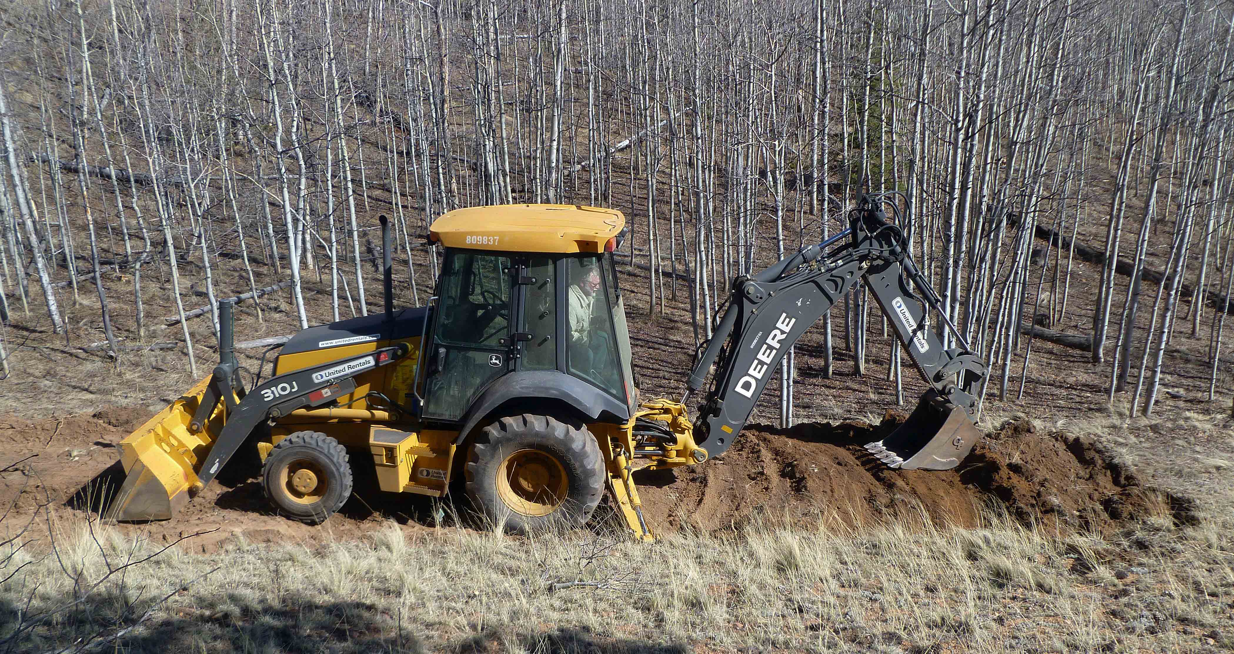

                    Yours truly operating a rented John Deere 310J backhoe earlier this year, putting a driveway in on my lot.
                    Photo by SWMBO.
