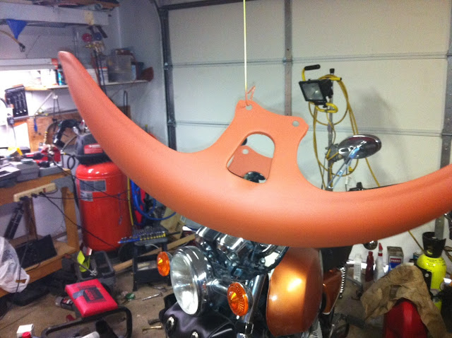

      Front fender off!
      OK I didn't take pics yet, but took front fender off and began process to primer and paint. Got first coat of primer on and waiting to sand for second coat.

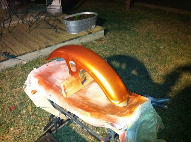

        OK - here is front fender getting primer and base coat.
        Striping comes tomorrow.

          Just a word of caution with regard to the clearcoating. Be very careful in clearing over another type paint system. Most rattle can paints are not very compatible with quality gun paints, and will craze, wrinkle, and fall off when hit with the clear. Sometimes clearing can still be done if done carefully with a good number of mist coats and ample flash times, but it is usually better to use one system all the way through.
          Just don't want to see your masking and painting effort go to waste the way I have seen a number of my projects go...

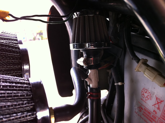

            with regards to the vent hoses,
            the 2 coming from the carbs are vented to the
            atmosphere, dont block these off.
            and the engine breather is also vented, some put
            a small filter on there to prevent anything
            crawling inside.

              thanks petejw - I will keep the pics coming as I progress.. I put a minipod filter up there under the seat...

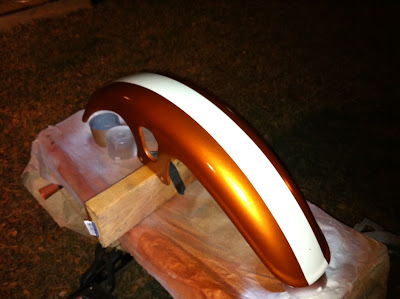

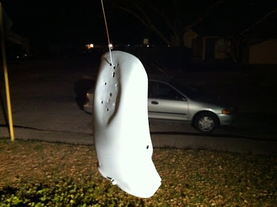

                A little closer today....
                I started on the rear fender today because my taillight came in the mail and I was excited....
                As you can see with it primered, there is a section I had to hammer in from the outward curve to be kind of flat to accept a flat light. It is shaped to the light and wholly contained under the rubber gasket which will be evident once mounted.
                Here we are back to the front fender taped and masked for striping. That low tack tape can be a problem though as it lifted ever so slightly in one tiny area and left a hint of overspray that I removed with wet sanding.
                This is my secret to timing between coats - the time it takes to finish one and the next coat is ready...
                Adding clear after unmasking stripe - I briefly considered a more complicated stripe, but my taping skills are not good enough. This was tough enough and took an hour to get centered and even along the length and used a big wad of pulled off tape

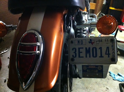

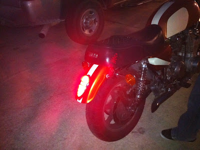

                      Today felt really good - after work I tackled wiring up the new LED light - 1938 Lincoln Zephyr style from Technostalgia.
                      Here it is on - soo bright! (and it pulses)
                      I turned it off to take this pic due to overexposure...
                      Here it is from right rear quarter view...
                      Right front...

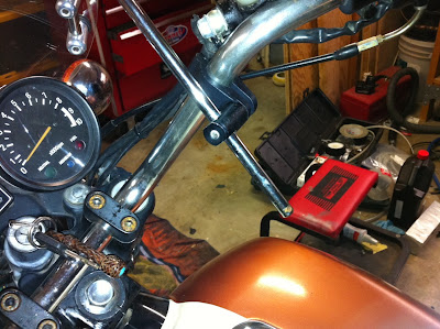

                      Here the new windshield is in place now that the clamps arrived. The bars stick out about 3" once adjusted - should I cut these off???
                      Here I added a new license holder from twisted bar stock - small led to be wired tomorrow to illuminate.

                        I would cut the mount bars off once you are sure you have it where you want it. I would also check to see if its legal to mount the plate on the side like that. Some places it HAS to be on the back, others don't care as long as it is still properly oriented.
                        Looks good though!

                          shes come up a treat john,
                          i like the clean look of the rear end,
                          the tail like looks sweet, wish i could do
                          something similar to my sport but have no
                          where to put the blinkers.
                          as nate said, id cut the bars off once ur happy
                          with the position of the shield.

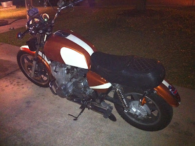

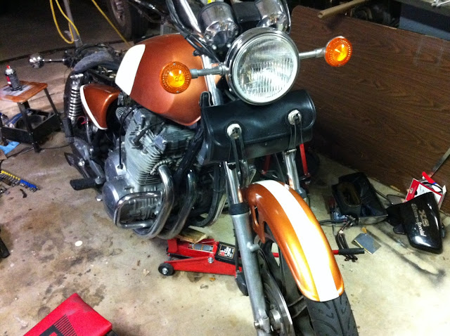

                              Today went for a half tank ride - overcast and slightly chilly above 80 mph but nice feeling with small shield in place - no more fighting against the wind so much....
                              I was having slight wisps of smoke coming from under seat breather minipod - the crankcase positive pressure pushing it out...
                              Sooooooo... I drilled the #2 pod and added a 1/8" threaded nipple to Tee into the crankcase line.
                              And the new Tkat brace came so I installed it - truly remarkable fit and on in 5 minutes start to finish.
                              And in daylight the license relocation...
                              I cut off the windshield bars (thanks nate) and added a couple rubber caps to end to give it a finished look.
                              I might need to rejet since even though its running better than before it is lean with the pods being so unrestricted - my pipes blued after the ride today for first time in 30 years ...
