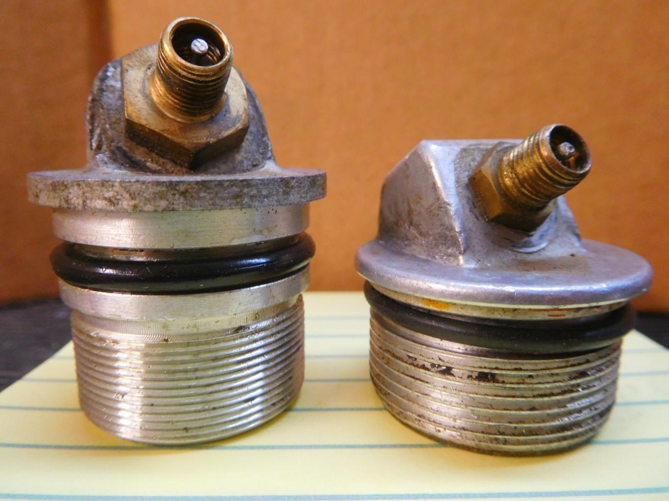

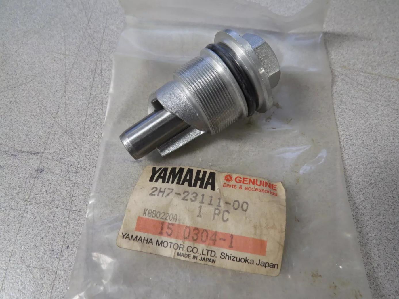

        Raising the bike's front end will take most of the preload off the springs but not all. The air forks are much softer because they use air for pre-load. You can remove them with a larger Crescent wrench but re-installing them may prove to be difficult. Pushing down with your fingers and finding the threads can be tough. You need to be very strong and dexterous. Or just be safe and remove the forks to work on them.

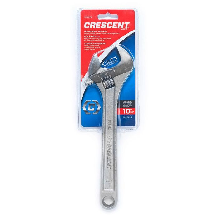

          Brilliant, not sure which type I have until I get them off, but looking at the photos the one on the right looks very similar to mine, I will follow advice and remove them. I have an adjustable "crescent" spanner that will fit . Really appreciate your help. Cheers
