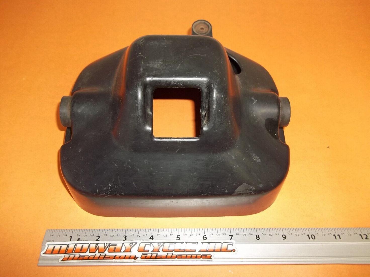

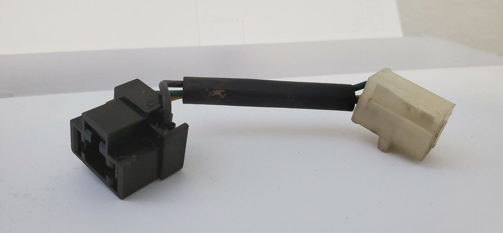

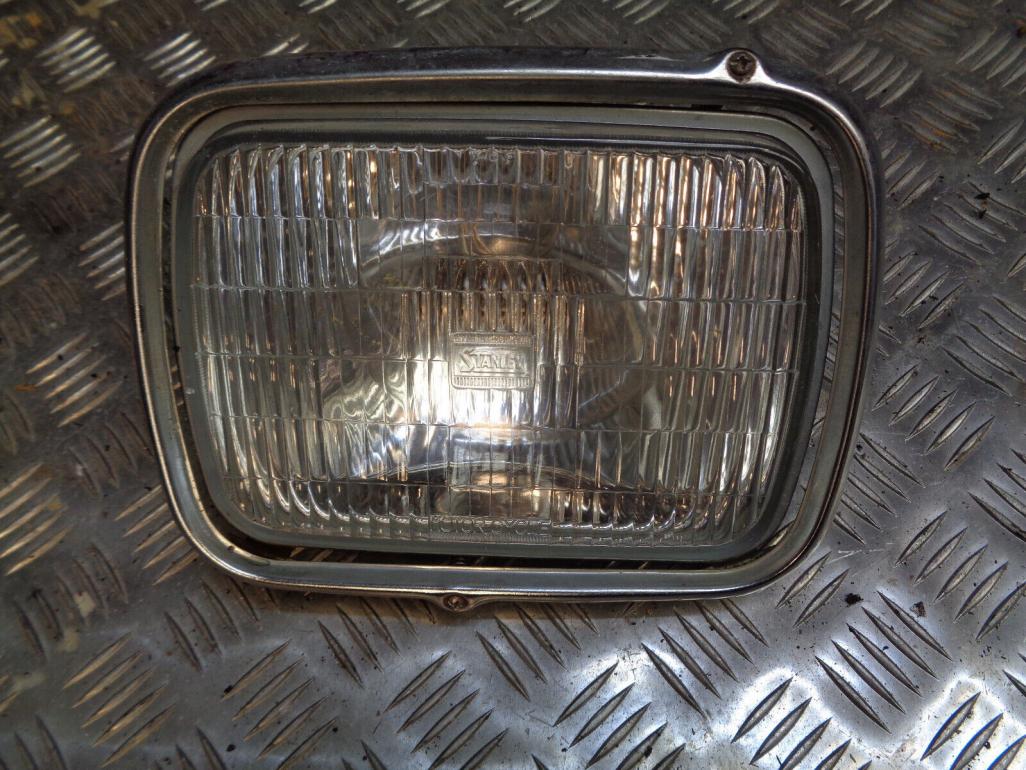

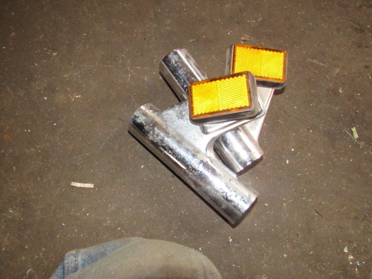

              • 2053
              Here are some parts needed to go back to stock:
ID:	873923 Click image for larger version
ID:	873924 Click image for larger version
ID:	873925 Click image for larger version

                [QUOTE=HouL;n873919
                The fairing is certainly nice but I want to be able to remove it easily for if I decide to go on faster/longer rides. I have a 76 CB750 ive taken on some longer rides and the wind doesnt bother me tooooo much, but just having the option of quick removal would be nice.
                Hi HouL. Last time I removed the fairing (15yrs ago) from my 79 F, it was a chore. Hope someone more versed can add some info on the process. Its definitely not a quick take on and off as it is very securely mounted to the frame.
                Besides you have to swap out a lot of parts every time. Make sure you understand and accept all that is involved before you go spending any money on it.
                Hope you enjoy your rides with or without the fairing.
