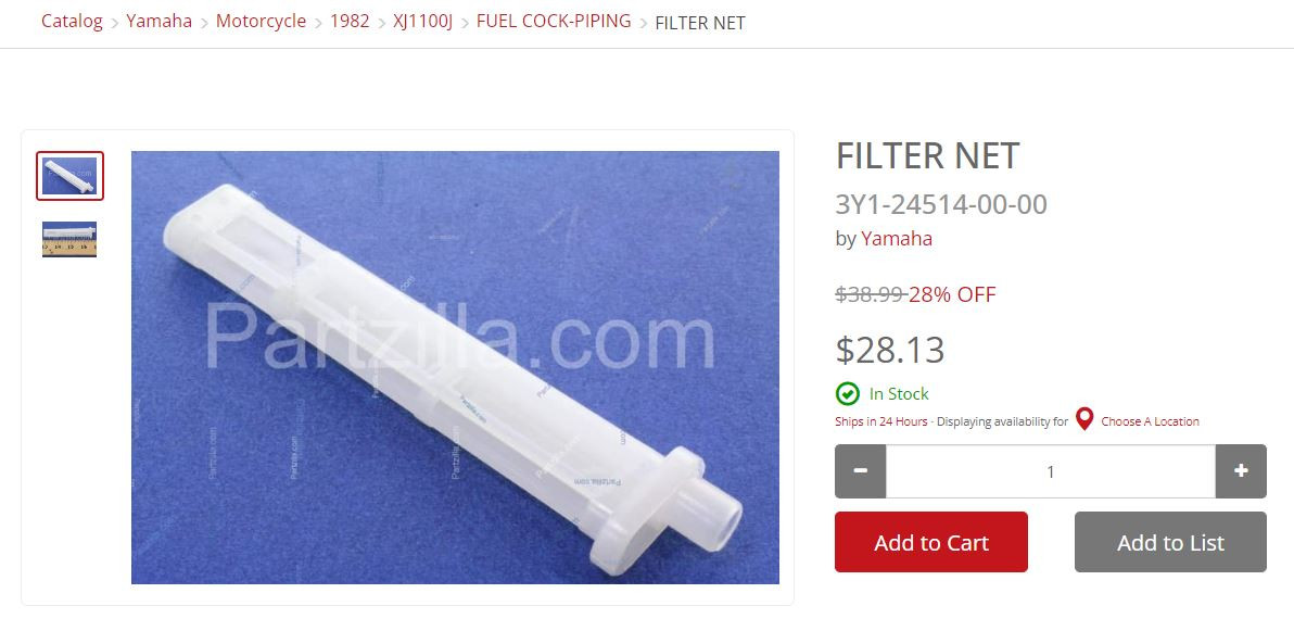

    Do you have the filters that press fit into that petcock....the plastic filters that stick up into the gas tank?
    They have a pipe that press fits into one of the holes to isolate it from the other hole:

        Thanks for this. Yes Radioguy I have these. It appears that the corrosion is far enough into the body that there is a place where the filtre, though fitting snuggly, is not actually seating.
