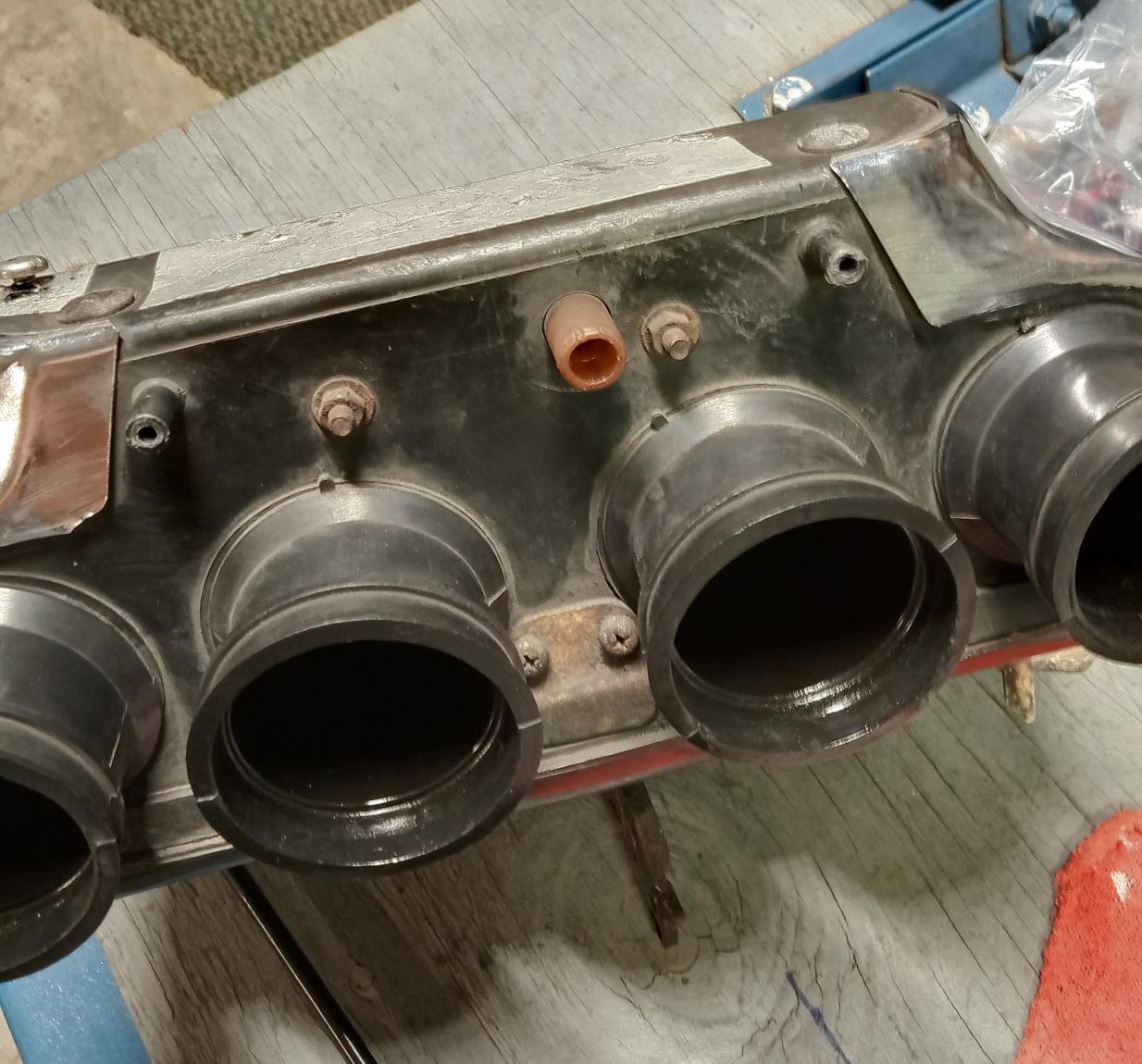

        bikerphil... Thankx for sharing, mine Airbox is a little different than Yours
        attached picture shows the difference.

          bikerphil...
          seems i misread Your post, but the Inlets on the Airbox are larger than the Hose on My Vents
            • 8917
            Yep, yours is the 78-79 airbox.
            The upper T-s on the carbs and the air box nipples should both be the same size.
            The 1/4" Tygon line works great for the vent lines and the regular fuel lines....
