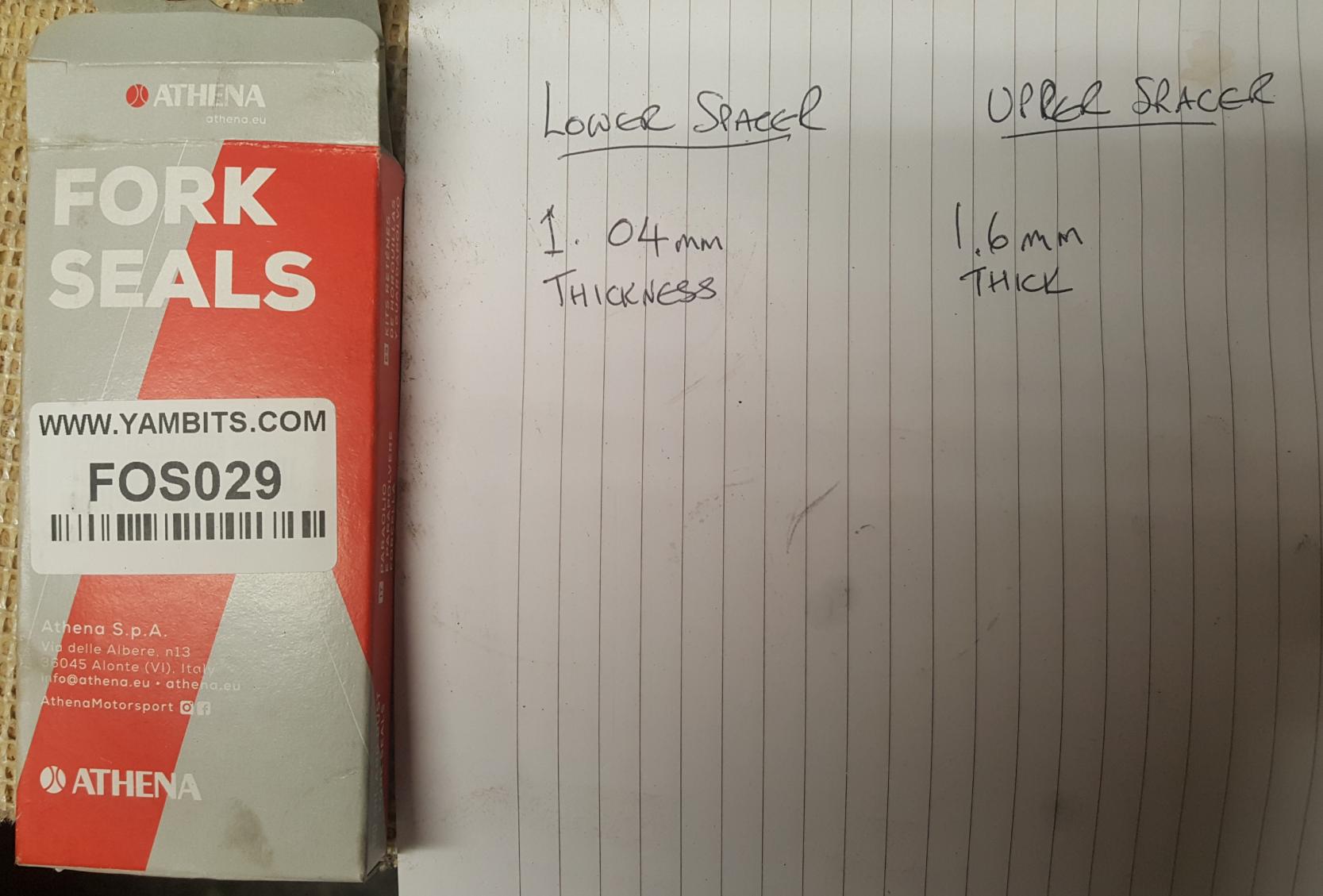

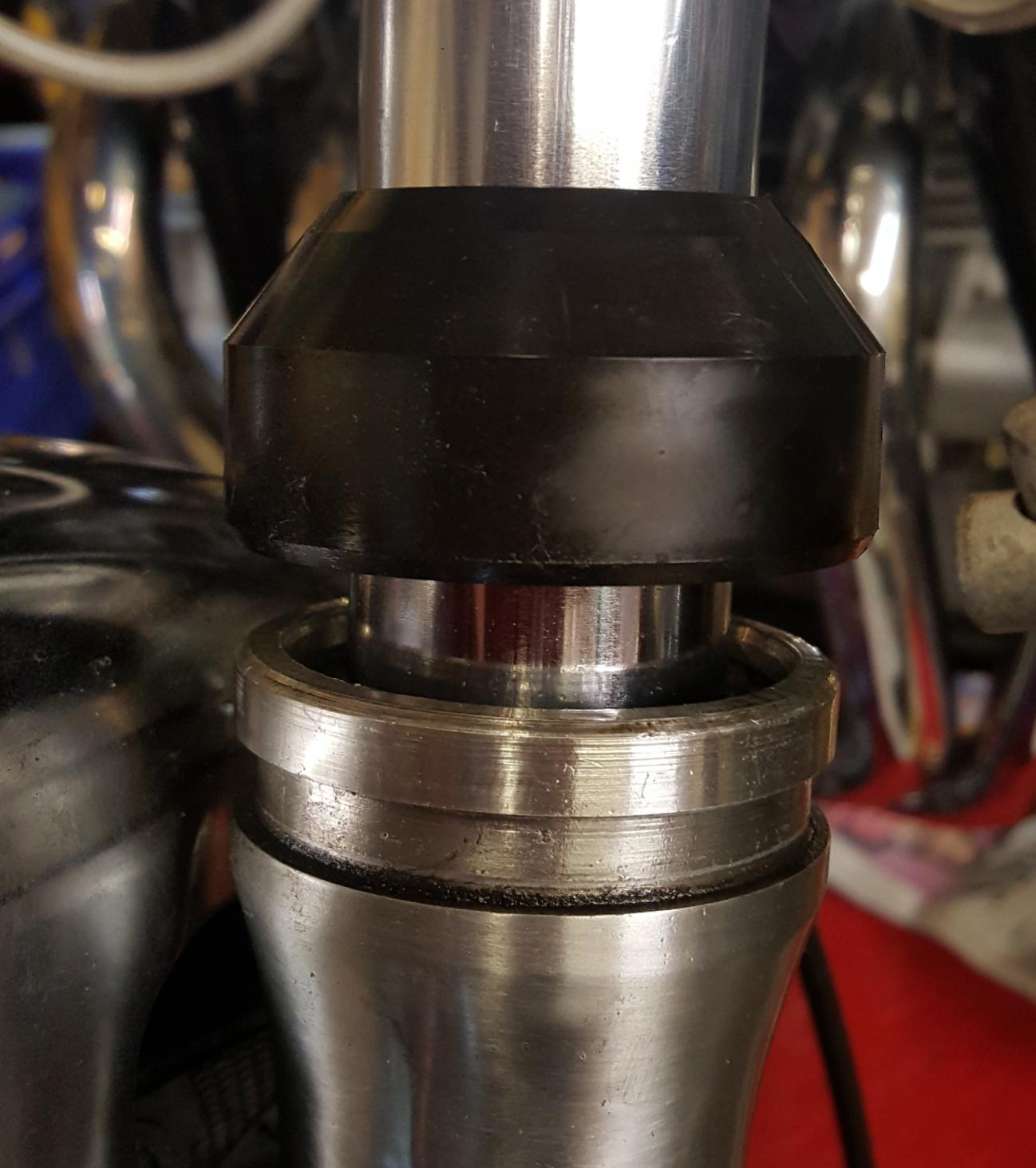

                    The fork seals from Yambits are perfect - double lip design for the air-assisted forks (37 X 48 X 10.5 mm) . Fitted with thinner lower spacer and thicker upper, spring clips seats perfectly.
                    WRT Dust seals Yam Part no. 10M2314400 .... I've had no luck with cruzinimage.net - I tried to order but kept getting told my email address was wrong!
                    I've found 1x NOS on ebay UK (£15 with shipping) awaiting arrival.
