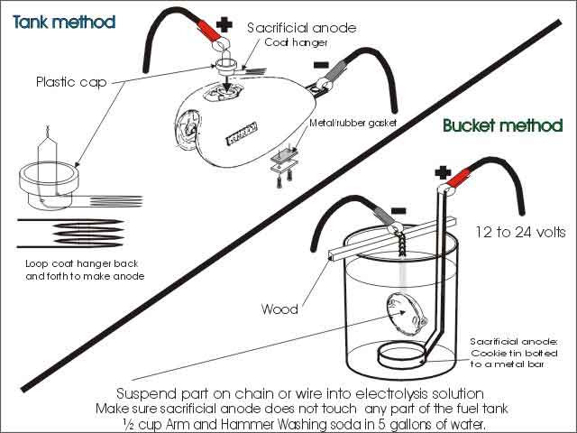

    I set the tank on a piece of carpet and blocked it up to get it as level as possible. I then filled the tank with the washing soda solution. Then I took a coat hanger and fashioned the sacrificial anode. You say what???? Ok this is the trickiest part of the procedure. (Check out Clay's photos or my illustration)
    For my project I found a nice little plastic cap and drilled two 1/8" holes in it about 1" apart. I then took the coat hanger and bent it over and over until I had four loops on one end that spread about 1" when grouped together (Fig. 1).

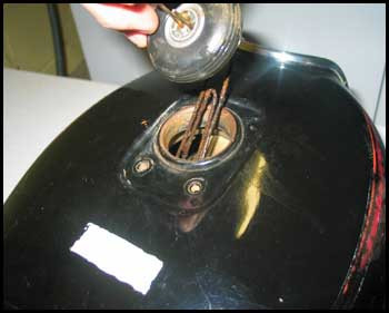

    Think about the business end of a fork that you eat with, that's what it should look like. Then about 4" back from the business end of the fork make a 90-degree bend in the two wires and run them up through the plastic cap. Put the sacrificial anode into the tank and spin it around to insure the anode is not hitting anywhere on the tank (no short circuits) (Fig.2).

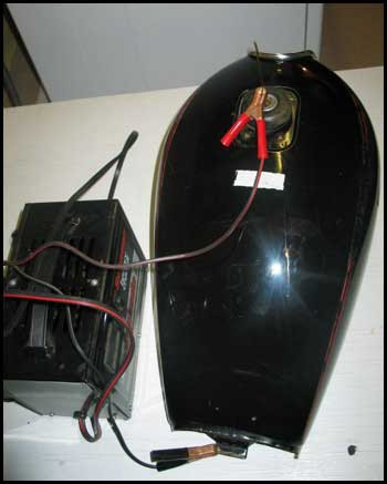

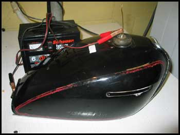

    Then using a 12-volt battery charger hook the positive lead to the sacrificial anode and the negative lead to the fuel tank . I used the mounting flange that sits under the seat (see figs 3 and 4 below). Let the fuel tank cook for several days. Mine took three days. I pulled the anode twice a day and cleaned it with a wire brush. I have a small battery charger so it may take less time with a larger charger. Once you have determined all of the rust in gone in the fuel tank, dump the electrolysis solution into a plastic bucket and save it. You can use it over and over again. I alway make about 5 gallons at a time and just add water as it evaporates out.

    Rusty parts may also be cleaned this way by suspending them in a bucket
    (Fig. 5).
