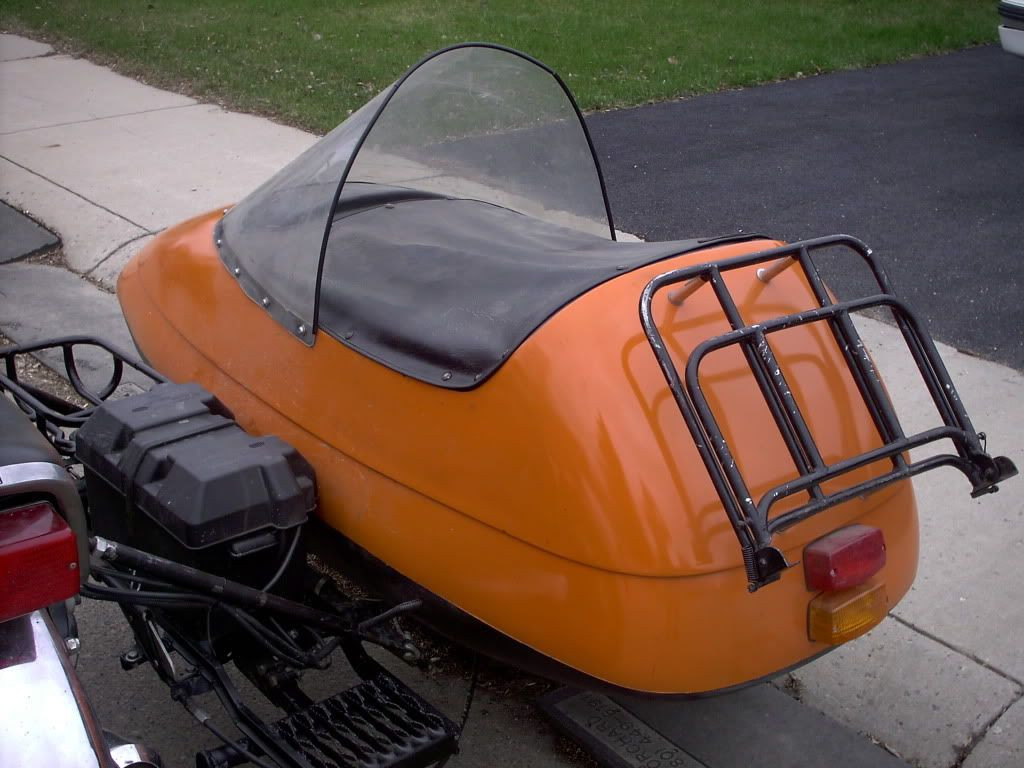

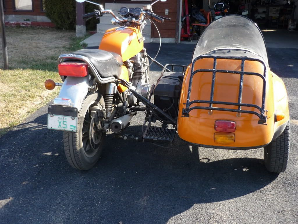

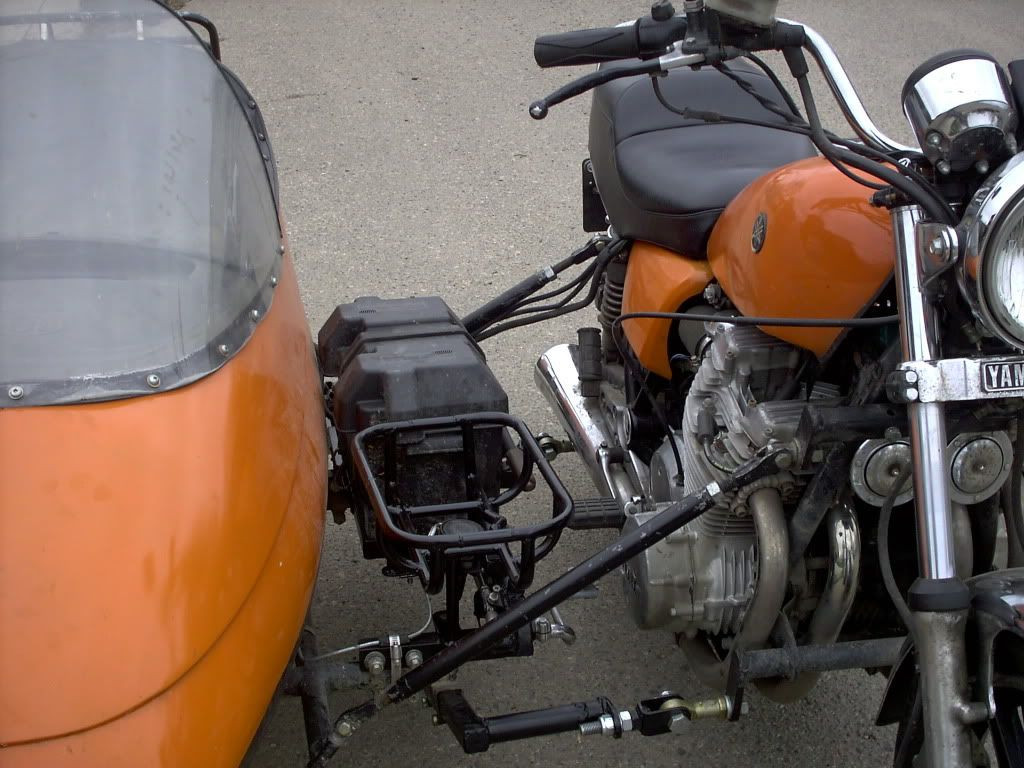

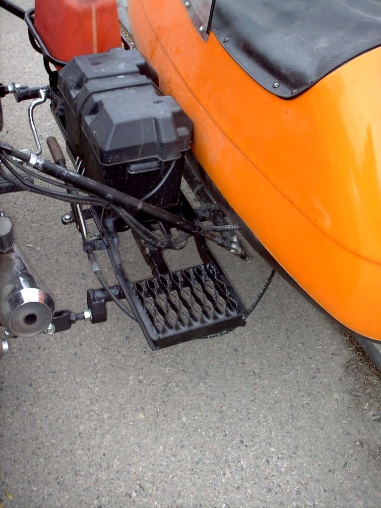

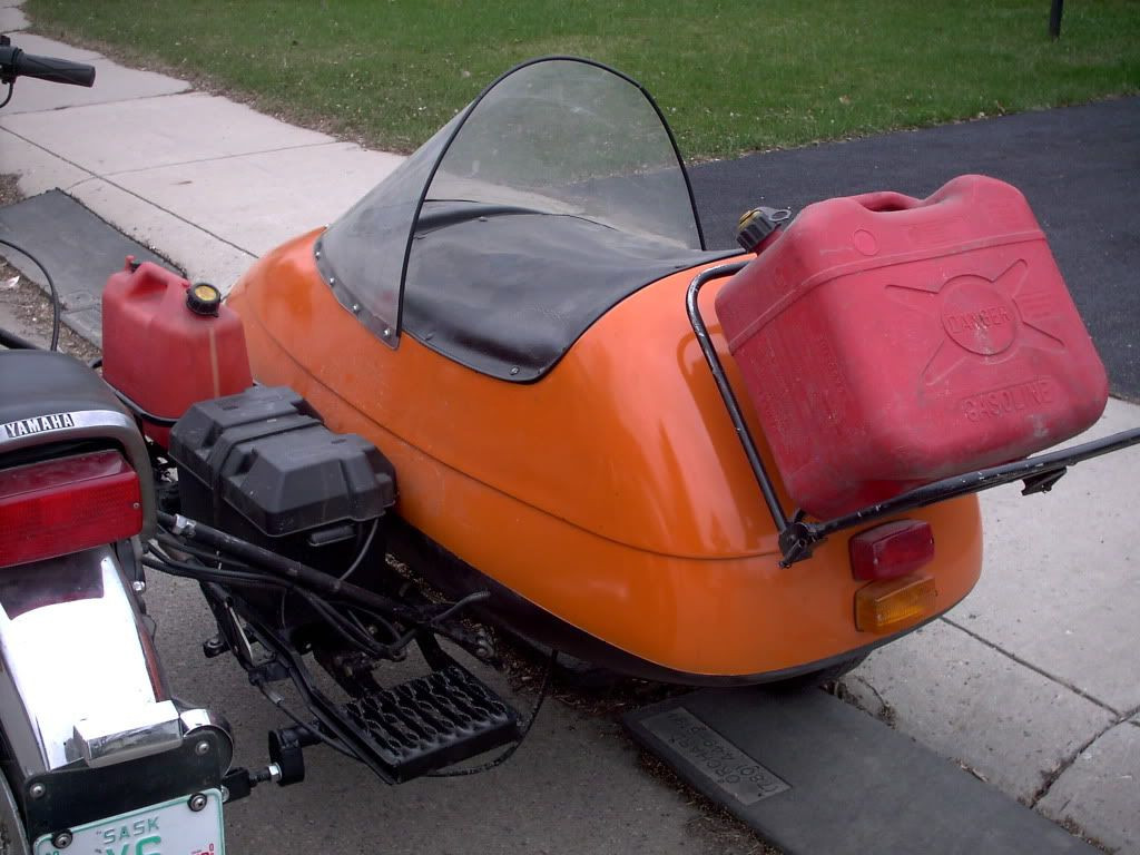

          Fred - What're the things that look like a parking brake handle and foot pedal mounted to the bike-side of the black box in the center of the space between the bike and the sidecar? Right along the 10 o'clock position in this picture:
          1980 XS850SG - Sold
          -H. Ford
          • fredintoon
            • Mar 2004
            • 6795
            • Saskatoon SK
            Fred - What're the things that look like a parking brake handle and foot pedal mounted to the bike-side of the black box in the center of the space between the bike and the sidecar? - - -
            Hi 'Bug,
            they are exactly that.
            The sidecar's wheel & hub were salvaged from the back of an early Honda Civic.
            The backwards-mounted XS650 pedal and m/c works the s/c's ex-Honda drum brake.
            The salvaged Toyota parking brake handle & cable works the mechanical parking brake mechanism in the Honda hydraulic drum brake.
            The black box is a Canadian Tire marine battery cover that keeps the rain (and dropped wrenches) off the 550CCA car battery that'll take you 100 miles after your alternator dies and a fair distance further if you unplug the headlight.
