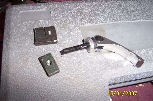

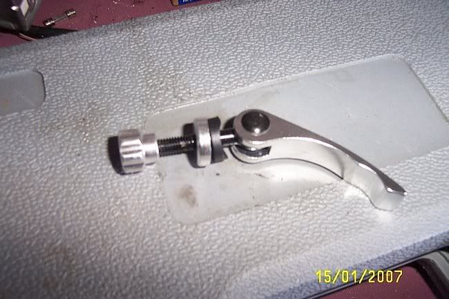

    Went down the the pushbike shop and picked up 2 of these quick release bolts.
    Nuts were know good so I found a piece of steel and drilled and tapped some threads into them to act as new nuts. (Aluminium would possibly be better) Steel was the perfect width to prevent internal turning. The shorter the better to allow more sliding movement.

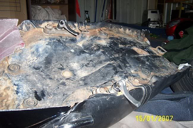

    Then it was fit to my spare bike to measure and cut off the XS (excess) bolt length. I used a few spacers to keep it out in the open for final pics, but it could be used without to conceal the catches better. A little extra length to start with doesn't hurt.
    Refitted the brackets to the seat. Note: they are only small bolts so if yours are rusty be VERY careful removing them.

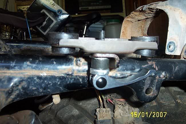

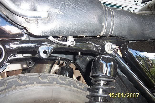

    Nothing left now but to fit to the bike.
    I think it looks good and will be much better. Can finally put some tools in the toolbox without carrying a spanner in my pocket.
