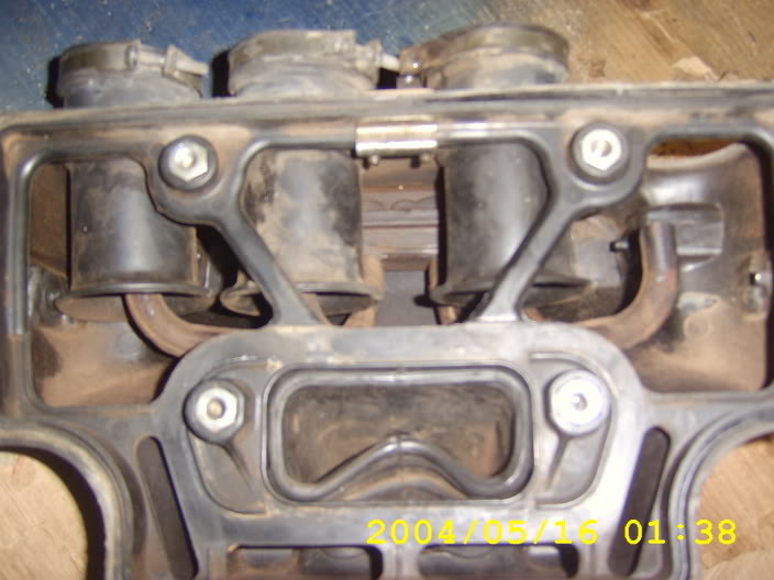

    Here is what I came up with. Took a spare airbox and removed the tubes:

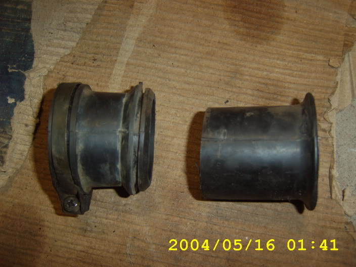

    I cut the tubes just aft of the retaining groove:

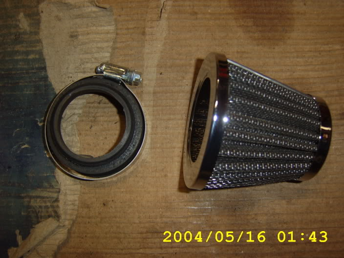

    Removed the rubber insert from the pod filters:

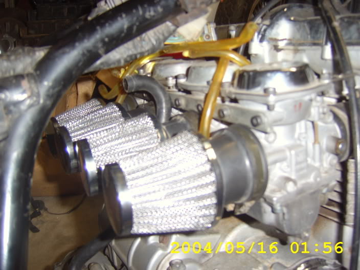

    Crammed the tube into the pod filter. It is a chore, but it will go. Much more snug than the rubber insert included with the filter.
    Noticeable difference in power. Nothing earth shattering, but there is a boost. This will likely lean out the mixture, so a rejet with bigger jets will probably be needed. I also found a breather filter that looks similar to these at Oreilley's, for about $10. Not bad for less than $50
