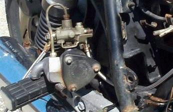

    The XJ11 has a dual braking system. Right hand grip activates the right front caliper. Foot pedal activates the rear caliper and the left front caliper. The rear master cylinder (m/c) has a proportioning valve sticking out the back (see Photo 1).

    Photo 1
    Two brake lines are attached to the valve, one for the rear and one for the front.

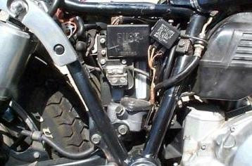

    Rubber hose to hard line fitting under the right side cover (See Photo 3 right upper quarter).

    Photo 3

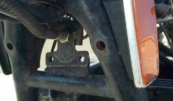

    Hard line along the frame under the gas tank. Hard line to rubber connection just under the stearing head on the frame (See Photo 4).

    Photo 4

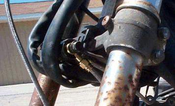

    Chris and I have replaced these with a single S/S line, that will route the same as the original. The end of the three piece run connects to the left caliper line under the chrome trim piece on the forks below the headlight (See Photo 5).

    Photo 5

    Take out the banjo bolts on the left front caliper, the connector under the head light. Take out the bolts holding the mounting plate on the frame under the steering head. (See Photo 4, again) Remove the slip clip holding the hard line to rubber connector. Leave the hard line setup in place for now. At the right side of the bike, spread the clip apart the holds the rubber/hardline connector. Disconnect the rubber line. Remove the screw on the clip that holds the rubber line going to the rear caliper. Spread the clip behind the shock that holds the rear brake line. Remove the banjo bolt at the rear caliper.

    The rear m/c sits between two vertical frame members. Route the front (the longest one) s/s line on the outside of the front frame tube and inside the rear one (See Photo 1). Connect, but do not tighten it to the valve. Connect, but do not tighten the rear caliper hose to the valve. It should look just like Photo 1.

    Route the s/s line to the front, following the hard line. Cut the hardline wraps and install new ones for the s/s line. When you get the line to the welded bracket piece under the steering head, creativity comes into play. I haven't set up a fixed replacement for the other half of the bracket. The line should be attached in this area of the frame so it doesn't flap and chafe. Home made rubber bushings (slit rubber hose), wire ties, a u-clamp - here you are on your own, until someone comes up with a complete reproduceable solution. The fitting end of the line attached and under the headlight where it joins the line to the left caliper.
    Replace the left front caliper line, torque the banjo bolt to 19 ft/lbs. Join the caliper line with the line from the rear m/c at the connector under the headlight, torque the bolt. Bleed both the front and rear calipers together.
