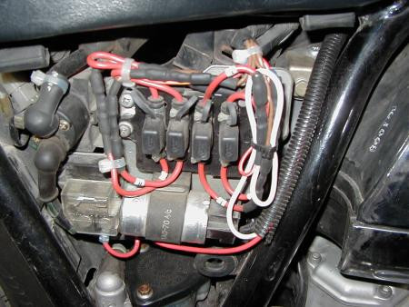

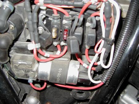

    This next one is the one I redid on my 80, again the old block was flipped over and the holders are held on with little zip ties. On this one I used waterproof mini fuse holders. These take the very small modern type fuses. First picture shows all holders closed, next ones shows two holders open to reveal fuses.

    I never use solder unless there is no other choice, it weakens the wire and makes it more prone to breakage. I use Amp knife connectors on all my wire splices, crimped with an Amp crimper these connections are guaranteed for life.

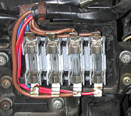

    Here's Mike Hart's fuse block replacement:
    Okay, okay, what can I say, I'm retro, using glass fuses. Besides, I like those slidey-top metal containers they come in.

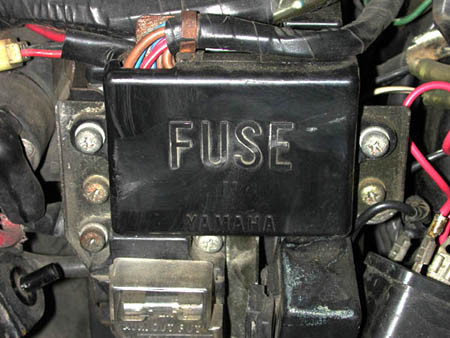

    I did this same 'upgrade' on 3 other XS's. Note, I did this six or more years ago, and it all looks like new (pics from 8/9/02). I like that it's like stock (only better) and fits under the stock Fuse panel cover.
    Installation cost was under $4 for a 4-position glass fuse holder from Schuck's (Kragens, etc).
    I had to dremel off some rib-like material from the back of the fuse holder to get a good mate to the stock parts and allow the cover to fit.
    It fits behind the stock fuse panel cover:

    Note the plastic 'channels' that protect the fuse clips from flexing too far. The clips are way beefier than the stock 'dried cake frosting' ones:
    I soldered the wires, as there is no flex in this application.
