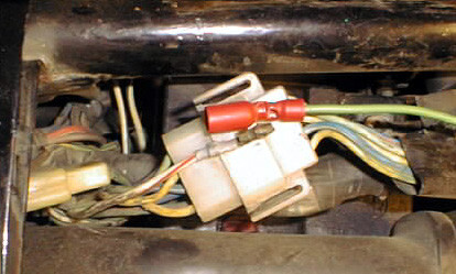

    Identify battery sensor wire
    Begin by identifying the battery sensor wire. On my '82 Yamaha XJ, the battery sensor wire is white with a red stripe, and is near the main wiring harness connection under the seat. As you can see, it has a male connector.
    Green wire in this photo runs to one end of my resistor. It requires a female connector.

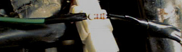

    Resistor Wiring
    Cut a length of wire long enough to reach between the battery sensor wire and your power source. Cut the wire into two pieces, and install the resistor. I soldered the resistor ends to the wire ends, then covered them with electrical tape for insulation.
    Heat shrink tubing would make a neater job, but use what you have.

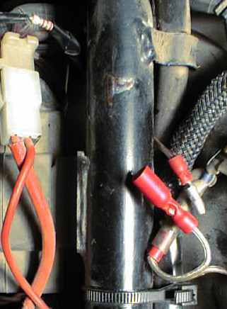

    Power Connection
    I made up a "Y" cable and used the tail light connection, located under the seat and just behind the battery, to supply the power to the resistor.
    Resistor wiring is run under the frame; note the resistor (with stripes) at top left of photo. If you follow the wiring, it comes out at the male bullet connector shown at the right side of the photo.

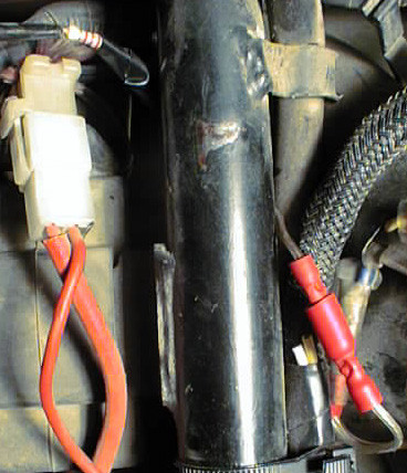

    Plugged in Connectors
    Battery sensor wire plugged into resistor loop.

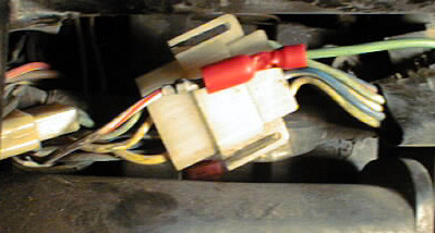

    Other end of resistor loop plugged into tail light wiring through "Y" cable.
