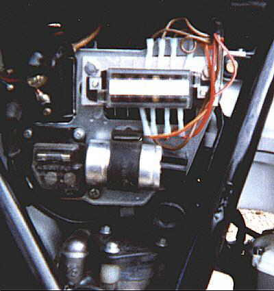

    The XS11's fuse block is a notoriously weak point of an otherwise fine motorcycle. So I decided to replace my fuse block. It looks and works great and fits in the same place as the original fuse block while giving you two additional fuse connections.

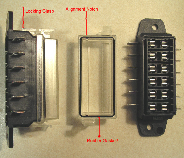

    The place to buy an Auxiliary Fuse Block is J.C. Whitney. (Part No. 03dh7115w). It costs about $24.95 + shipping and uses spade type automotive fuses. Don't get any of the other fuse blocks from JCW because they won't work for our application. This is the only one they sell which has independent in and out leads. All the others have one input and multiple outputs. Great if you're adding a ton of accessories but inappropriate as a replacement for our fuse block.

    1. Unscrew the bolts which hold the plastic fuse block in place. Leave all the wires in place in the old fuse block at this time.
    2. Take the aluminum backing plate and trace the holes from the original fuse block onto the plate.
    3. Now trace the holes from the new fuse block onto the aluminum backing plate. Make sure the holes aren't too close to allow clearance for the mounting bolts.
    4. Drill holes in backing plate.
    5. Using a new razor blade and a delicate touch, cut back the wrapping on the wiring harness about 2 inches. This will give you more of the wires to work with.
    6. Take a roll of masking tape and make little marker flags for each wire coming into the old fuse box. Make sure the flags are about 3/4 inch above the connector. Label each pair of wires (Ignition, Headlight, etc.) so that you don't screw up the connections.
    7. Carefully remove the wires from the old fuse box. I used a small screwdriver to release the old fuse holders from the plastic box.
    8. With wire cutters, cut off the old fuse holders as close to the crimped connection as possible.
    9. Strip off about 1/4 inch of the insulation and crimp on one of the female spade connectors for each wire. (I know that Doug likes soldering these connections and that's fine but it's kinda hard to work with wires which are so close to the bike.) Using Vice-Grips to crimp these connectors has worked much better for me than the special crimp tools they sell for that job.
    10. Don't use the sheet metal screws that come with the new fuse block. Instead, use appropriate sized bolts to attach it to the backing plate. I chose to have the heads of the bolts on the back side of the backing plate to make sure the extra length of the bolt doesn't dig into the frame plate.
    11. Use the rubber grommets on the bolts on the back side of the bolts which attach the backing plate to the frame plate to make sure that the assembly mounts securely.
    12. Attach the wires to the connectors. I found that having the wires come around the right side of the fuse block (instead of having the wires come around the left side in the stock fuse block) puts less stress on the wires. I did have to change the order of the fuses and wires because one pair of wires seemed a little short to provide a stress free connection.
    13. I used a drawing program to create a label to attach inside the clear plastic cover. I glued it in by "painting" the front side of the label with white glue and putting it in the inside of the plastic cover. (don't worry that you can't read it right now - when it dries it will be clear.) make sure you glue it in right side up as the cover will only go on one way.
    14. Plug in the appropriate fuses and place the clear cover over the fuse block. (You can remove the masking tape flags if you'd like to make it look prettier.)

    Here's a better picture of this thing:
    Click image for larger version  Name:	fuseblock_dc.jpg Views:	0 Size:	125.0 KB ID:	861580
