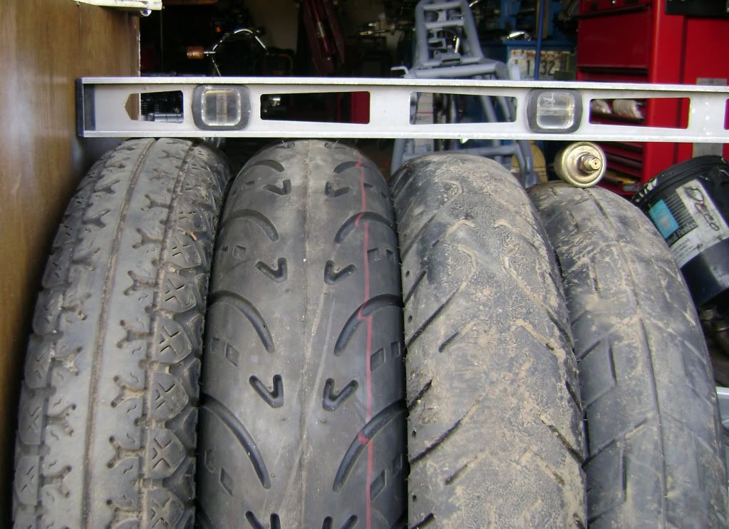

    The OEM tires fitted to these bikes were load rated at 420 lbs front, 670 lbs rear. Compared to modern tires, these numbers are rather low today for correctly-sized replacements. Also check aspect ratio; a lower-profile tire in the 'same' size will have a lower load rating, i.e. a 130/80-17 tire will carry less weight than a 130/90-17. The main thing to think about here is don't go less than the stock numbers; you will be compromising your safety! Another thing is the newer metric sizes tend to be smaller than the old inch sizes, even the 'equivalent' sizes; below is a pic showing the size differences in the various correctly-sized rear tires offered since these bike were new.

    Left to right, you have: a 4.50H-17, a new 160/80-16 (more on that later), a 130/90-17, and a 130/90-16. Now, the 4.50 has about 60% tread left (but is over 25 years old!), and the two 130s are pretty much worn out. But even if the latter two were new, that would increase their diameter by less than 1/2". As shown, there's nearly 1" difference between the 4.50 and the 130/90-17, and almost 2" between the 4.50 and the 16" tire. That's a lot in terms of circumference, and will make a noticable difference in engine RPM on the highway. The smaller tire will also wear faster, all else being equal.

    The 160/80-16 shown above? As you can see, this is pretty close to the same size as the OEM 'standard' tire (about 3/8" smaller if the 4.50 was new), so that's my choice for a rear on one of mine. But this needs fairly extensive mods to the swingarm to make it fit due to it's greater width (6.15") so it's not an easy install.
