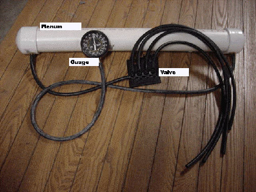

    I have made a cheap carb synchronizer out of a vacuum gauge, 3/16ths" tubing, four screw aquarium valve and a home made plenum. The gauge($8) is from Harbor Freight and the aquarium valve($4) is from my local fish store. The plenum tank is just PVC pipe with a couple of brass taps screwed into it($3). The plenum was used to
    dampen the fluctuation of the needle on the vacuum gauge.
    Click image for larger version  Name:	20020830-mysyncrotool.jpg Views:	0 Size:	83.1 KB ID:	860322

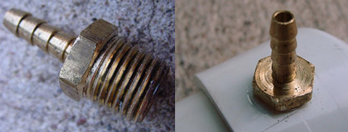

    Here is one of the brass plenum fittings:
    Click image for larger version  Name:	20020830-brassplenum.jpg Views:	0 Size:	31.9 KB ID:	860323

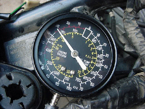

    Closer shots of the gauge and valve:

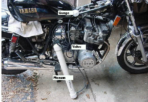

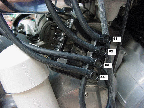

    Operation: Adjust each carb by turning on the valve that is connected to it's manifold while the other three are closed. This takes a little longer than the mercury sync but it is cheap and you can open the throttle as much as you like without worry of ingesting mercury.
    If I had it to do over again I would make the plenum out of larger diameter PVC and have a threaded cap on one end so all the parts would fit inside.
