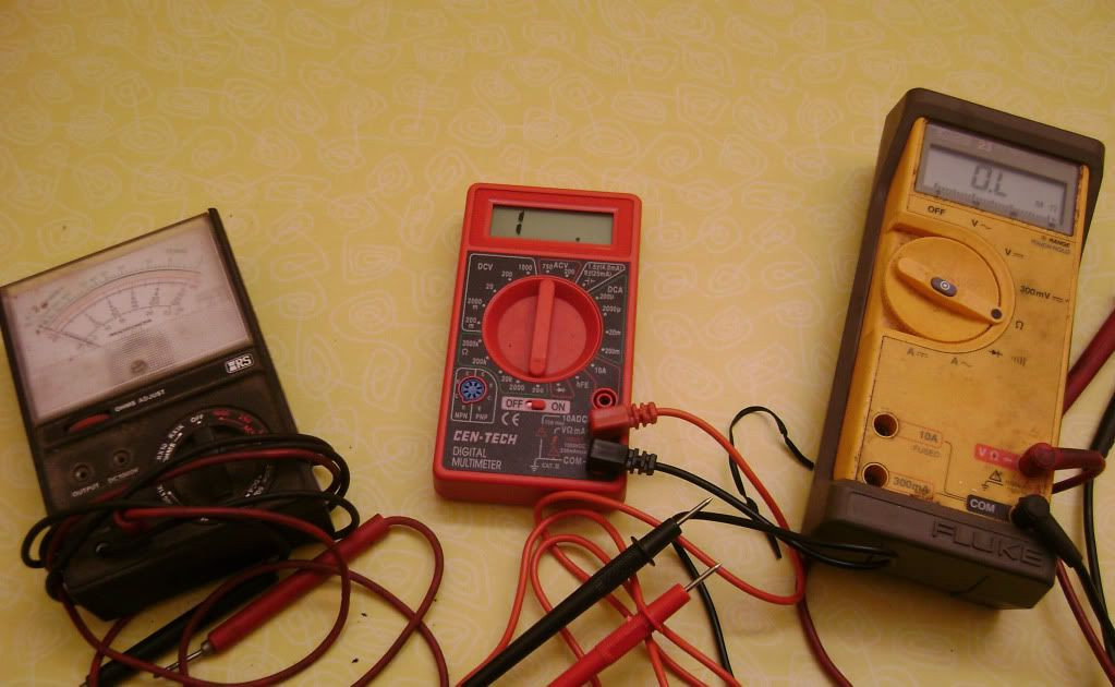

    For most of us, you'll have or will want to get a hand-held meter. There's all sorts out there, you may have one you've inherited, but there's two basic types; the analog meter and the digital meter. Here's a pic of the two types...
    Click image for larger version  Name:	Meter3.jpg Views:	0 Size:	135.9 KB ID:	860597
    The analog is on the left, the other two are digital. Both types will work for our purposes, but the analog type takes much better attention to reading it to get reasonable accuracy and usually can't match a good digital for that. One advantage analog has over some digital meters is it will 'read' moving values, while most digital meters take a moment to stabilise before giving a reading. I'll talk more about this in a moment. I'm not going to go into the analog type much due to their rarity these days.

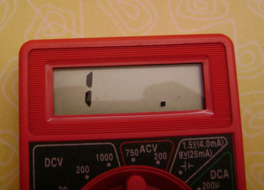

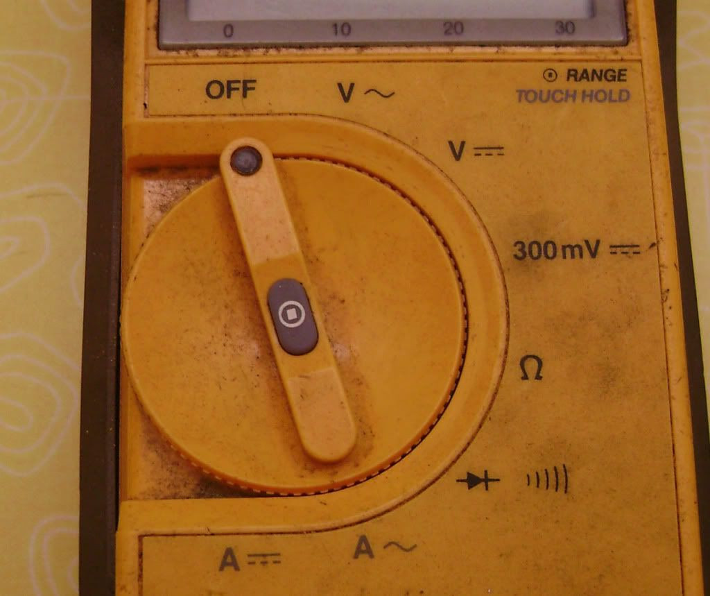

    So how do you 'set' the meter to get readings? Here's pics of the two digital meter selector switches...
    Click image for larger version  Name:	Meter2.jpg Views:	0 Size:	201.6 KB ID:	860598
    Click image for larger version  Name:	Meter1.jpg Views:	0 Size:	135.7 KB ID:	860599

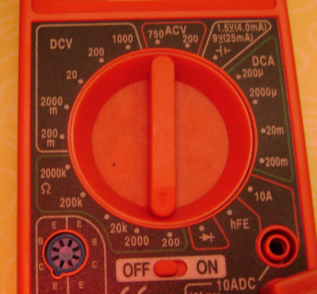

    The top meter is a full-manual meter (and a analog meter will be similar); you have to turn the selector switch to the value you want to measure. You do have to take care here on live circuits, as using a wrong setting can kill the meter, such as selecting a 20 volt scale then trying to measure a voltage above that amount. The lower meter is a 'auto-ranging' type; it will automatically select the correct range, although this model also allows manual selection if desired (a very good feature to have). On the red meter, the test positions you'll be using will be the 20 DCV, the 200, 2000, and 20K ohm, the latter two for checking the ignition coils and spark plug caps only. You may also use the diode position once in a while to check the rectifier/regulator and the harness diode on the '80-81 bikes. On the yellow meter, the positions are (clockwise from 'off') AC volts, DC volts, 300 Millivolts, ohms, diode test, and AC then DC amps. Again, you'll be using the DC volts and ohms, and the diode test rarely. The button in the middle of the selector switch is for manually selecting range.
    Ok, What's the reading on the display mean? We'll start with the manual meter...
    Click image for larger version  Name:	Meter4.jpg Views:	0 Size:	110.6 KB ID:	860600
    In this case, the meter is set to the '200' ohm scale, so you'll get a direct reading in ohms of whatever you're checking as long as it's resistance is under 200 ohms. If it's over that, the display won't change. As you increase the range, the meter won't be able to measure small amounts and a low resistance will show as zero. For 99% of the resistance checks you'll want to do on a bike, this is the scale you'll use. You'll get the best accuracy by using the lowest scale (without going under the measured value) for both ohms and voltage.

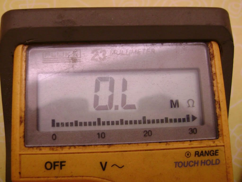

    Here's the auto-range meter...
    Click image for larger version  Name:	Meter5.jpg Views:	0 Size:	116.8 KB ID:	860601
    There's more stuff going on here; first, this meter displays the type of measurement you're making, in this case ohms. It's also putting a 'M' in front of it, which means it's set to measure megohms (millions). A 'K' would mean thousands, no letter is straight ohms. The 'OL' it's displaying means 'open line'. Being an auto-range type, it will automatically switch to a lower scale if it measures a low resistance. The other thing to note is the 'bar' at the bottom of the display; this is a 'analog' graph (giving you the same function as an analog meter for reading moving values), extremely useful to have. Voltage values will be read out directly.
