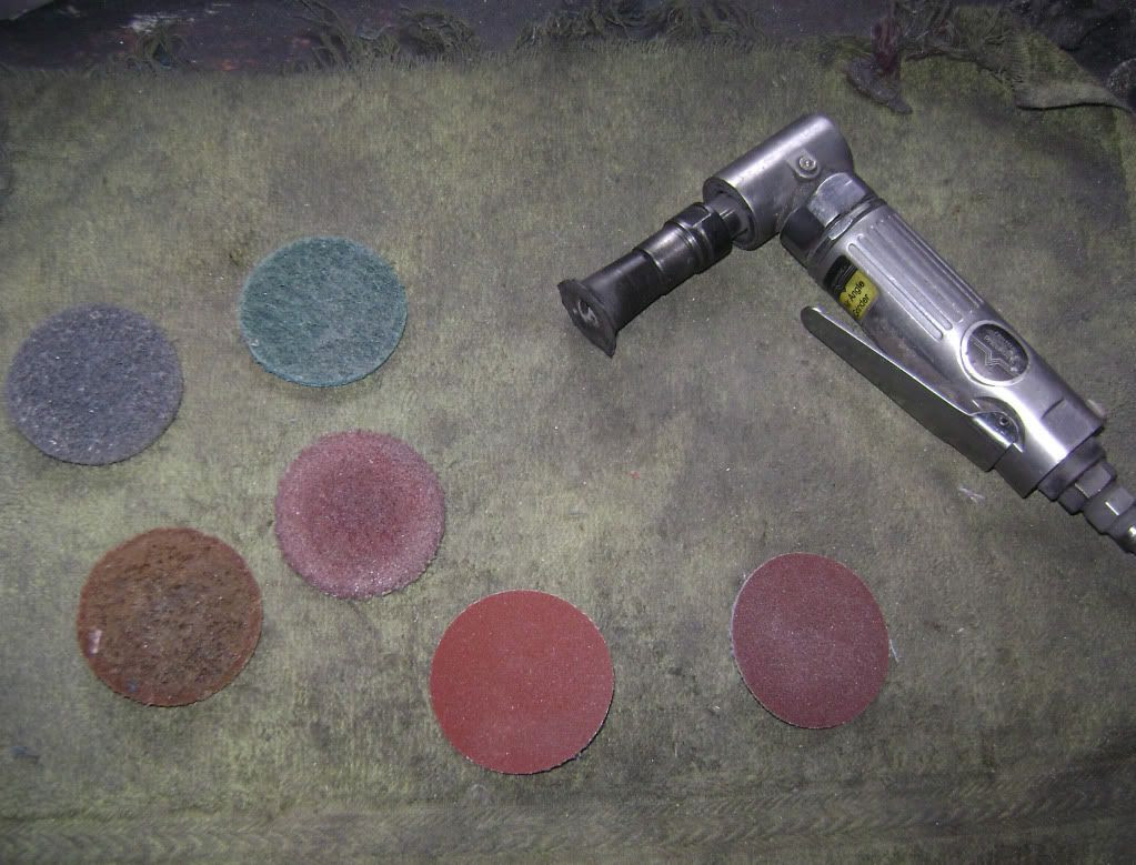

    First, the tools needed.

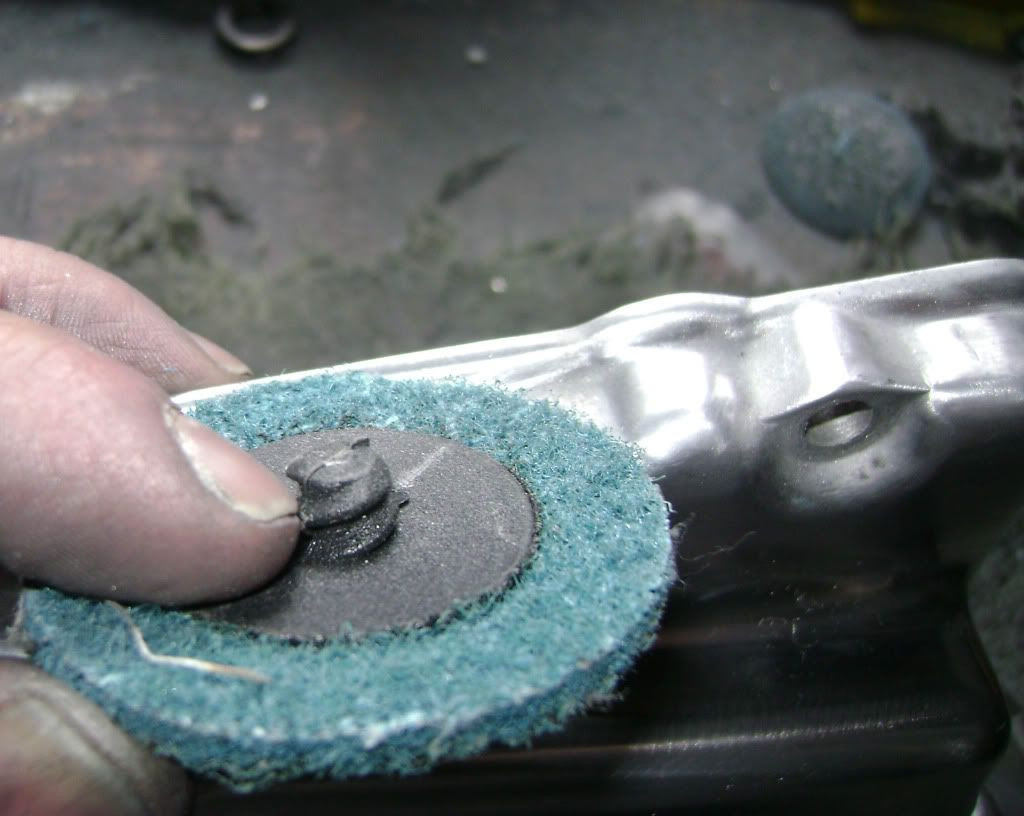

    Here's the real secret; surface conditioning discs AKA Scotchbrite, as seen to the left. These are made by a number of companies in 'standard' grits, I buy mine here: http://keenabrasives.com/Surface%20C...20Type%20R.htm. I'm sure you can find these locally also, but Keen has by far the best prices I've found. You need a bunch of 'em, you won't get by with just a few...
    Shown are the four main 'grits'; brown (coarse), maroon (medium), blue (fine), and grey (very fine). The ones I use most are the blue and grey, but the other two are handy to have too; I'll get to specific uses further along. I also use the 2" size, as I've found that to be the best size for getting into places. I also use 2" sanding discs, usually in 240 and 320 grits for more aggressive material removal. Note that the disc holder is broken; that's on purpose. By not having the whole disc supported, this allows the edges to 'curl' when sanding into curved areas, giving you a nice 'blend' rather than gouging the metal, although the discs need to be used a while before they'll do this. To run these, I use a $15 HF angle-head die grinder.

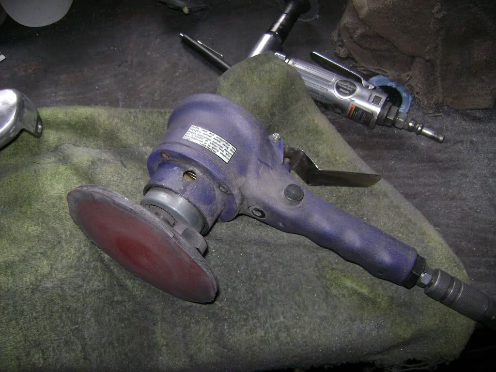

    You'll also want a larger 5" disc sander. Again, an inexpensive HF unit is used with a foam-backed pad and adhesive-backed sanding discs. This unit will both 'orbit' and spin; I lock it on spin. 400 grit discs are as coarse as you want these to be. I'd get some 400 grit, and maybe some 600. I use this for smoothing/blending larger areas. Great for removing deep scratches. Keen also carries these, so you can do one-stop shopping. Got all this stuff? Let's do a piece....

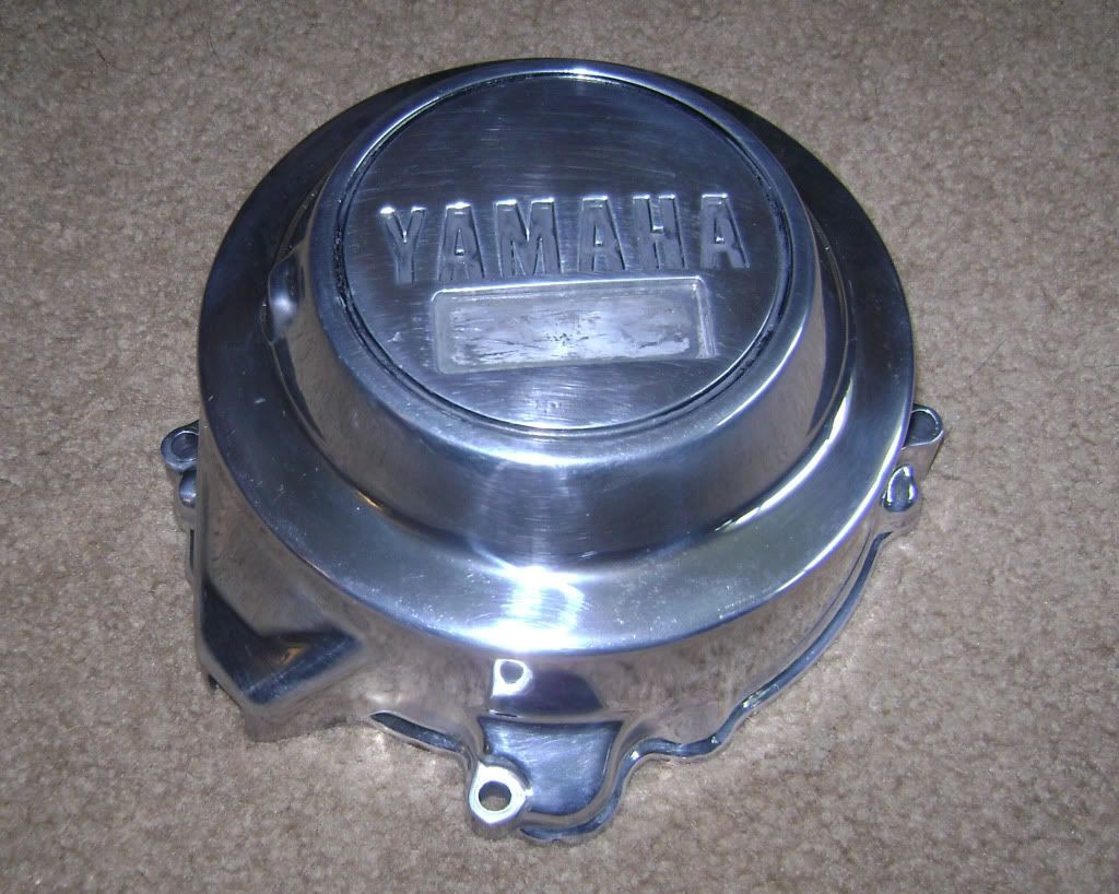

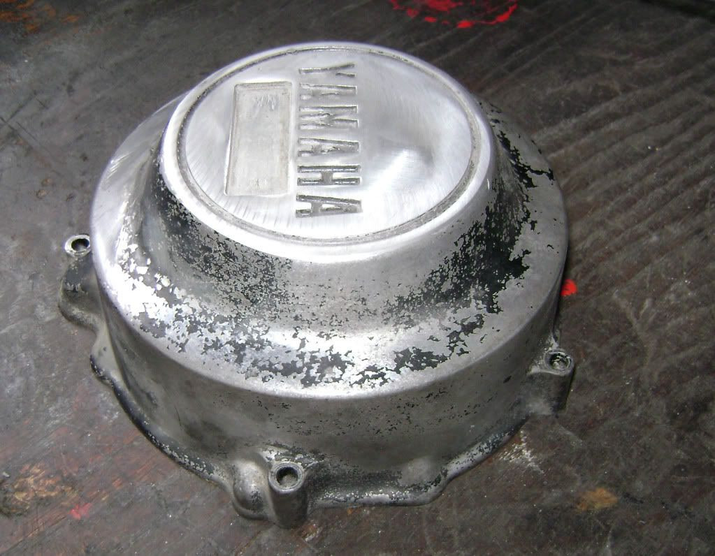

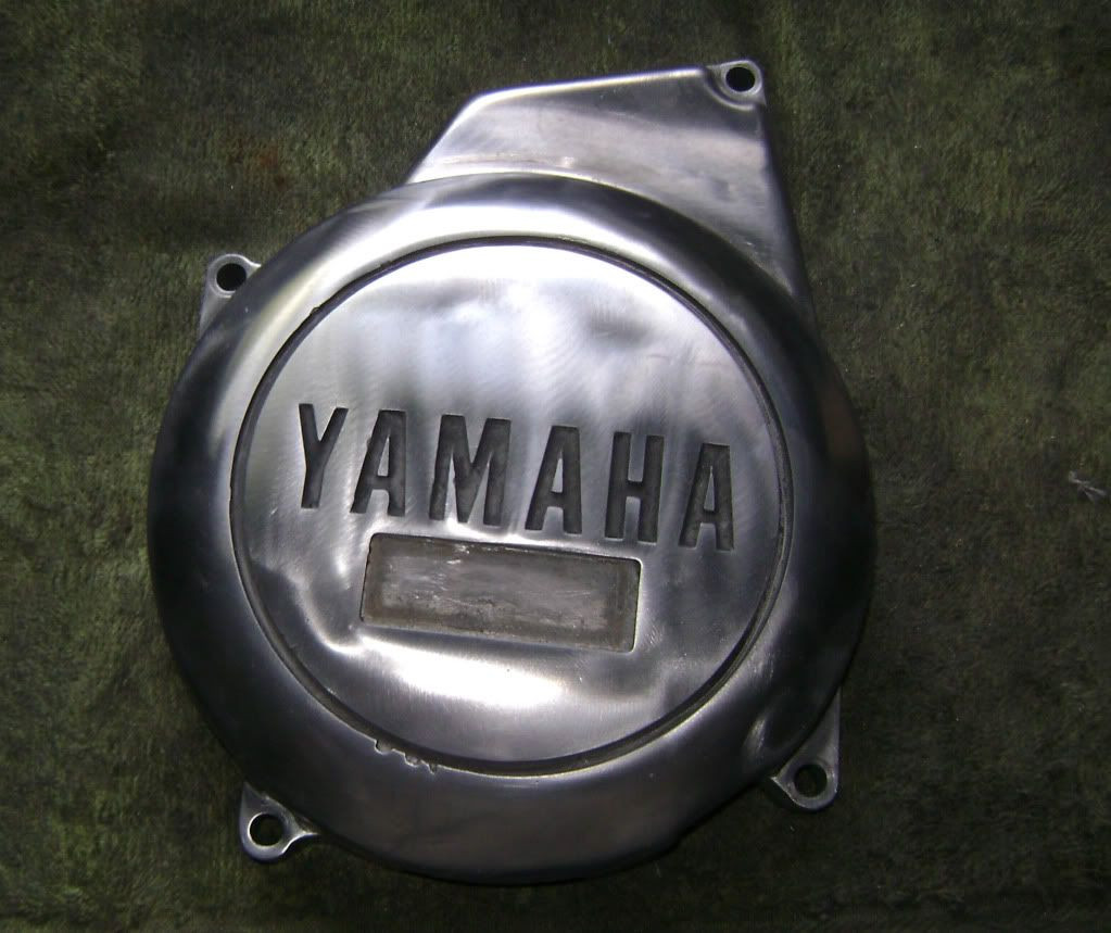

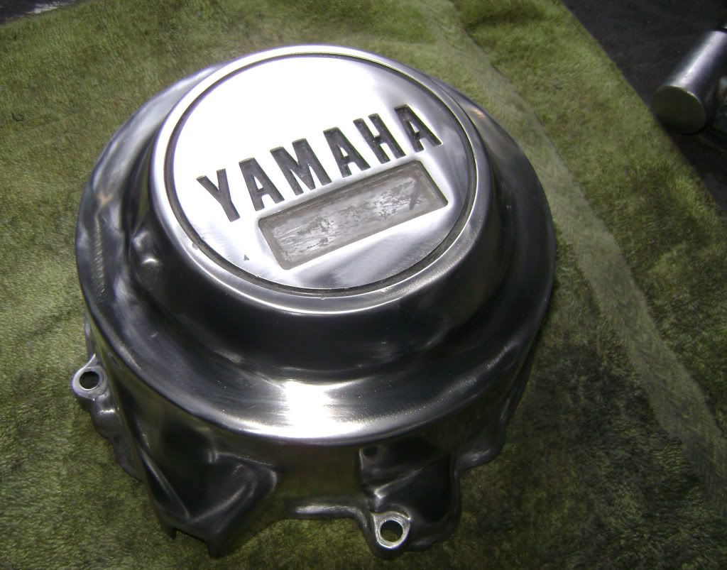

    A XJ alternator cover. Here's most of the problems you'll run into in one place. Clearcoat is mostly gone but it's been painted, dull oxidized metal, and some deep scratches on the face. I've already hit the face with the disc sander to level that (a matter of a few minutes), so let's move on to the conditioning discs...
    After about 20 minutes with the conditioning discs (blue, then grey), it looks like this. This is ready to buff, no more work needed; total time about 1/2 hour!

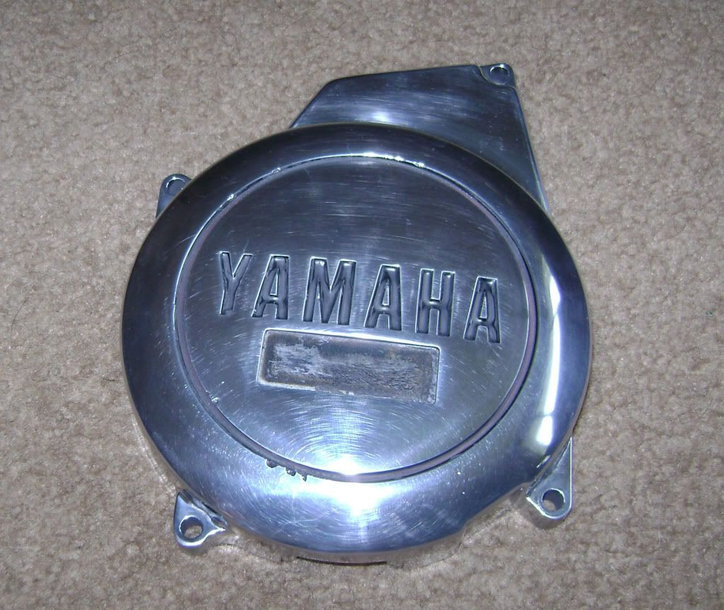

    After only 15 minutes at the buffer, the restored part.

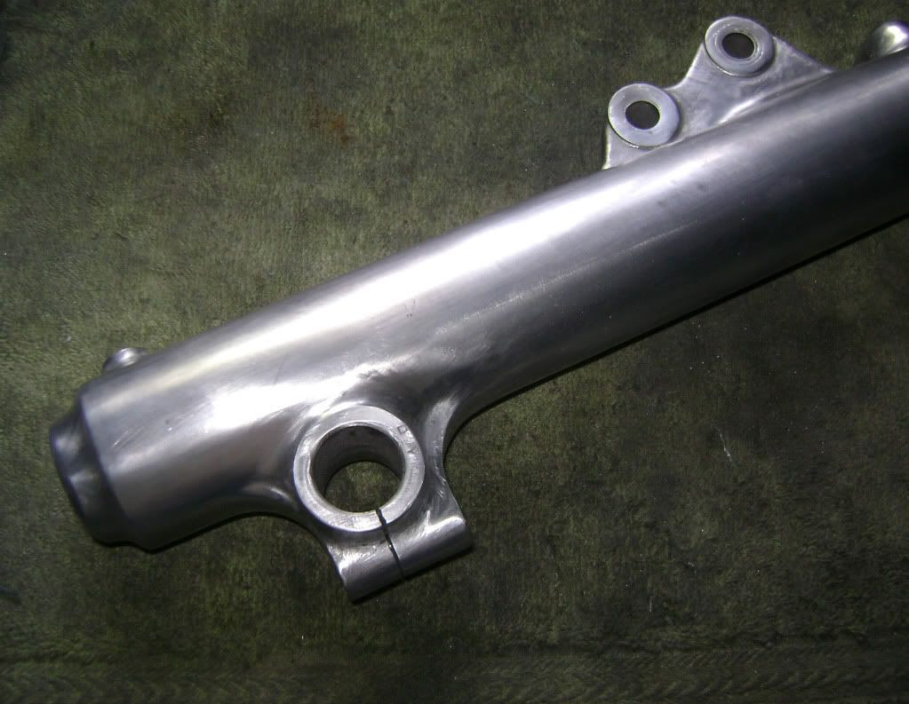

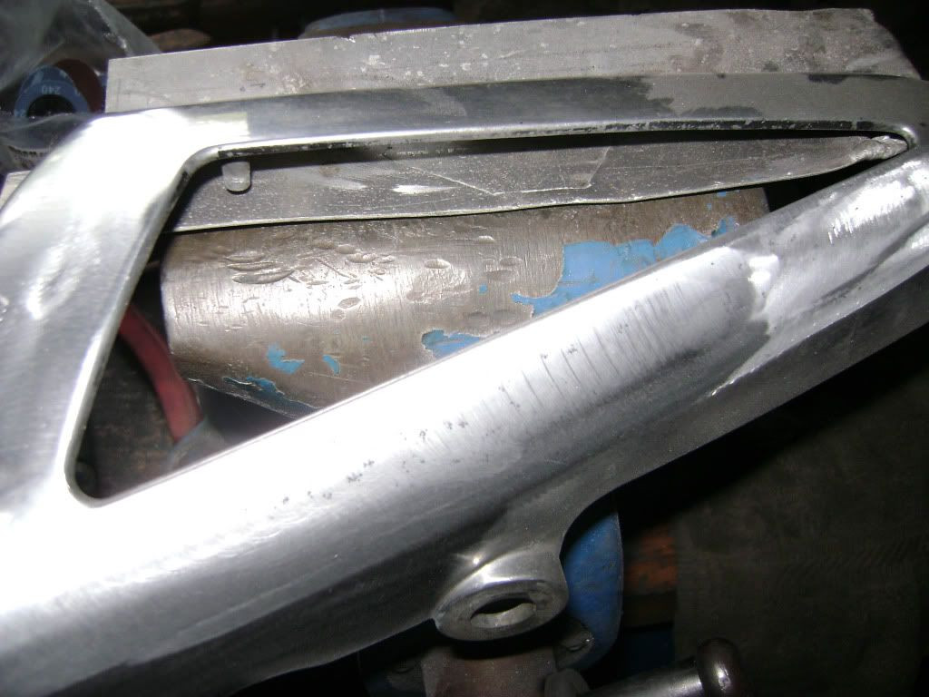

    For fork sliders or other 'long' or flat pieces, I'll use the 5" discs to initially smooth the main areas, then follow up with the conditioning discs.
    I've 'blended' some pretty deep scratches out of the cast aluminum grab rails on both this XJ and the SG I did with these.

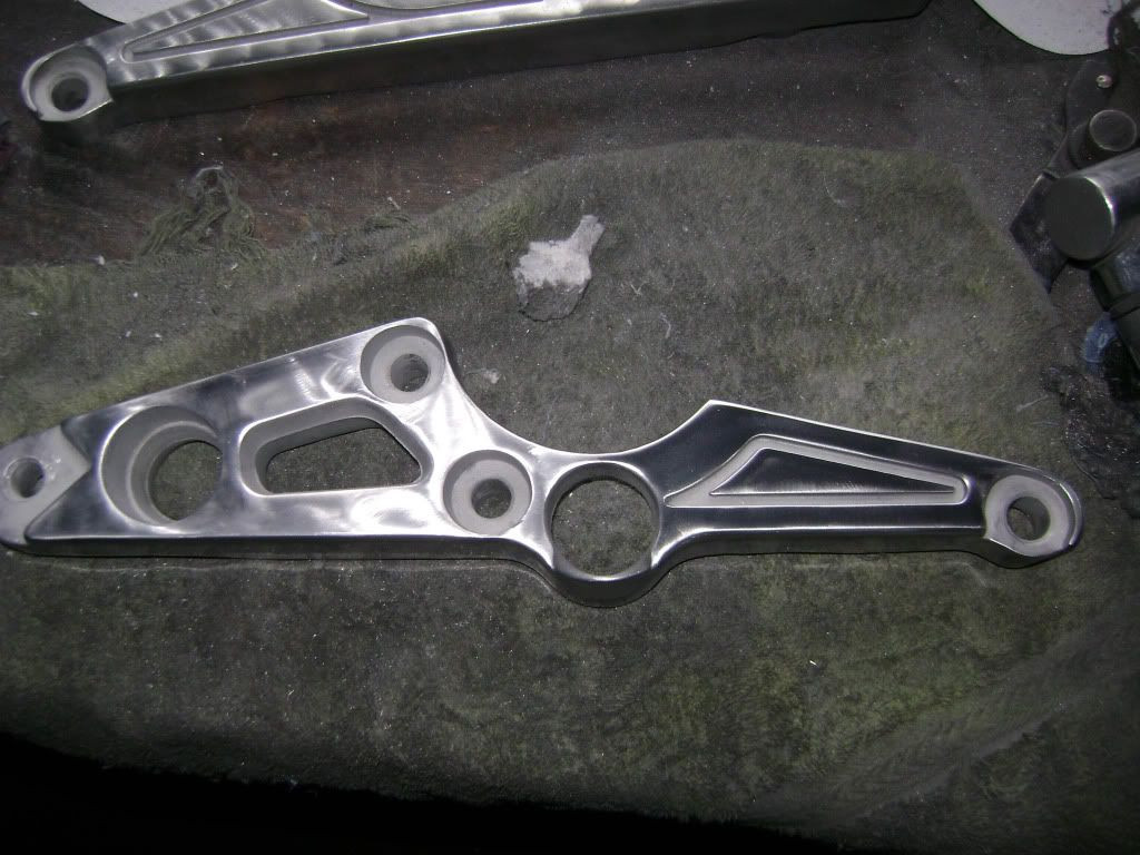

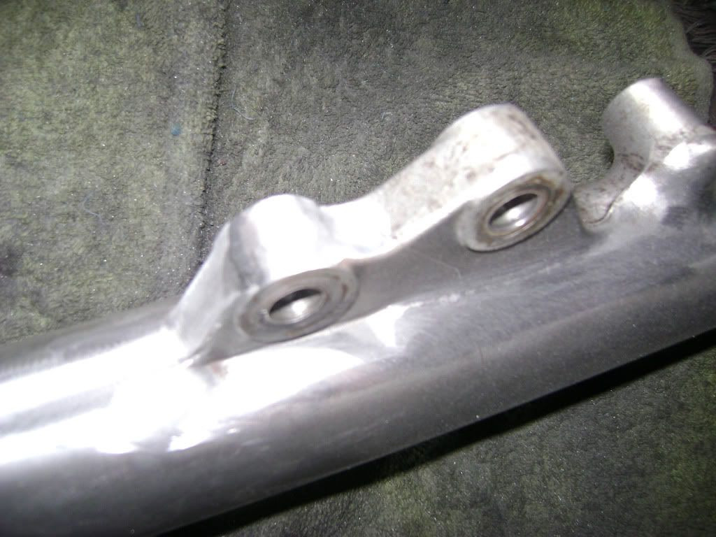

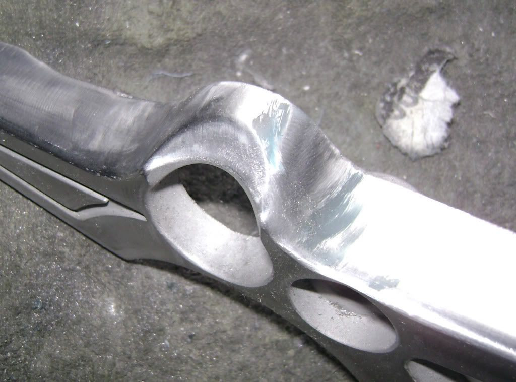

    For really rough areas, I'll use the 2" sanding discs to level, then follow with the conditioning discs. You can sometimes use the brown or maroon discs instead of the sanding discs, but they work better at 'blending' rough areas rather than removing material. The area around the axle mounts on these XJ forks took some time; about an hour for each fork lower in prep. Yamaha only 'polished' about half of these at the factory...

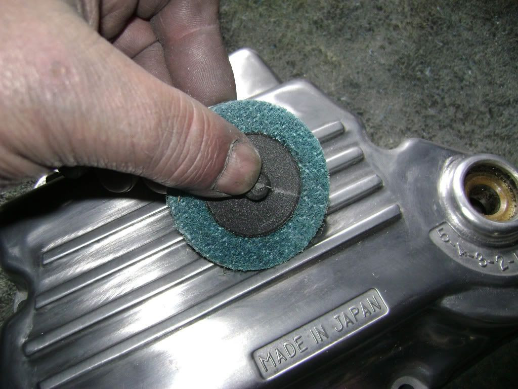

    A few tricks...
    One area on these that's always hard to get is next to the 'fins' on the shifter cover and cam cover. Using a new disc, hit these areas first before the disc starts to break down.

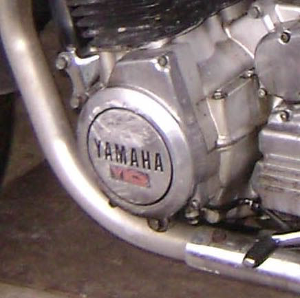

    Ok, these discs do have a few drawbacks; they can overheat and 'smear' onto the work surface as seen here, particularly after they start to wear. Keeping the disc moving over the surface will help with this. Not a big deal when it happens, I use some 0000 steel wool to remove it. How many discs will you run through? Well, that depends; figure about one disc of each type per piece, maybe two for larger pieces, less for small parts as a general rule. The number will depend on how bad the part is and how 'perfect' you want it. The 5" sanding discs don't last long either, I went through six on the ignition cover shown above. You can save the 'worn' blue discs and use them to clean gasket surfaces after scraping most of the gasket off though..

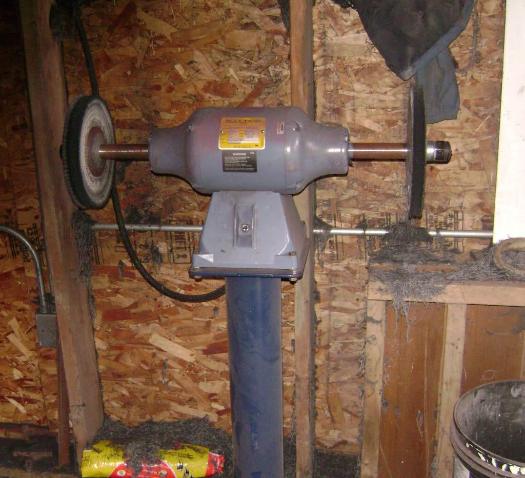

    What do I buff with?
    Ok, this is probably more than most will have; it's 1.5 HP Baldor buffer spinning 10" wheels. But even if you have a smaller buffer, that still won't increase your buffing time that much if the parts are well-prepped. Buffers can be put together pretty cheaply, and buffing wheels and compounds aren't expensive either. You'll need a sewn cotton spiral with tripoli to remove the scratches, and a loose cotton flannel with white for the 'color' buff. If you really want to 'detail' your parts, the wheels won't quite get into some recessed areas, you can use one of these...

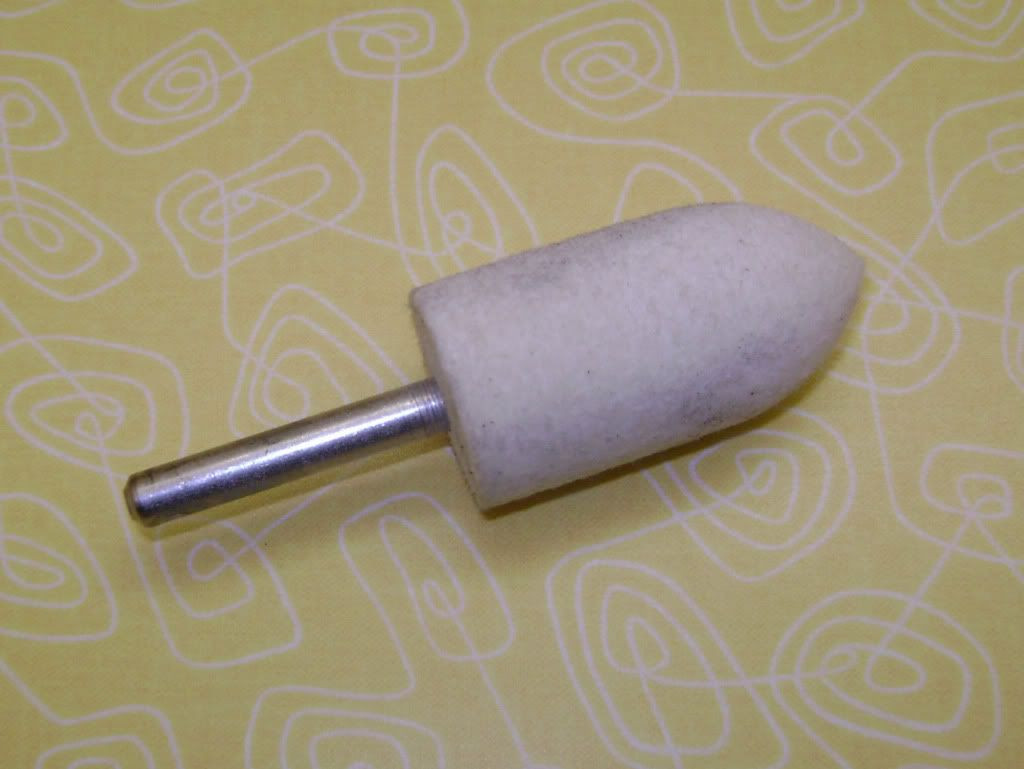

    ... felt buffs for those spots.

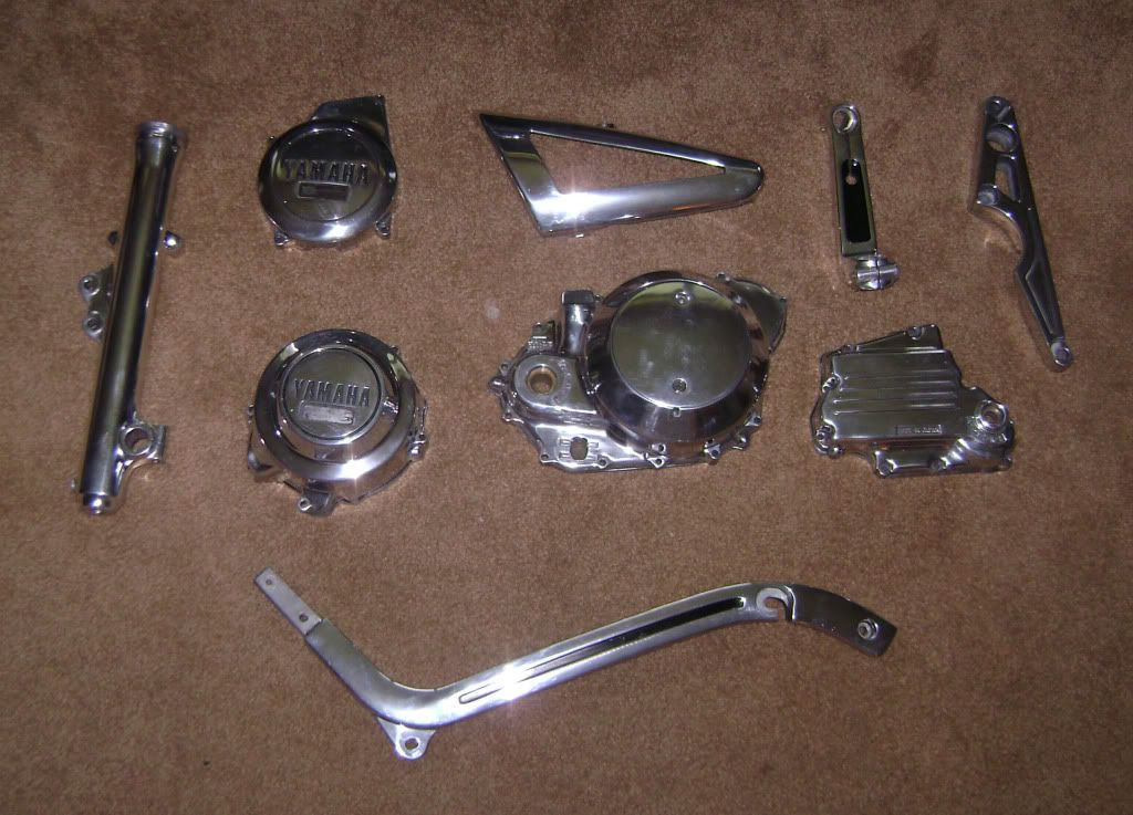

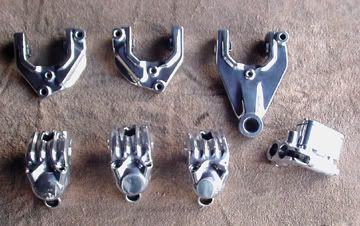

    And the parts? Here they are...

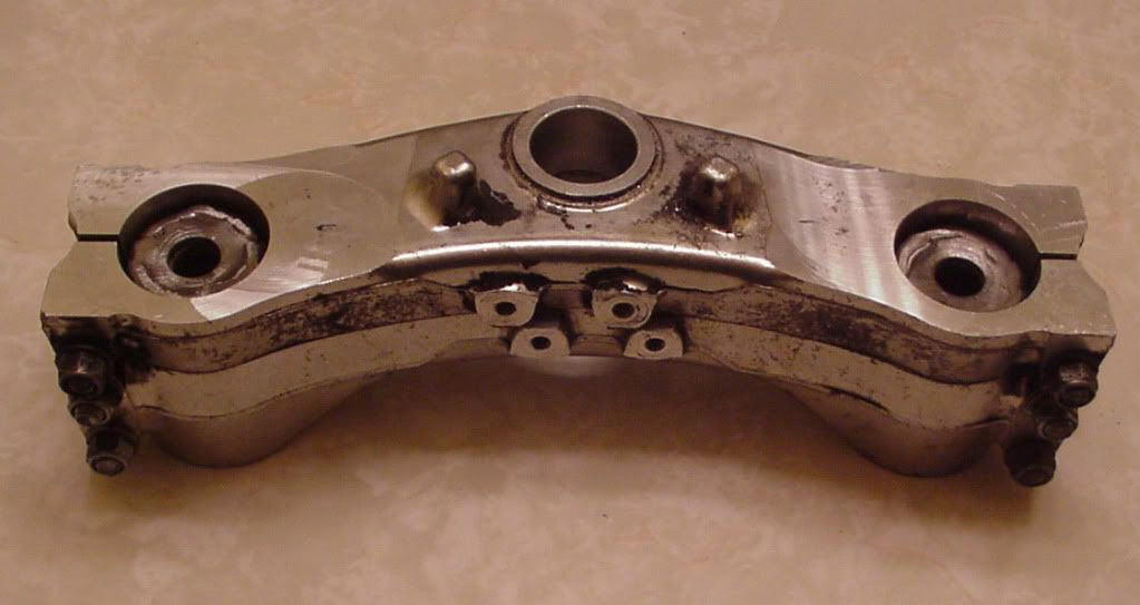

    For particularly lumpy parts or sand-cast parts...

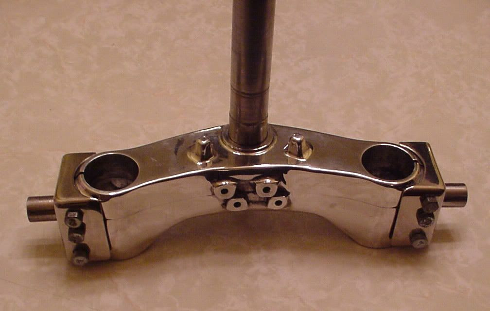

    ... like this lumpy modified FJ lower tree, you may need to use a grinder to shape the part...
    ... before moving to the discs and final polishing.

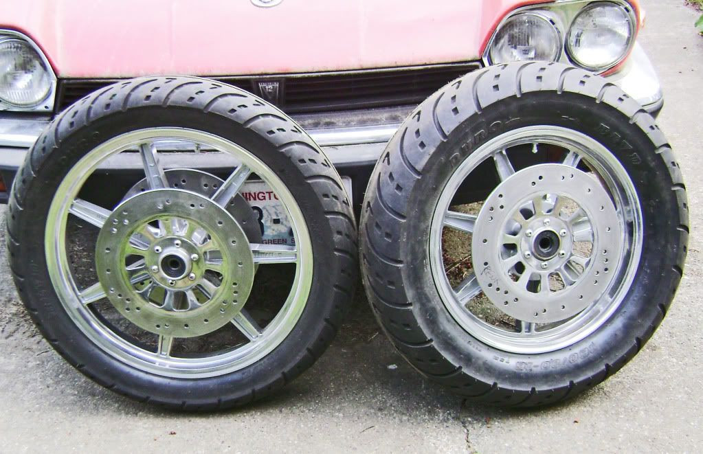

    You can polish pretty much any aluminum part, but getting into all the nooks and crannies is what will consume the time. For 'outside' surfaces, it's not that bad, but on some parts with 'inside' surfaces where you won't be able to get the discs or buffs in easily, the hand labor can become daunting...
    I won't admit to how many hours these took, let's just say a lot...
