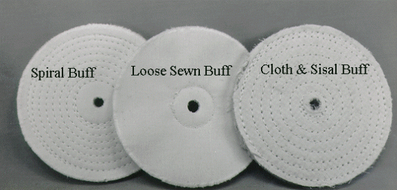

Sisal Wheel
Spiral Sewn Wheel
Loose Cotton Wheel
NOTE: Sisal wheels are much too aggressive for aluminum work!
These are three types of buffing wheels offered by Brightworks (photo credit to Brightworks, Inc. Their URL is listed below).
Note also that you don't have to go to the on-line sources for decent quality wheels. Sears, Lowe's and many other "hardware" stores sell what you need and, for most of us, are right around the corner.

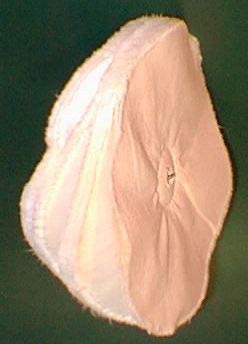

Bill uses three different grades of wheel:- Hard sewn 6" cotton
- Loose 6" cotton
- Soft flannel (?) 4" ( This one is smaller only because I had it on hand. If I were buying new I'd go with another 6")
