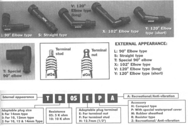

    From the DK catalog, fitting parameters for NGK plug caps:
    1st Letter code: Plug shape
    L=90 degree elbow
    S=Straight type
    T=Special 90..has extra cap beyond junction for gripping
    X=102 degree elbow
    V=120 degree elbow long type
    Y=120 degree elbow short type
    2nd letter code: Plug size
    B=14mm
    D=10-12mm
    Z=10,12,14mm
    3rd numeric code: resistance
    05=5 Kohm
    10=10 Kohm
    4th letter code: Adaptable plug terminal
    E=terminal nut
    F=terminal stud=T.S.
    H=12.7mm(1/2")
    5th letter code: accessory type
    H=compact type
    P=special waterproof cover
    M=rubber sheathed
    R=resistor type
    Z=recreational/anti-vibration
    6th letter code:
    A=recreational/anti-vibration
    Just some of the models available thru DK:
    NGK# DK# '02 Prices Description
    LB05F 20-51 $2.40 90 degree/14mm/5Kohm/T.S.
    VB05F 20-303 $3.30 120 deg LONG/14mm/5Kohm/T.S.
    XB05F 20-305 $3.30 102 deg/14mm/5Kohm/T.S.
    YB05F 20-307 $3.30 120 deg LONG/14mm/5Kohm/T.S.

    Plug Caps
    So as I understand it the closest to stock would be -
    NGK# DK# Price '02 Description
