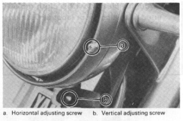

    This is from my XJ manual, Specials are similar:
    Click image for larger version  Name:	special_headlight.jpg Views:	0 Size:	64.8 KB ID:	861006
    a (upper) Horizontal adjusting screw b Vertical adjustment bolt
    Horizontal adjustment: clockwise = right, counterclockwise = left
    Vertical adjustment: Loosen screw b, move bucket, tighten.

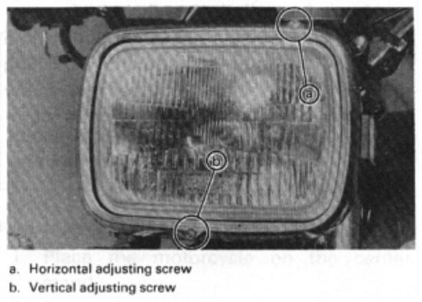

    From a Standard manual:
    Click image for larger version  Name:	standard_headlight.jpg Views:	0 Size:	50.5 KB ID:	861007
    a: Horizontal adjusting screw b: Fine vertical adjusting screw
    To shift the headlight beam to the left, screw in the horizontal adjust screw clockwise. To adjust the beam to the right, turn the screw counterclockwise.
    Coarse vertical adjustment is done at the screw beneath the headlight shell. The vertical fine adjustment screw is on the headlight rim. Turn the screw clockwise to lower the beam or counterclockwise to raise it.
