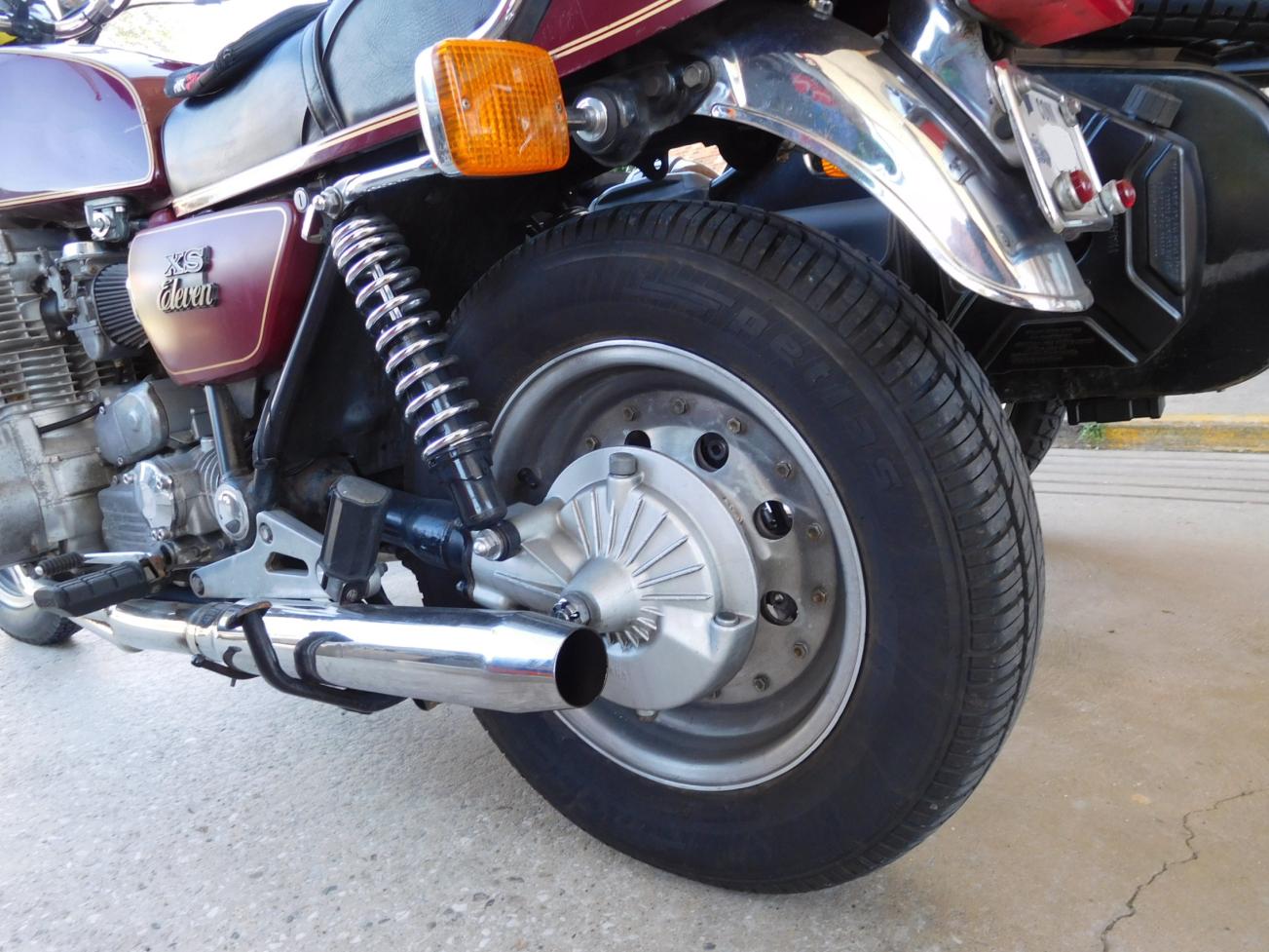

            • 2053
            I put an XS750 (almost identical to the XS850) on my rig. With the 165 15" car tire I turn about 4,000 RPM's @ 70MPH. Perfect.
            Click image for larger version  Name:	DSCN5741.jpg Views:	0 Size:	168.7 KB ID:	891504
