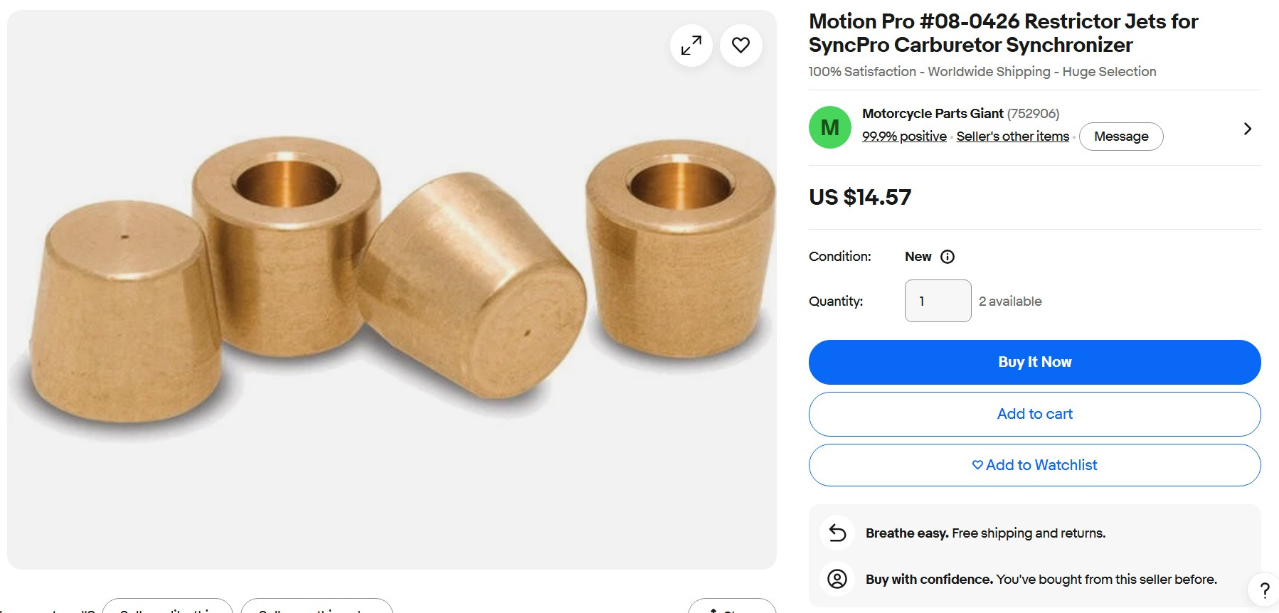

                This might help that issue.
Name:	sync restrictors.jpg

                  Sorry if I am asking the obvious, but where would they go?
                  Thanks
                    • 2104
                    Thanks
                    Next to the vacuum port, if installed next to advance mechanism the vacuum might collapse the hose.
                    • LoftCol
                      • Jul 2025
                      • 108
                      • UK
                      Of course, makes sense, thanks
