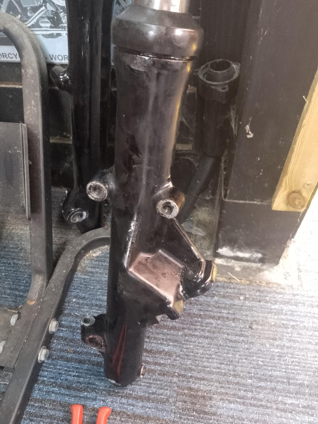

    Good afternoon, just discovered that the oil seal has gone on the front right hand side fork. I am planning to change them both, how do I identify which type of forks I have. The brake calipers are held in place by a single bolt the screws up from the bottom. The wheel shaft is clamped on the right-hand side and castle nut on the left.
    Thanks for any advice
    Those forks are from a Special, 79-81. Midnight Special 81 is different and won't fit. 37X48X10.5 is the size of the seal for your forks.

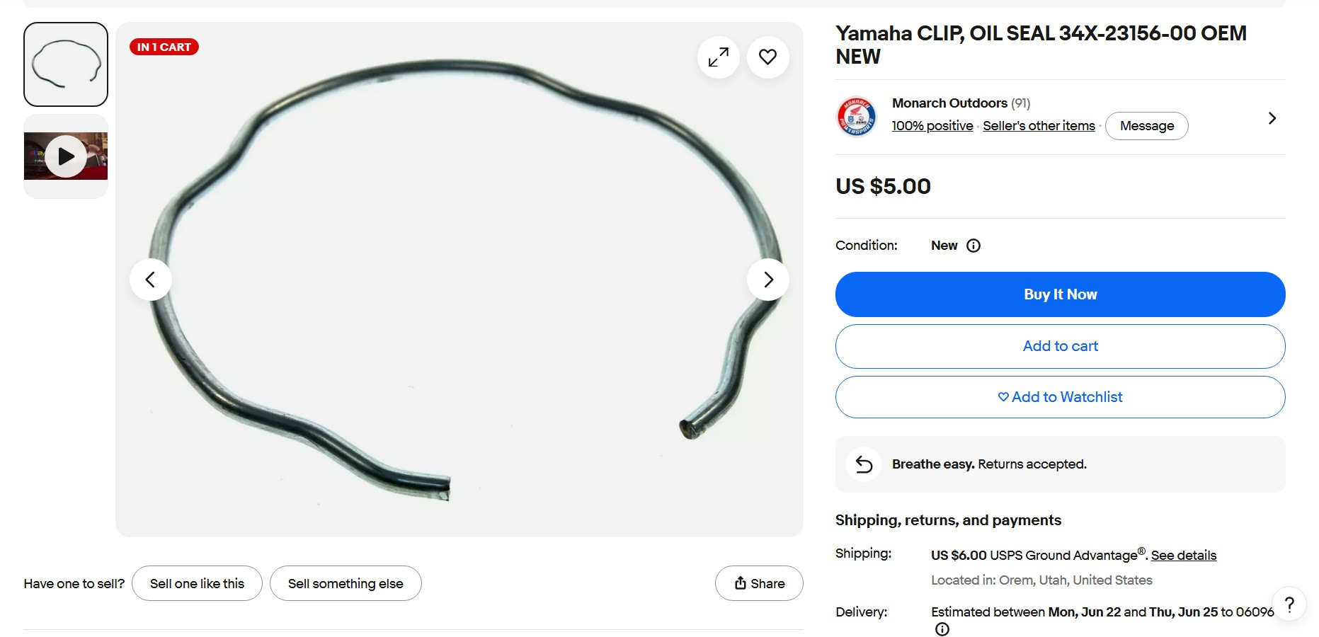

          Sorry, one other question. Does anyone know what size the clip should be that sits on top of the seal? It looks like both mine are missing. I am thinking the same size as the outer diameter of the seal.
          Thanks
            It should be just OVER the size of the seal, as it needs to fit snugly into the grove in the top of the fork. Here is the Yamaha part number : 34X-23156-00-00 . . CLIP, OIL SEAL . Looking at the number it MIGHT be a 56mm outside diameter. I would measure to be sure, but you can buy the inside snap rings at most hardware stores.
              https://www.ebay.com/itm/19652516624...SABEgKcxfD_BwE
Name:	Fork seal clip.jpg
