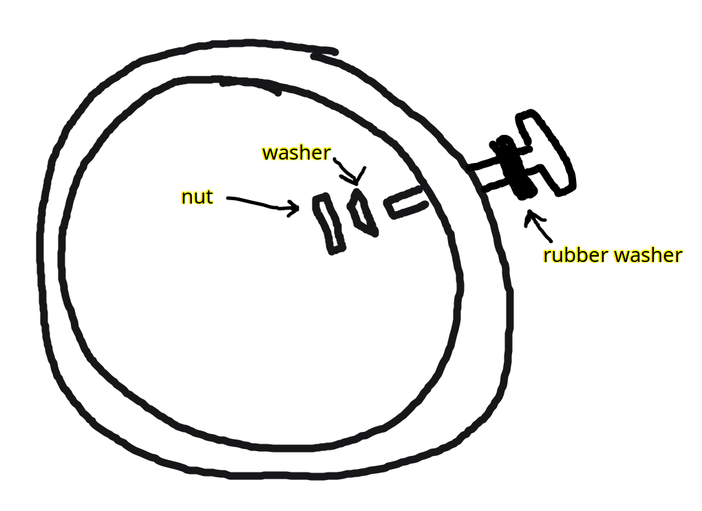

                    My valve stems came in today, I'm guessing the rubber piece on the valve stem goes inside the wheel?

                        Yes the rubber goes on the inside of the wheel to seal against it. You might want to visit the hardware store and pick up two more stainless nuts. You can then bolt the two nuts together so that you don't have to worry about it vibrating off. That or maybe a dab of blue loctite.

                          Awesome. I was actually going to do both an extra nut and a bit of blue loctite
