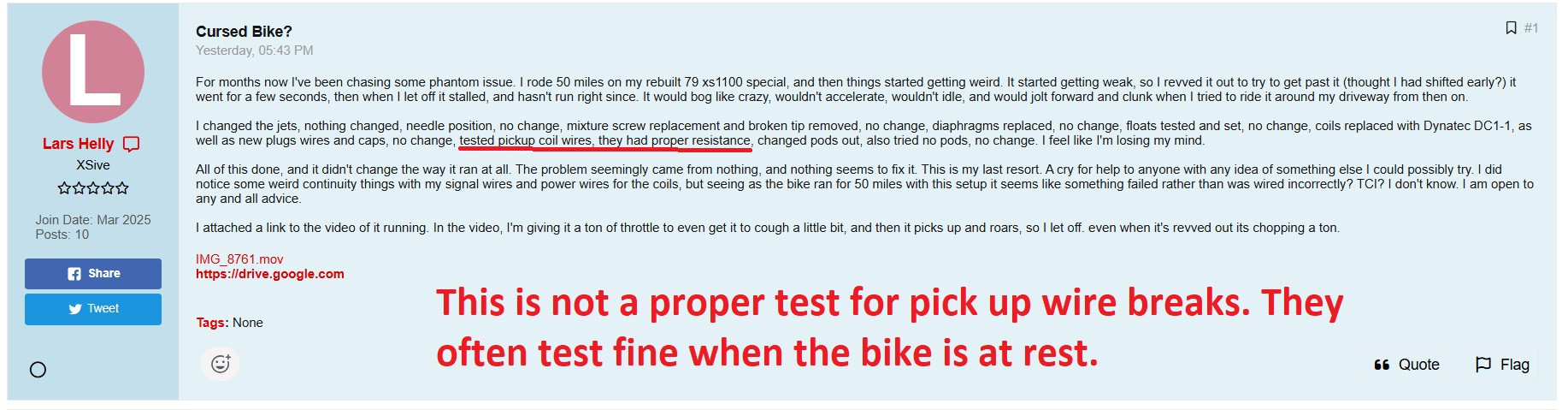

    I changed the jets, nothing changed, needle position, no change, mixture screw replacement and broken tip removed, no change, diaphragms replaced, no change, floats tested and set, no change, coils replaced with Dynatec DC1-1, as well as new plugs wires and caps, no change, tested pickup coil wires, they had proper resistance, changed pods out, also tried no pods, no change. I feel like I'm losing my mind.

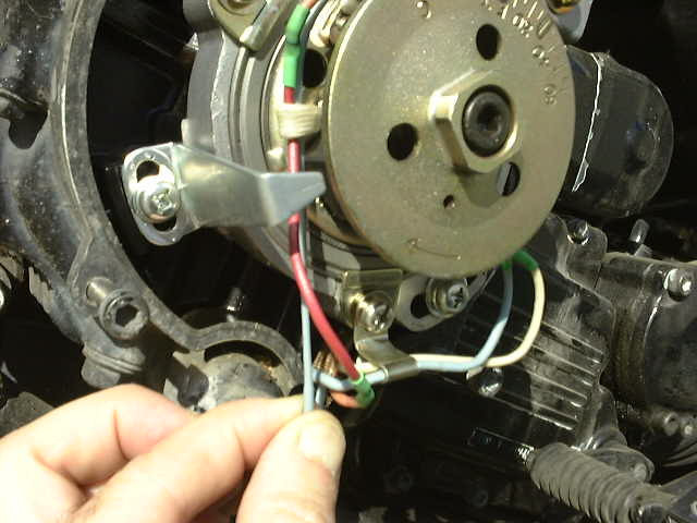

        last thing, check the pickup coil wires when running, do a search,,,pull off the cover and jiggle when running if it changes rpm,,,a VERY COMMON PROBLEM on these bikes, do a search and should be on you tube or this site,,,maybe someone can chime in..........

            (1) That's what I would do first. Pull on the pickup wires when it is trying to run.

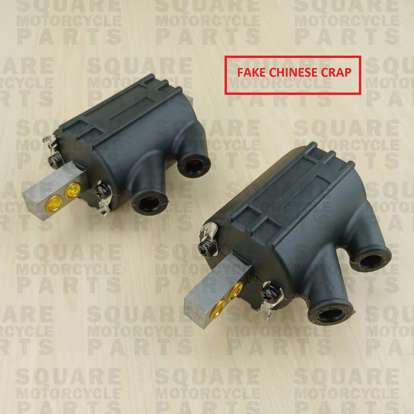

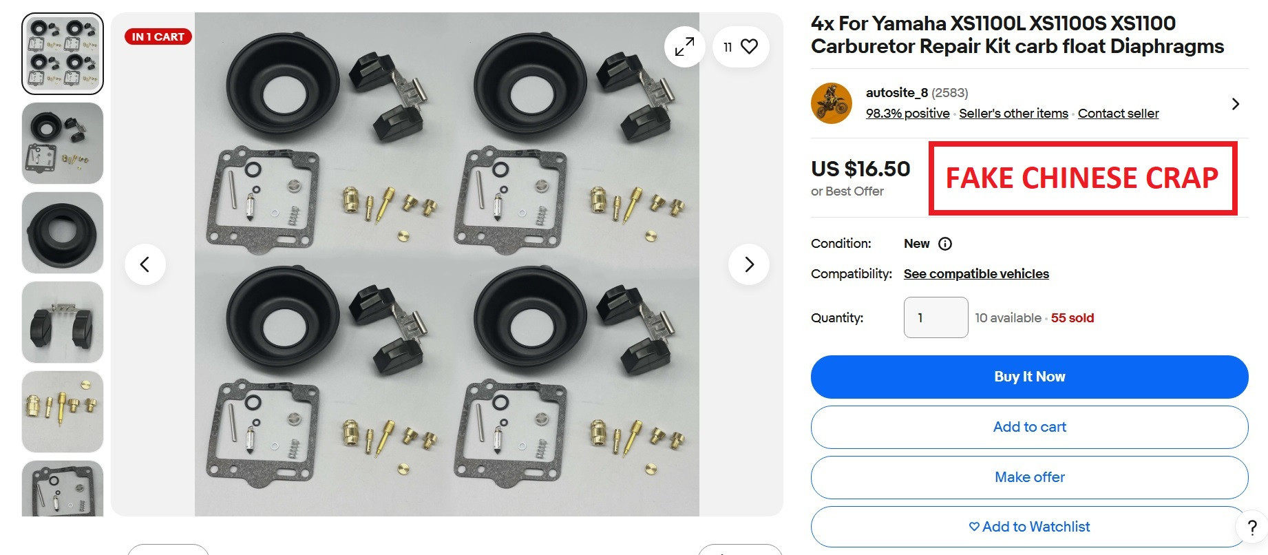

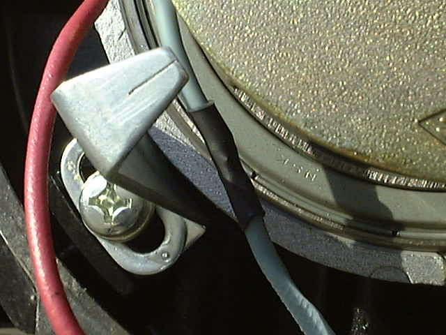

              You would also need to check the spark plugs. Are they genuine NGK? Lots of fake, engine damaging plugs out there. "Changed the jets"....to Chinese junk? What other Chinese parts have been install during this rebuild? Are the coils genuine Dyna?
              Back to the plugs. You should read them to see if any are fouled.

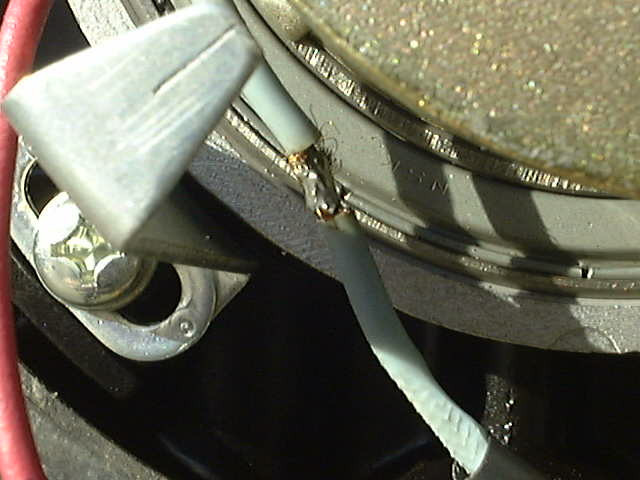

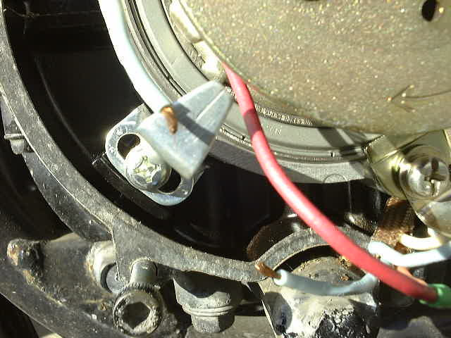

              And as always, the advance unit wires could be broken internally. https://xs11.club/forum/repairs/batt...il-wire-repair
              Click image for larger version  Name:	ezgif-3ba8f93dbf2b31fc.jpg Views:	0 Size:	177.5 KB ID:	890094
Name:	Chinese junk carb parts a.jpg
ID:	890097 Click image for larger version

Name:	Pick up wire test.jpg
ID:	890104 .......... Click image for larger version  Name:	20020906-pickup_repair3.jpg Views:	0 Size:	68.4 KB ID:	890103 Click image for larger version  Name:	20020906-pickup_repair4.jpg Views:	0 Size:	78.4 KB ID:	890102 Click image for larger version  Name:	20020906-pickup_repair6.jpg Views:	0 Size:	63.8 KB ID:	890101 Click image for larger version  Name:	20020906-pickup_repair7.jpg Views:	0 Size:	69.7 KB ID:	890100

                    What a dilemma. Because the bike has been so heavily modified it really hard to diagnose. You really have to, and I am not saying you haven't done a lot already, eliminate one thing at a time. Like everyone has suggested you really need to make good and sure that you don't have an electrical problem. Check everything from head to toe, grounds wiring, everything. Like Deebs pointed out with the spark plugs and all the fake Chinese junk out there. I am fairly sure after having replaced the coils you verified the spark through the plugs on each cylinder. One of the things about those coils and when you replaced them, the mounts you used to mount them to the bike, were they made out of ferrous metal or aluminum? If you have verified all of the electrical then you have to go back to the carbs. No where did you mention whether you synched the carbs or not. Sounds like you had them synched enough to drive it 50 miles though. I had a problem with one of mine a few years ago with similar issues and it ended up being the carbs. They had sat too long a crud had formed and a good strip down and thorough cleaning cleared up my issues. Bike running rough like yours can still be linked to the carbs not being perfectly tuned and synched.
                      • 812
                      To tell you the truth I really never knew what a thorough cleaning involved up until about 10 years ago when I joined the Suzuki GS forum. Up until then I took the carbs apart and gave everything a squirt with carb cleaner and called it good.
                      The guys on the GS forum vehemently reinforced that this wasn't going to cut it and kept suggesting using the one gallon can of Berrymans Carb Dip with the included parts basket and let the bodies soak overnight. At that time it was $35 a gallon and I figured I'd try the boiling in Pine Sol method which did the job but did stain the carb bodies a light grey color. They also said that using the original parts and only swapping out the orings was the best practice which I did
                      It ran better but after I figured out that the vacuum petcock was faulty and replacing it with a good quality one it ran pretty decent but still not what I would expect. After checking out the spark plug cap resistance and switching over to non resistor caps and resistor plugs it ran perfect.
                      Long and short of it the carb issues where indeed carb issues but I had been overlooking other things as well. I too go tricked by the faulty pickup wires are first on my XS and after properly sorting that out I rarely had a problem with it. The wires might LOOK good but pay particular attention to any sharp bends or areas that look thin in the insulation, that's where an intermittent problem is likely to be hiding.

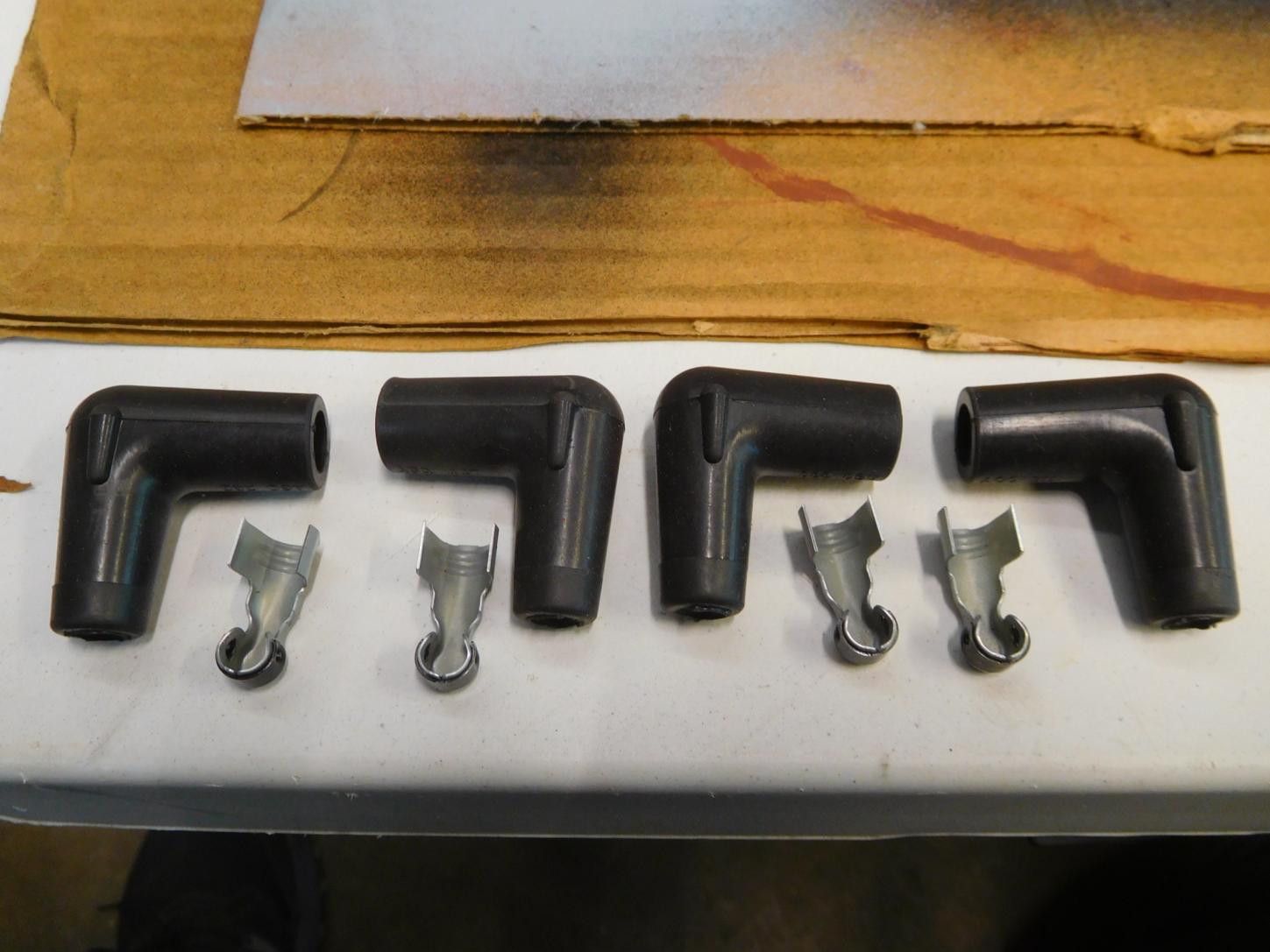

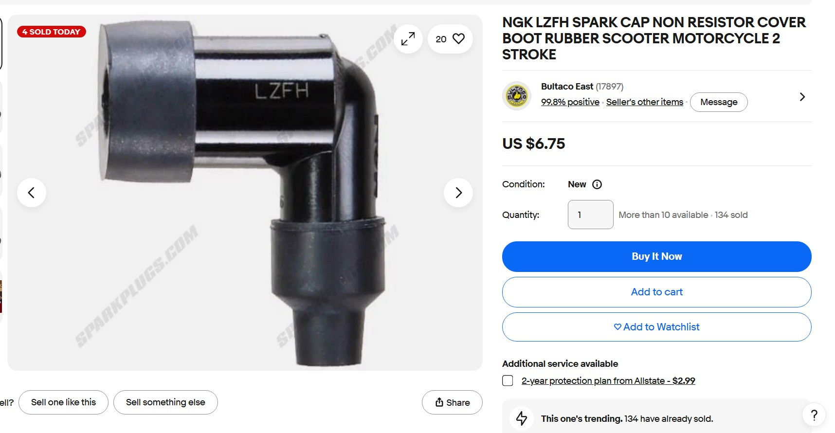

                        What sort of caps and from where? Thanks.
                          • 2009
                          https://www.ebay.com/itm/17692274237...Bk9SR_qp_NzOZw
Name:	0 ohm caps.jpg

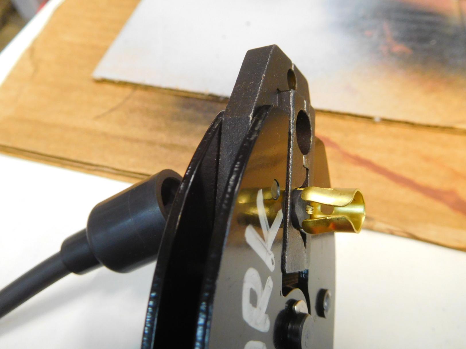

                            • 2009

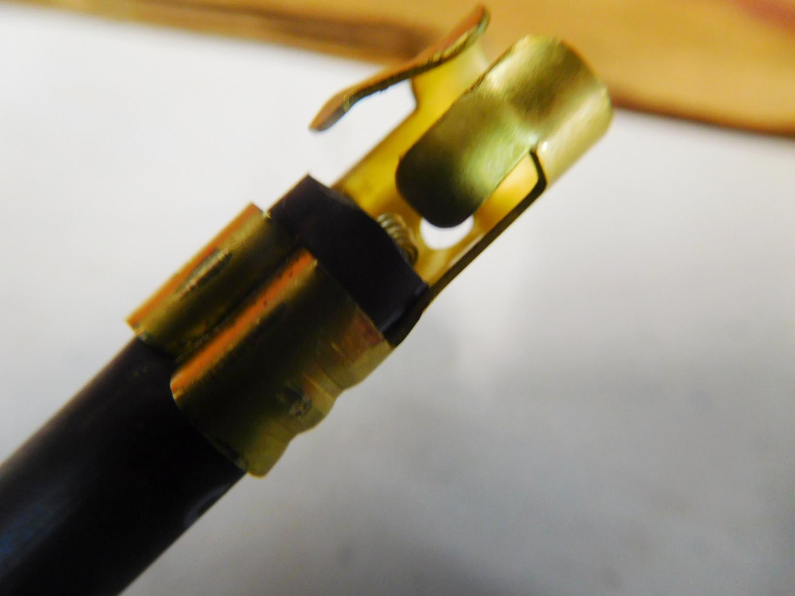

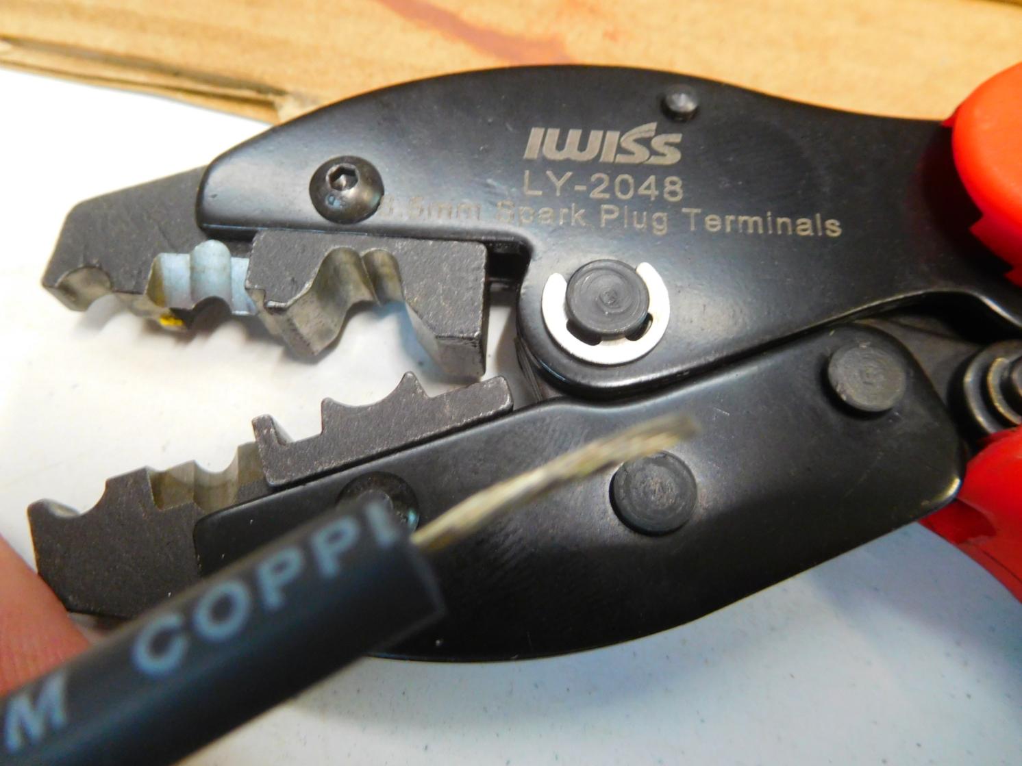

                            If you have a crimping tool, these are the ultimate.
                            https://www.ebay.com/itm/17447490509...wAAeSwzkBpATkk
Name:	Ton's Performance Terminals.jpg
ID:	890130 Click image for larger version
ID:	890131 Click image for larger version
ID:	890132 Click image for larger version
ID:	890133 Click image for larger version
