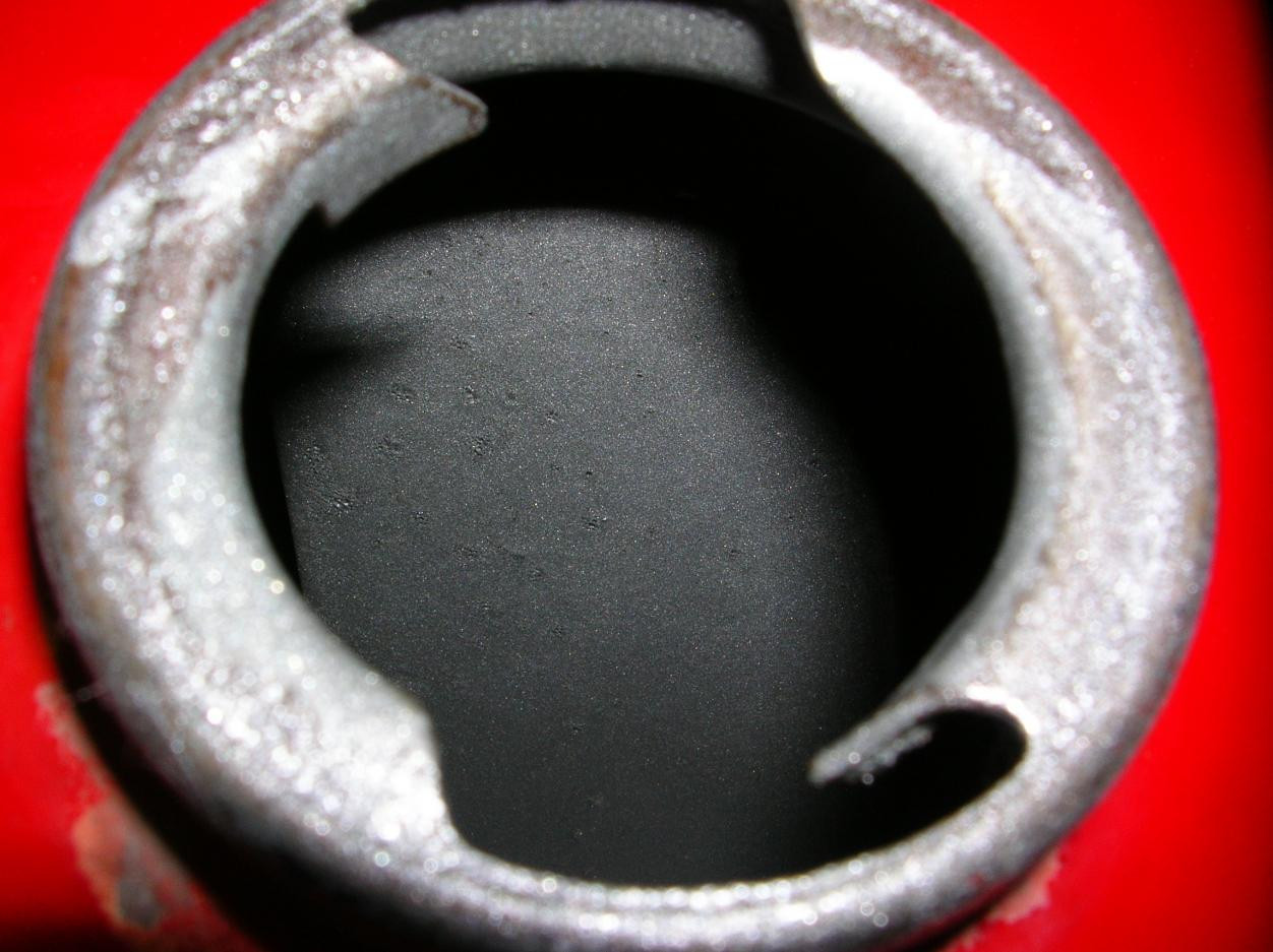

                I have used POR-15 since the late 90's on many bikes including my own. It has never failed. The directions must be followed to the letter (as with any product).

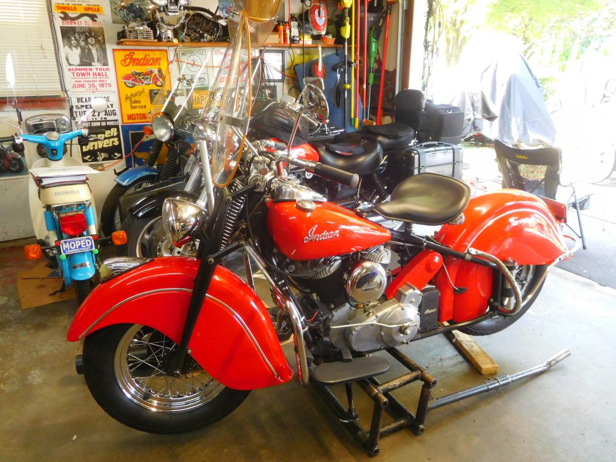

                    Kreem is complete garbage and should be avoided. It only lasted about 20 years in my Indian tanks and then dried out and shattered. I had to strip it out and apply POR-15. Been good ever since.

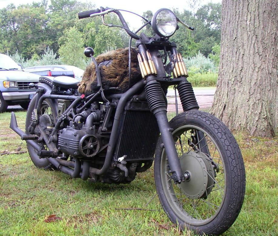

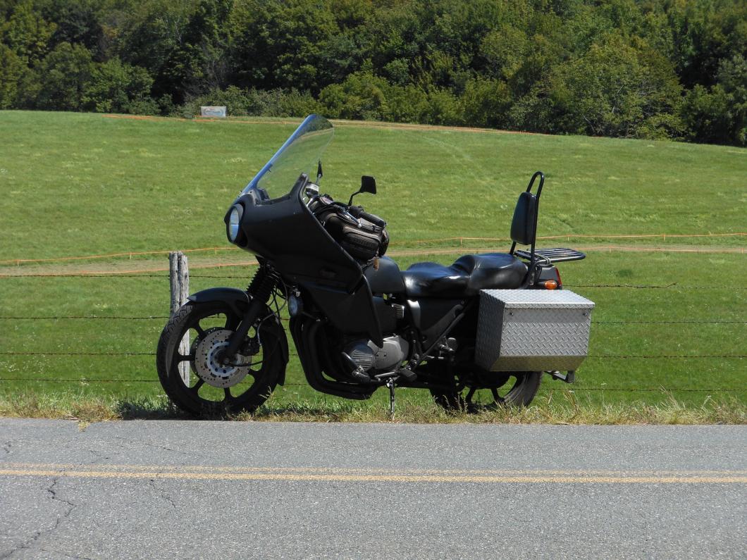

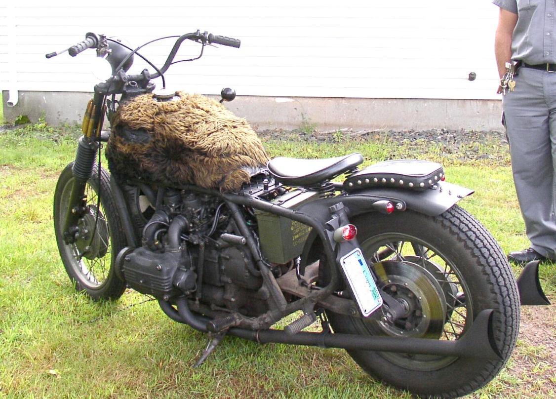

                          Yes Marty, I used Red Kote in a 75 Goldwing chopper in 2006 and an antique Skidoo snowmobile in 2018. The chopper is still sealed but it looks like crap. But it is sealed. The Skidoo went off to a customer and I don't know it's whereabouts these days. I did my KZ1000MKII tank with POR-15 in 1999 and it still looks like the day I put it in. POR-15 is in most of my antique bikes. Today, I wouldn't use anything else.
