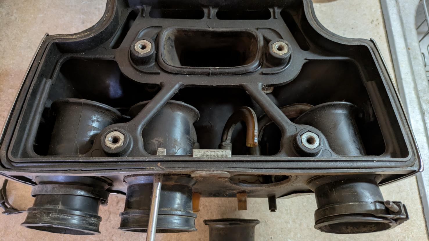

    Turn the upper AirBox upside down on the bench and insert a flat blade screwdriver as shown.... ( ͡° ͜ʖ ͡° )
    You'll need to work the blade around the boot same way as you would like your workin' a tire off a rim... (;☉_☉)
    Specifically... try to ensure the flat of the screwdriver lands against the lip INSIDE the AirBox and NOT on the AirBox tube itself. (╯•﹏•╰)
    JUST like working a tire off of a rim.... you CAN do it with one screwdriver but prob'ly be better/easier with two (2) so you don't LOse progress. (Θ︹Θ)
    Here's what it lookey like out/off-

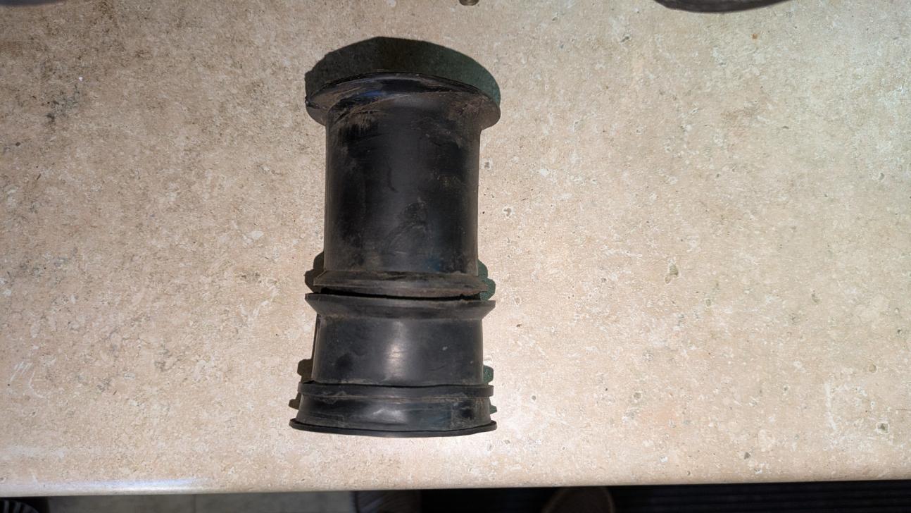

    Each boot looks like it is installed with a little tab so it's oriented correctly. The "lips" at the mid section are NOT SQUARE (perpendicular...) to the tube/boot so it makes the correct angle between the AirBox and the actual carb bell/inlet. (☉_☉)
    Ain't you glad that disassembling the whole AirBox isn't required? ( ๑‾̀◡‾́)σ" ​

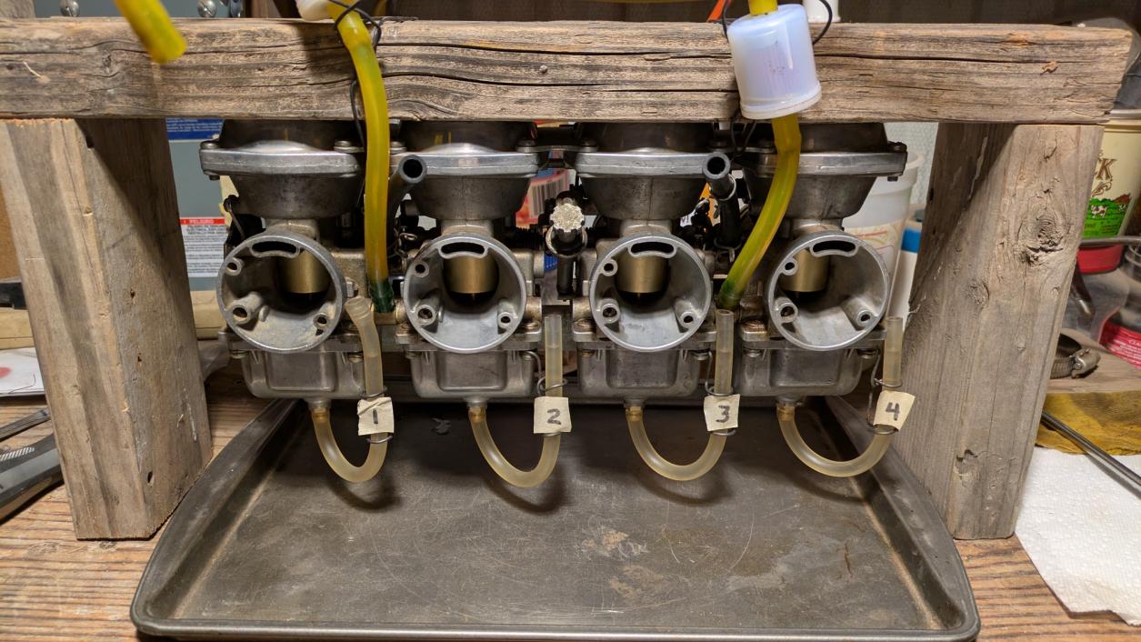

                    Beware of installing the Chinese/Taiwan Carb kits available on Amazon and E-bay.... (゜Д゜*)
                    Setting the float level(s) by measuring and adjusting these per the repair manual (X- distance in mm above the carb body surface..) no wurky. ~(‘.’~)

                      Well, I got the new boots today and just finished changing them out. No problem at all!! I didn't even need the screw driver. Just squeezed them and they came right out. Put dielectric grease in the new boots groove and a little on the lips, Squeezed and they started really easy. Then I just "screwed them in" while holding the lip in the groove. All done!! Larry, thanks for the pic. It showed me how it all worked.
                      I sent the carbs to Nathan Martin, in Ohio. He's a carb specialist and has dealt with many XS1100 carbs. He insists on good parts and has the same opinion of the Chinese/Taiwan carb kits you do. I've only set the float levels on my carbs once. Since the manual specs like you said, "no worky", I used the wet method like it looks like you have set up in your pic. Only lasted about a year though, before gas started pouring out and filling up the air filter box. Since I don't know what I'm doing, (and don't want to mess the the carbs anymore) I sent them to somebody who does know what they're doing. And you guys have been great to help.
