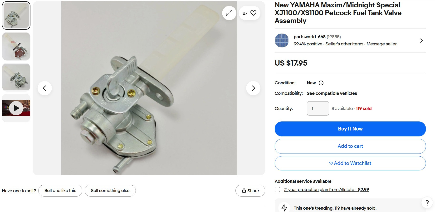

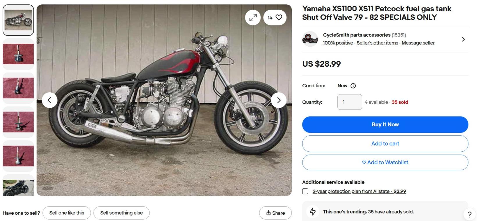

    I have a project in the wings (many of them) and I just acquired a nice Special tank. No petcocks. I thought I was going to be able to use early XS650 manual taps as the bolt spacing is smaller than the vacuum units. No joy. A simple solution would be nice. I know I can source OE and block the PRIME spigot. Is there another satisfactory option?
    https://www.ebay.com/itm/23320042039...Bk9SR6rutZ6dZw

      https://www.ebay.com/itm/11338697314...Bk9SR6rutZ6dZw

        This is for an XS11 Special tank?
        I have the on two XS11's and my XS750:
        https://www.ebay.com/itm/38969479929...Bk9SR6TK55-dZw
        I like them.

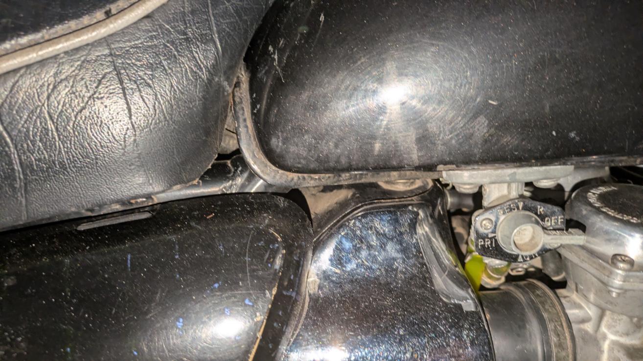

                  I did the alternate method- a short fuel line section and a bolt in the end. d(⌒ー⌒)
                  And yes... the OEM type do have the Off Position. (^_^)
                  I did have something similar to what Radioguylogs shows.... with all the different screw-in nipples that let you customize the angle/direction of the outlet(s). (º~º)
                  Two issues-
                  1. Getting those adjustable fittings to actually SEAL (not leak...) while IN the right angle/direction was a beeyatch. (o´_`o)
                  2. They DID (on my bike...) hit the air box so's I had to lift the tank at the rear by 1/4 inch. (*´_ゝ`)
