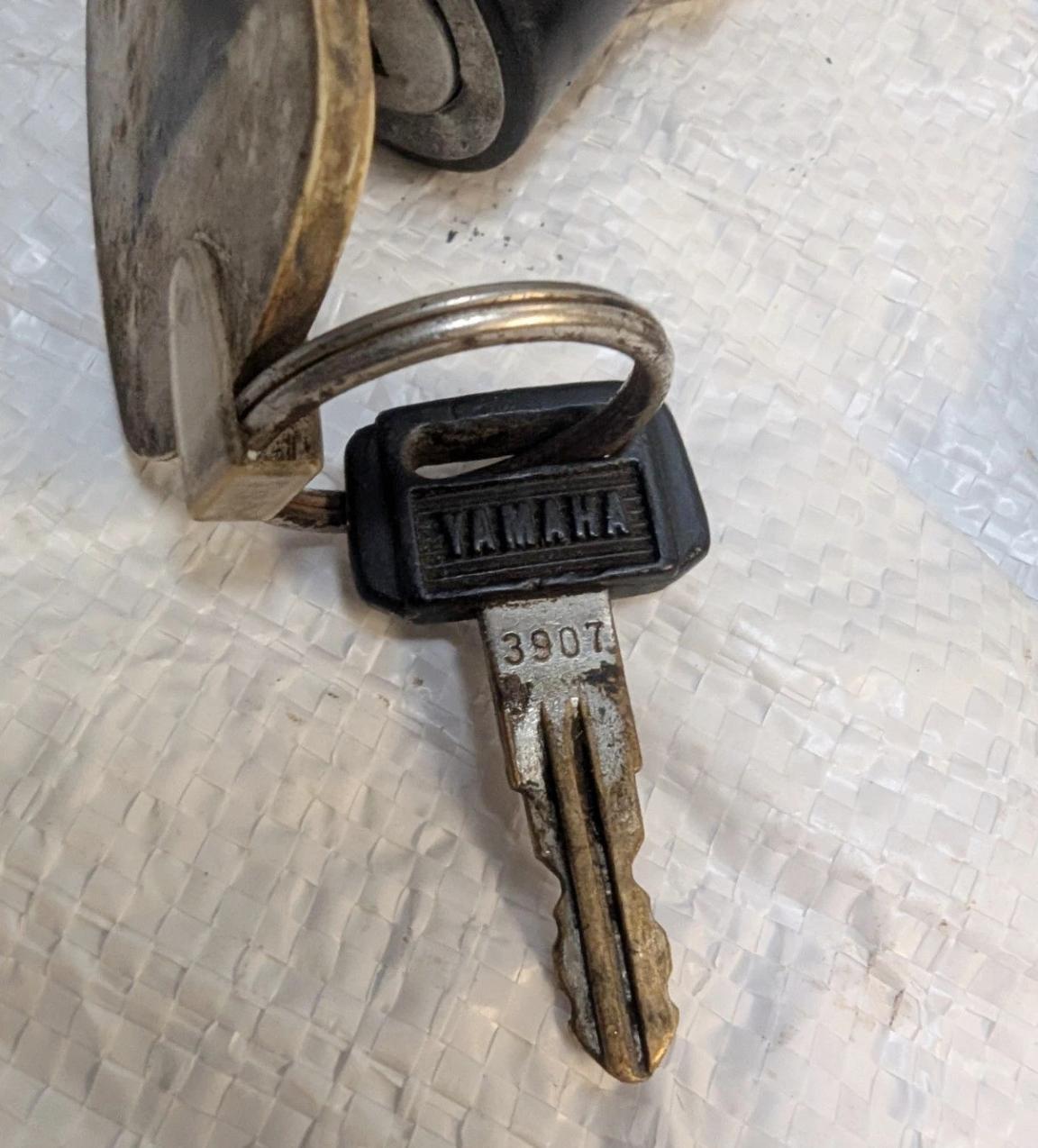

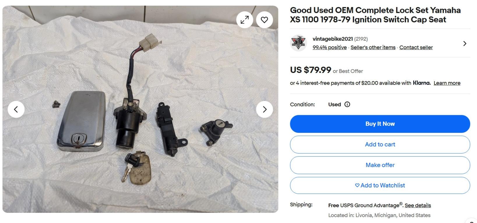

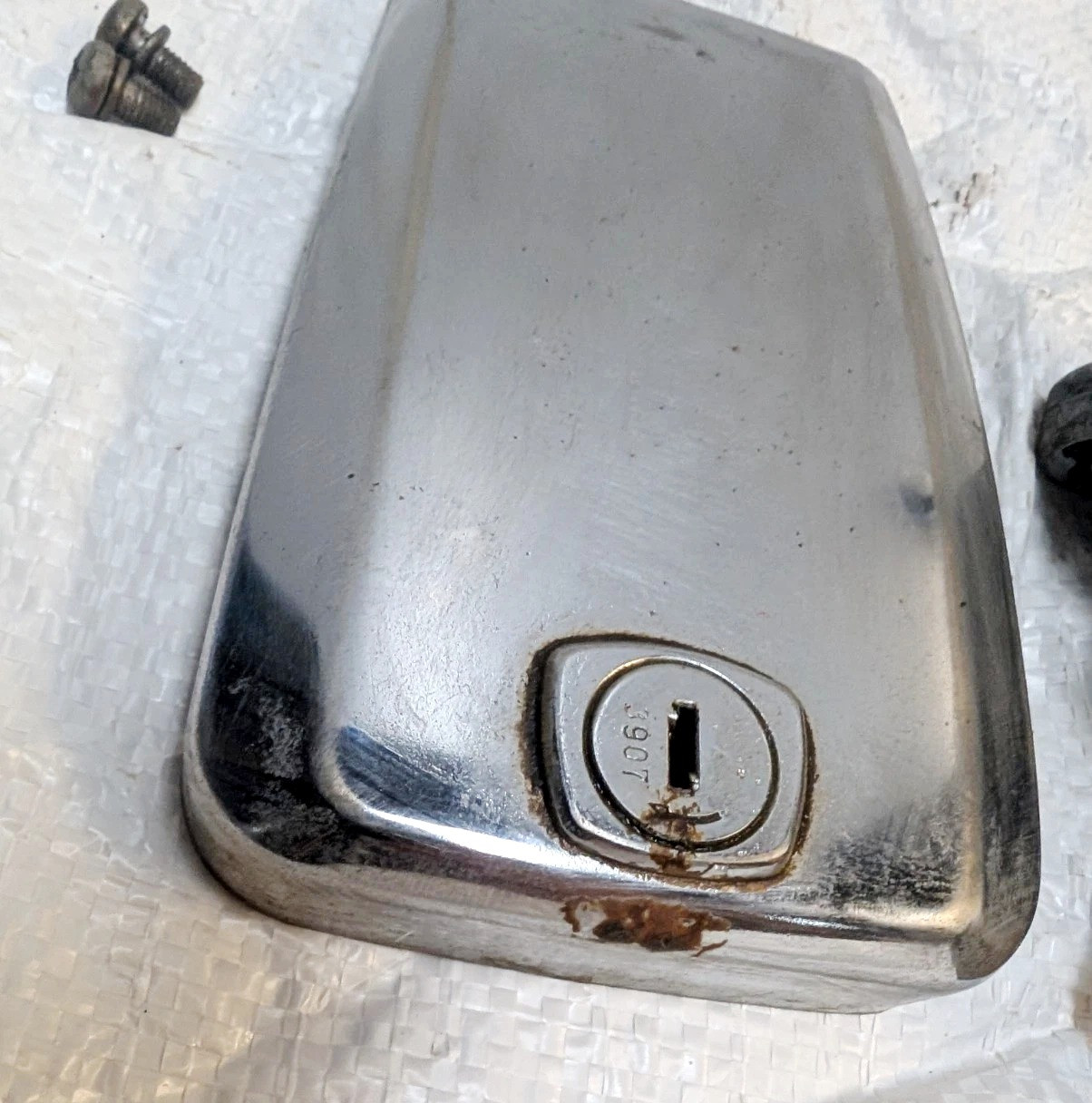

    Seamus, if you look closely at the locks, there are numbers stamped on them. There are four individual locks. The ignition, gas cap, helmet lock, & left side cover lock. The keys need to be cut for the lock numbers. It is not uncommon to have different number with a bike this old.

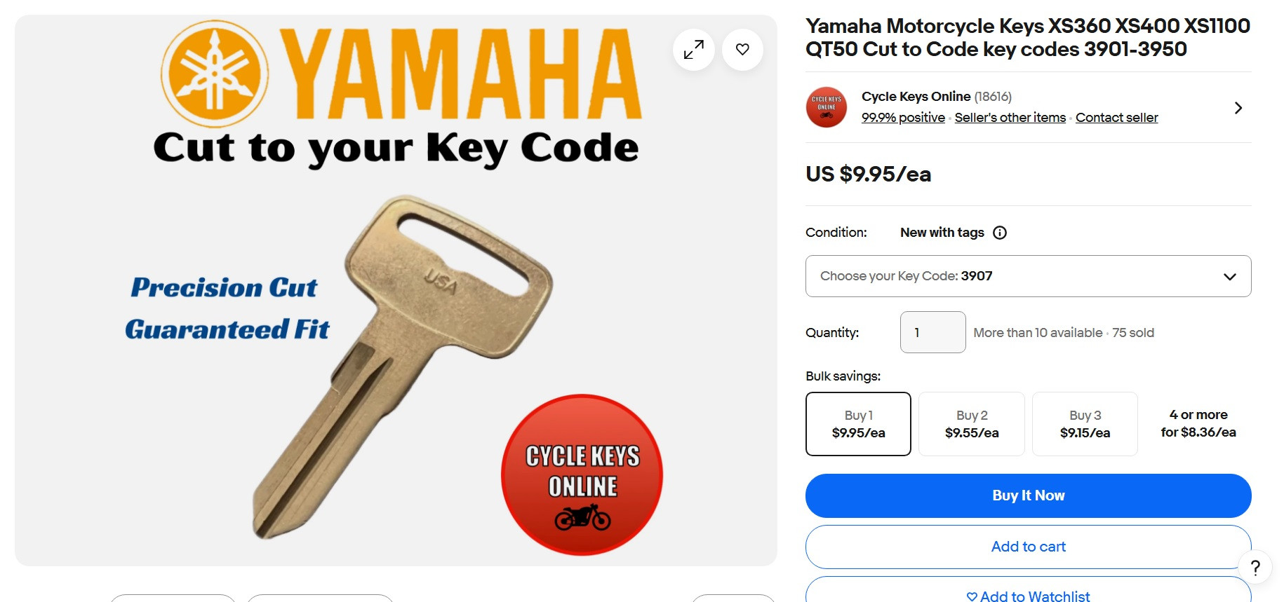

      So in the case of the lock pictures I just posted, the lock number is 3907. I use this vendor for keys and have shown how to input the key number. I have done this with several makes and models of motorcycle.

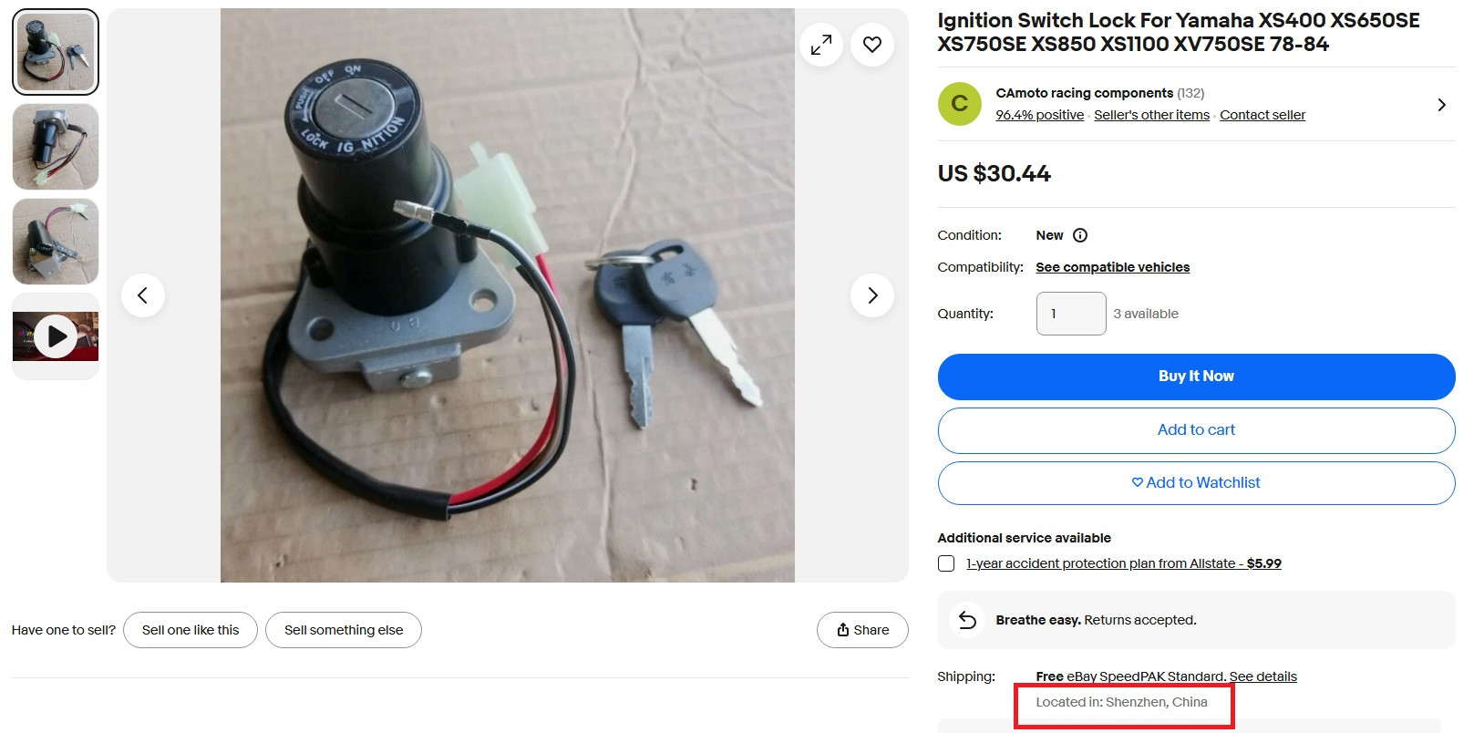

        And as always, stay away from the cheap Chinese junk.

          Here is a typical ignition lock with the number 3945 clearly marked. If you have no mark, it's more than likely a Chinese crap part.

            Here is a full set for your particular bike. Original Yamaha.
            https://www.ebay.com/itm/20550779564...Bk9SR9C__4qVZw

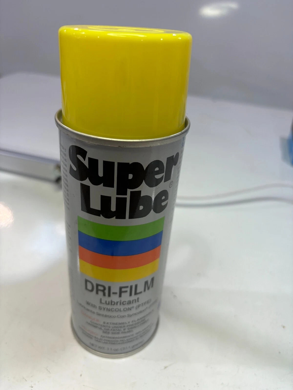

                      There is a 3 in 1 oil spray product designed for locks. That is a much better solution that WD40, as it leaves a dry lube behind.
                        Like Ray said, dry film lubricant for locks. The locksmiths from where I worked all used this product.
