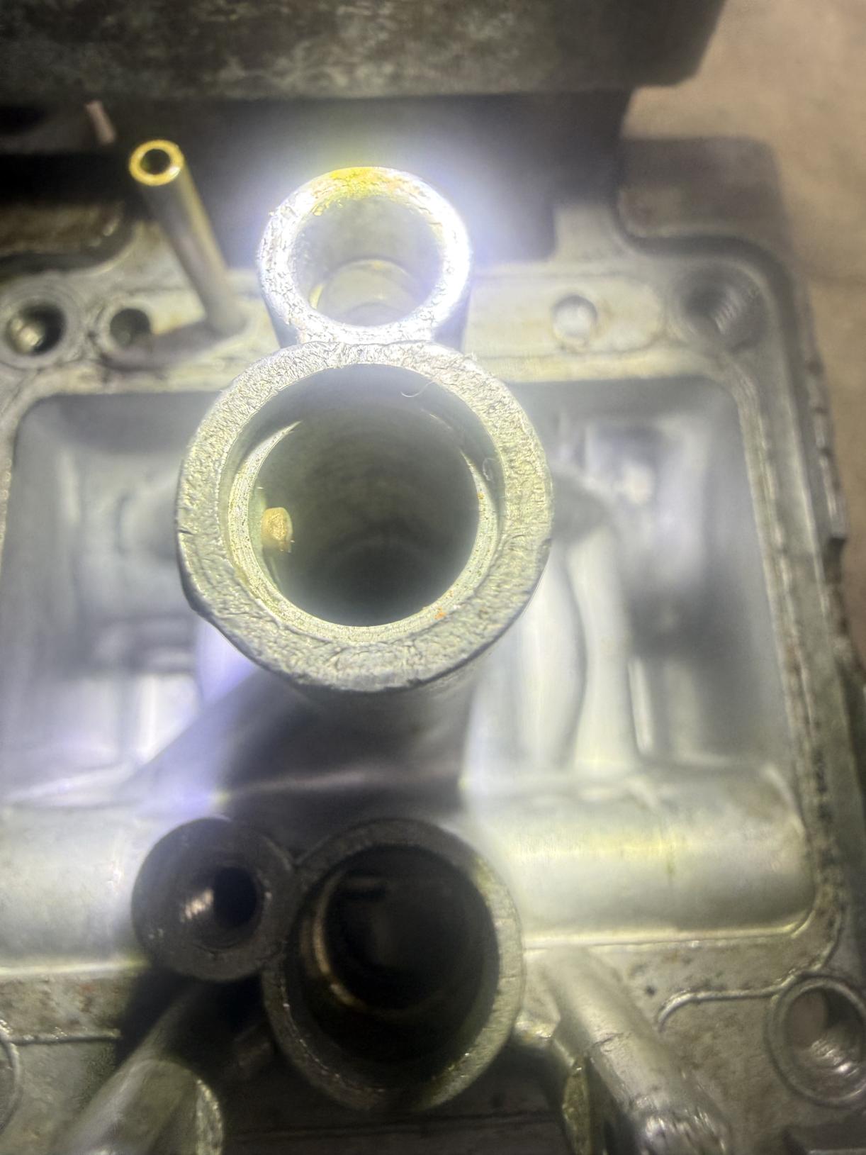

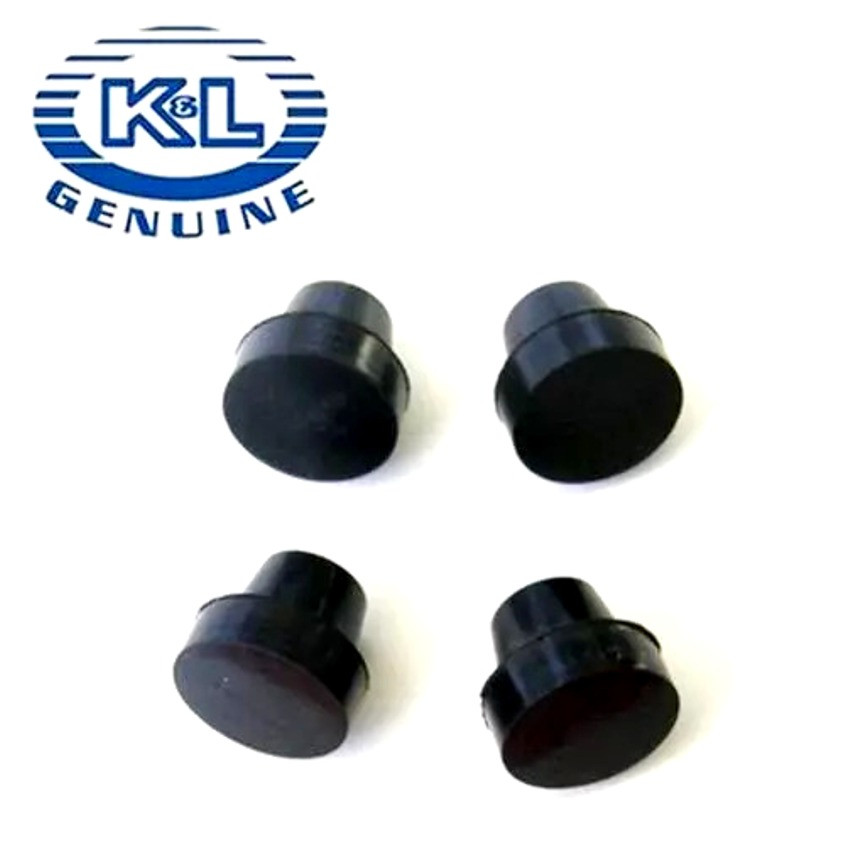

    Rubber plug found but NO passage between the two towers. Can anyone confirm for me that this will have a significantly negative impact on the performance. I am sure I read it somewhere but can no longer find where.
    Why does this matter?
    Thanks!
    • 8891
    No passage hole, do not use the plug, otherwise no fuel will enter the pilot circuit.
      Excellent, thank you Bikerphil

        My carbs are 1980 Standard model XS1100. No rubber plugs. When I was rebuilding I discovered the #3 carb had a pilot screw that was beyond repair and the carb needed to be replaced. I purchased an empty #3 carb body from eBay that was listed as coming from a 1980 Special model XS1100. I reassembled the rack and found that the #3 replacement Special carb had the orifice in it so it required the plug. So in the end, I have one carb that has the rubber plug and the other three carbs do not. The bike runs flawlessly.
        It's possible from what I discovered that the Special carbs have the rubber plugs and the Standard carbs do not. Mine have both.

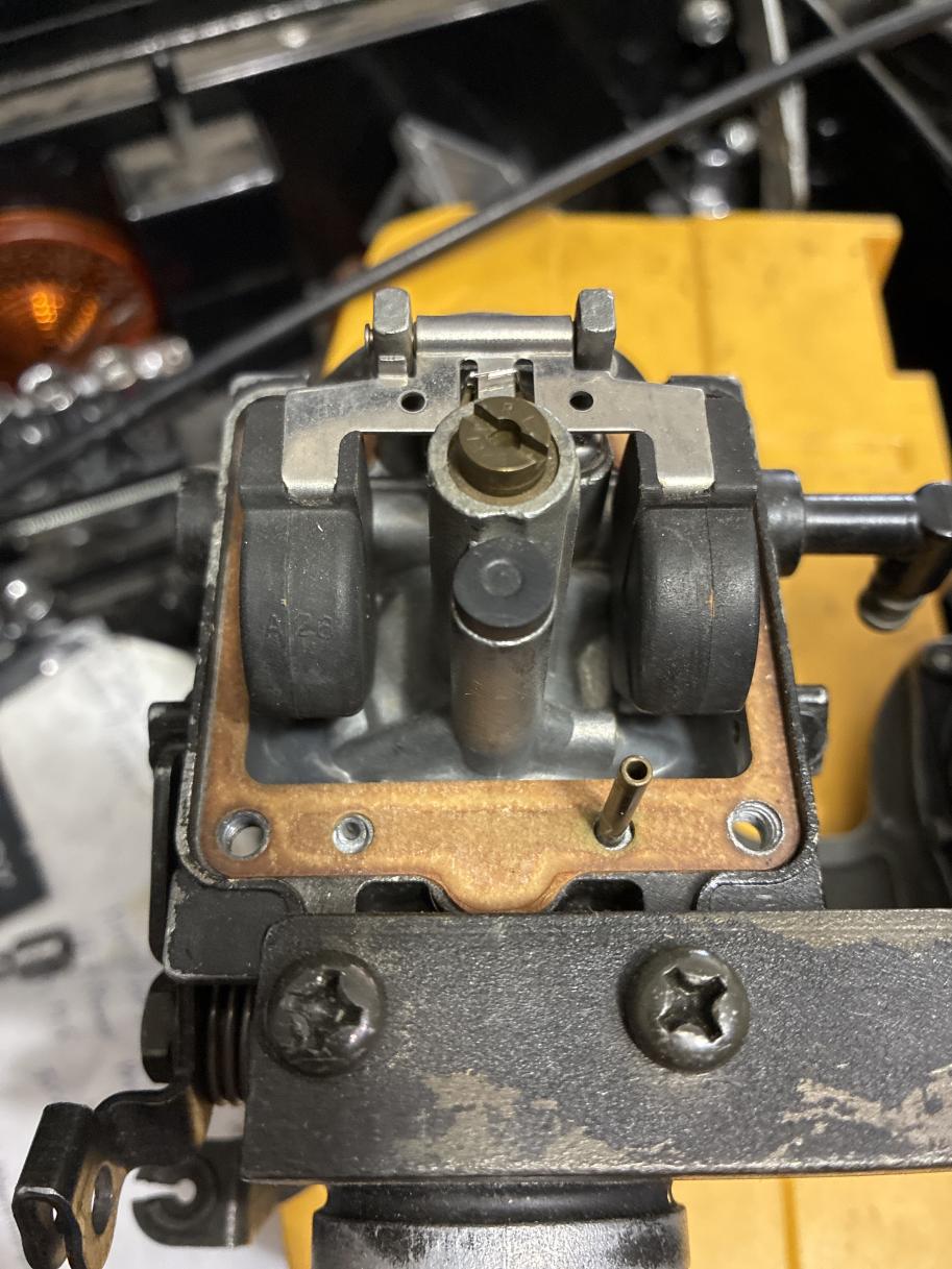

                  The 1980 and later XS650 got BS34 carburetors as did the XS1100. There are differences.
                  Click image for larger version  Name:	image.jpg Views:	0 Size:	146.2 KB ID:	888443
                  There is a passage between the pilot and main jet tunnels.
                  I expect the XS650 carburetors would work just fine if you had four of them.
                  I always replace shaft seals on overhaul. My XS650 carburetor experience was almost twenty years ago. It was chronicled here in a thread with “FIRE” in the title.
