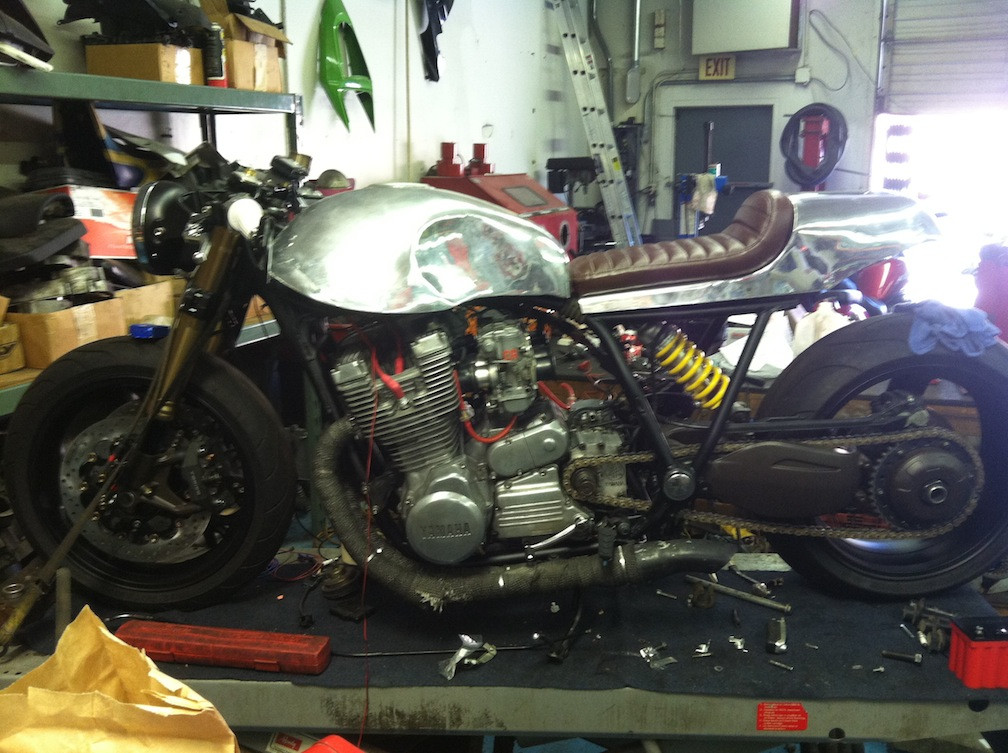

      Got it here:
        • 2057
          • 2057
          Bearing support / transmission assemble to convert shaft drive to chain & sprocket drive on pro-series drag racing motorcycles
            • 2057
            BTW Brill, ain't nobody gonna give you the blueprints to their proprietary product. Some might take it as rude to ask but good luck on your project.
              • 2057
                • 2057
                  • 2057
                            Happen to know where this seat came from?
                              • 2057
                              I believe that seat was hand fabricated.
