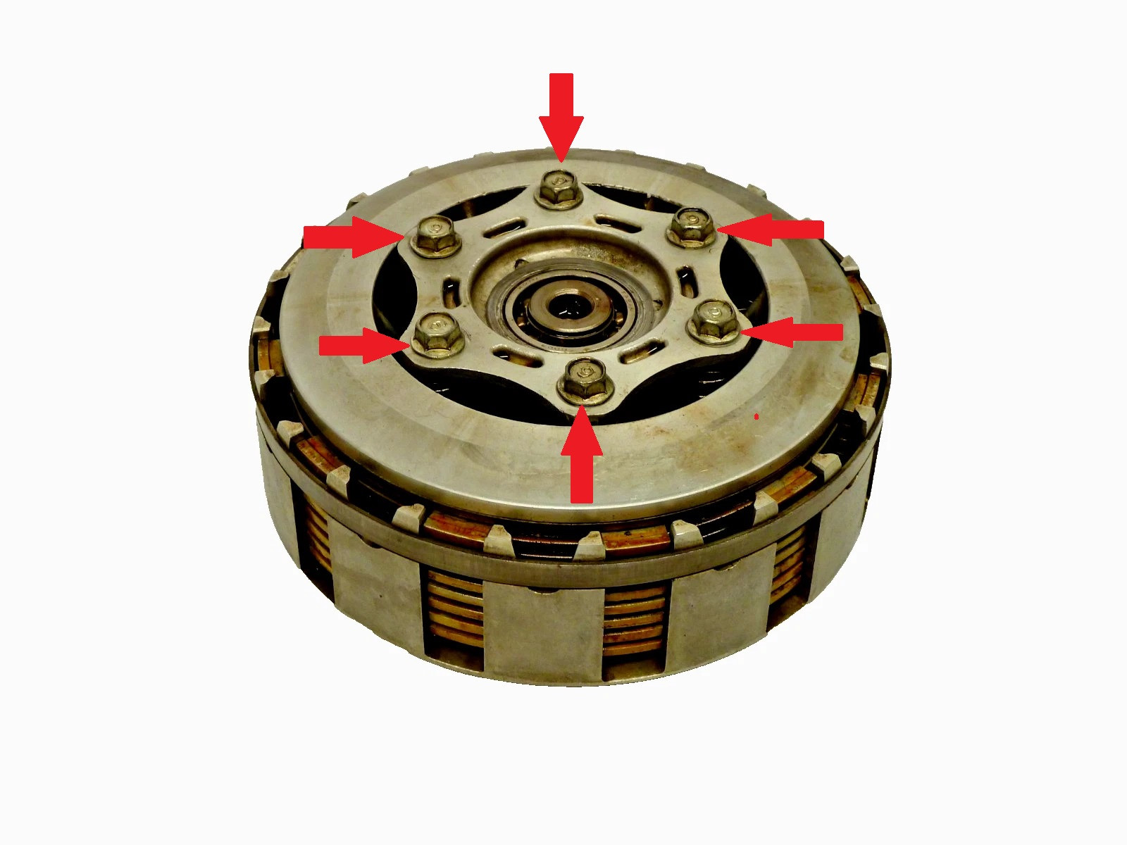

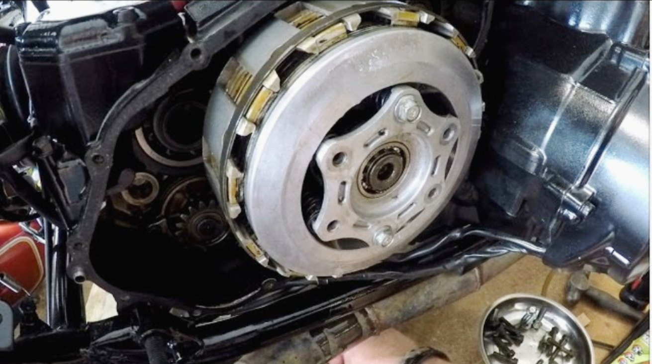

        Phil's call on first gear is a real possibility. And by shifting to second gear and trying to move will diagnose that issue. However, it sounds like the clutch plates could be slipping for some reason. Miss adjusted cable, incorrectly assembled pads/plates, or binding pressure plate would be the next places to look. Could also be a bent shift fork.
        Click image for larger version  Name:	Clutch springs.jpg Views:	0 Size:	227.7 KB ID:	886675 Click image for larger version  Name:	sddefault.jpg Views:	0 Size:	193.5 KB ID:	886676
