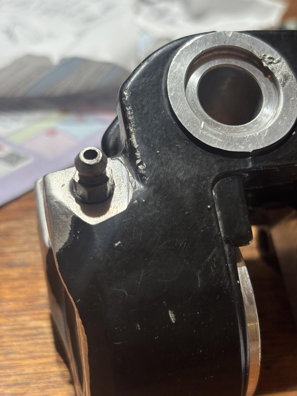

      My caliper seat was unfortunately drilled through by mechanic, Looking for a solution to salvage the brakes. I’m looking at Brake Bleeder repair kits. The smallest one i can find is 1/8 Npt which requires 24/64 drill bit (.3281inch = 8.334mm) according to google. Which should give it enough room to drill. Just want to confirm if someone has done the same procedure.

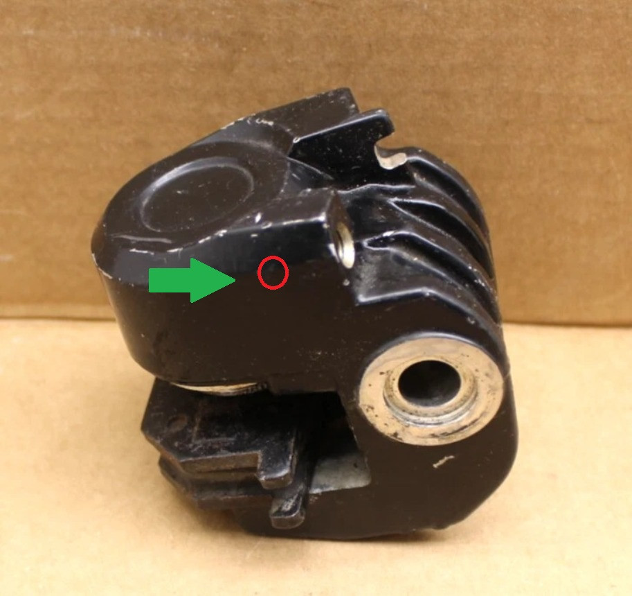

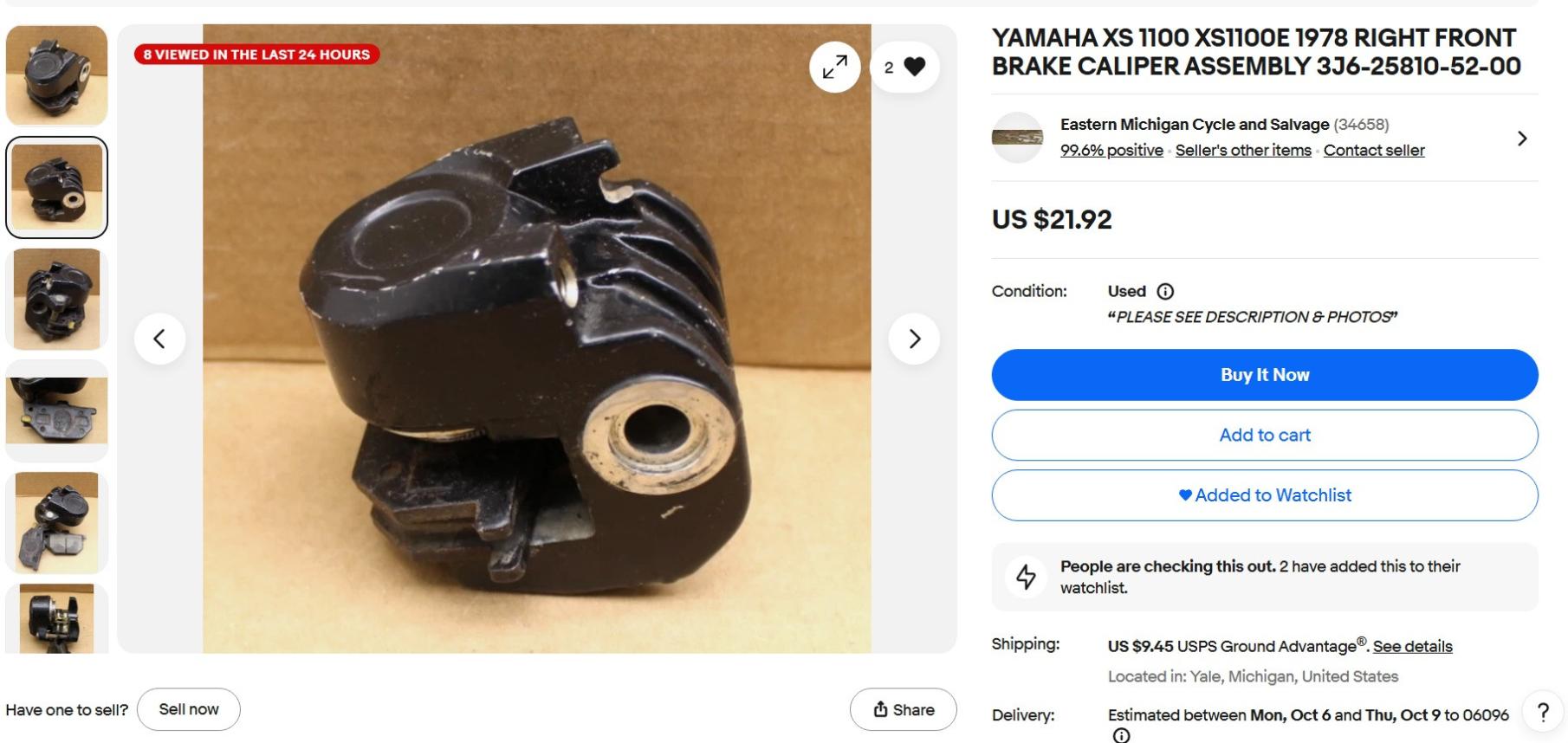

        This is probably a better way to go.
        https://www.ebay.com/itm/40584235727...temCondition=4
          I agree with Deebs. Better to just replace the caliper. Barring that and from your pictures I would assume if done correctly drilling and tapping you could choose whatever size bleed screw you want. the problem you are going to run into is what is going to stop the bleed screw from draining? The original is designed to bottom out when you tighten it. If you drill it out I am not sure how that would affect that. Replacement caliper would be my preferred choice.

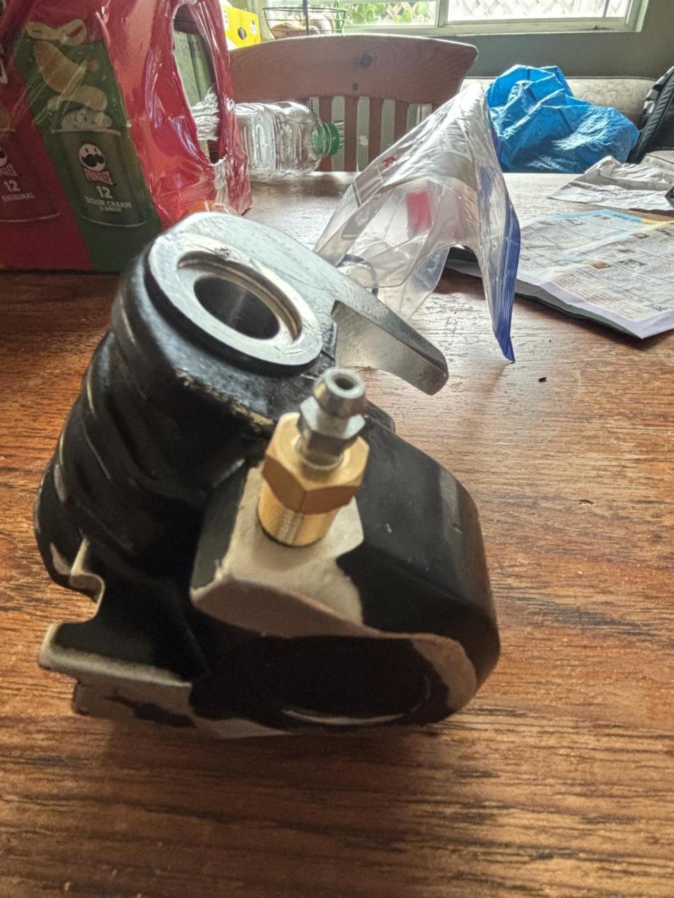

                Thx Cajun31! I like my chance with this insert I found at Orielys for under $5. Physically the dimensions look good. Wish me luck, if it works it can be a solution for others also.

                  The picture you posted is a front caliper?

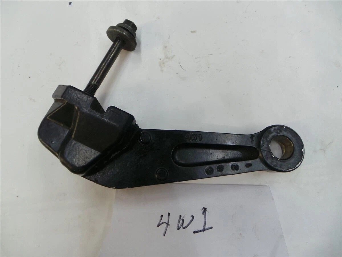

                    Oh, I get it. This is the brake arm. You should be able to use a front caliper on that.
                      This is the caliper I posted. It's your caliper unless I am mistaken.
Name:	81 caliper.jpg
ID:	886284 Click image for larger version

                          Actually the brake caliper you posted actually looks like it but labeled wrong? But the picture I posted is the rear brake, the bracket and the other part of the rear brake is still installed on the bike.
                            The caliper that Deebs posted will not fit the rear of the 81 mns. No where near the same. Just keep your eyes open for a replacement caliper. There are several xs1100 groups out on facebook. Might be worth a try to ask out there. Sometimes you can find what you are looking for quicker there. Just watch out for the scammers.
                              I see it now. The bleeder is pointed in-line with the mount and the one I posted is perpendicular to the mount. I will keep an eye out and see if I can find one.
ID:	886300 Click image for larger version
