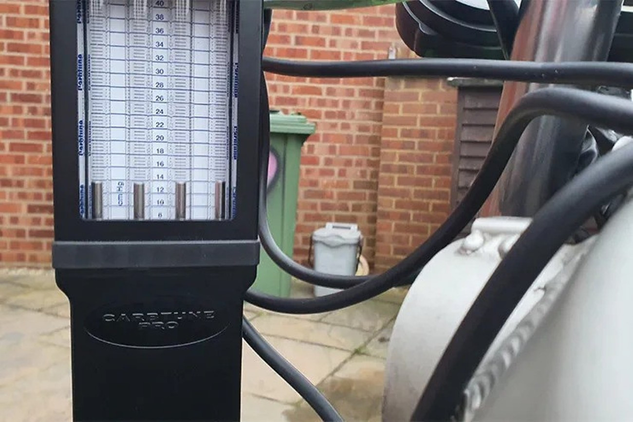

    watch this,,,,youtube https://www.youtube.com/watch?v=hfeiF-3lsXw there are three screws to adjust on the front of the carbs,,lift tank up with a 2x4,,,hook up the synch hoses to each vacuum nipple on each carb, start bike and adjust outside two screws until both l, r, carb pairs are equal, then adjust center screw to balance both pairs,,,,,get the air vacuum gauges, ebay or wherever and you will use them probably annually to keep bike running strong......keep us informed,,,Mike in San Diego and Pa.
      This is the best tool for the job.

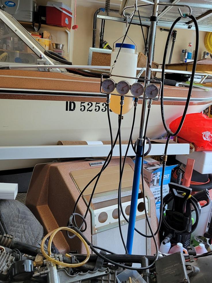

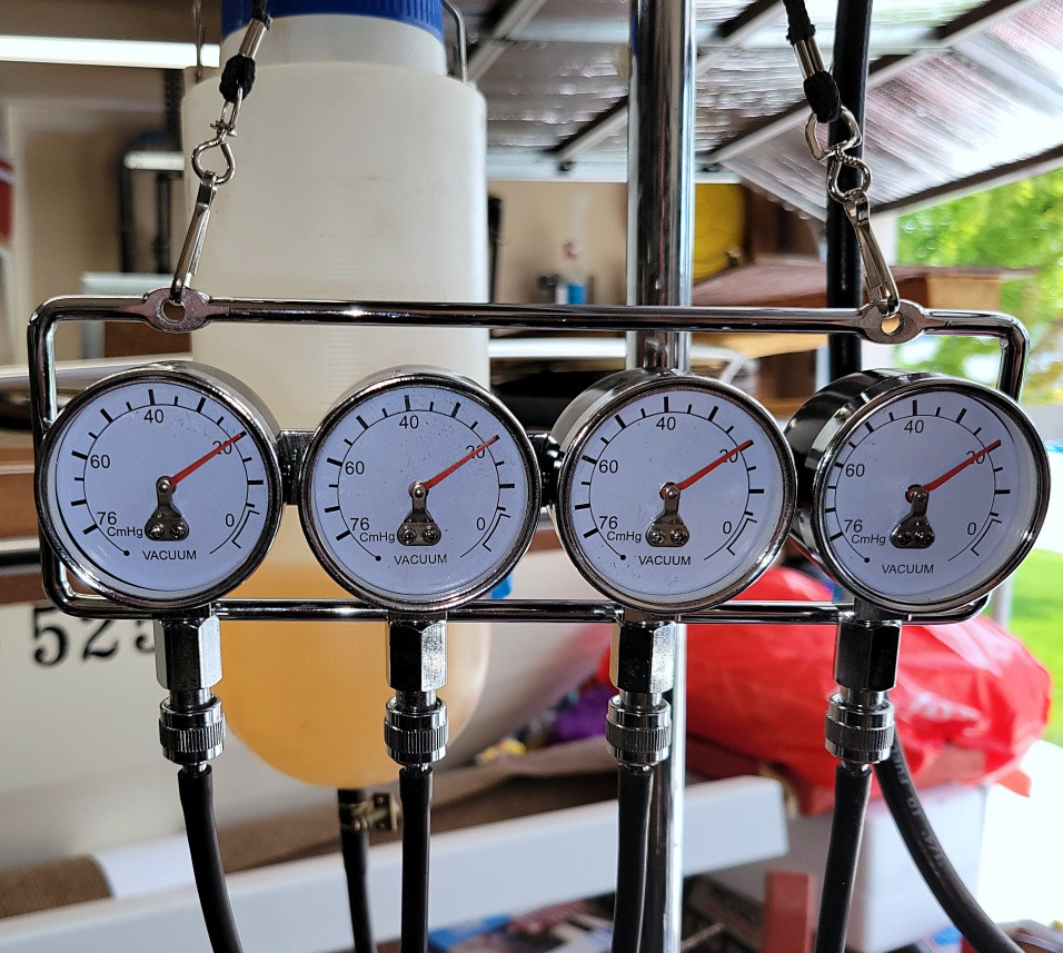

        A photo of what I use. Old school, but works well as long as you check all 4 against each other before each use. Note that I use the plastic tank for fuel, so the tank is removed from the bike and I have easy access to the adjustment screws. The gauges are all connected to the vacuum pump in the photos, to verify the same readings each time I use them.

          I too use the carb tune. I like it because there are no fluids in the gauge to worry about and they are close enough to get the job done right. The best way to approach the job is to either have a tank like Ray shows or you can simply remove your tank and turn it around and rest it on a small board across the frame and on the fender with a good towel underneath it. That allows you the access you need to the adjustment screws on the carbs.

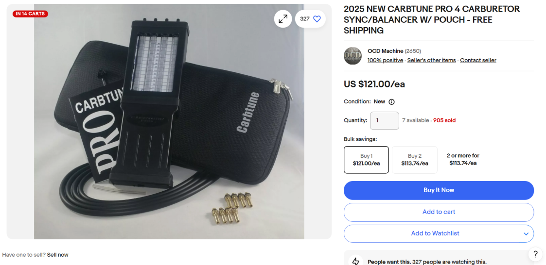

            here is the one I use,,,good because no mercury, you can rev the helll out of the engine and easy to adjust to read the needles......https://www.ebay.com/itm/25704027214...3ABFBMrMin6rRm
            and its down to thirty bucks or so......MIke in San DIego and Pa

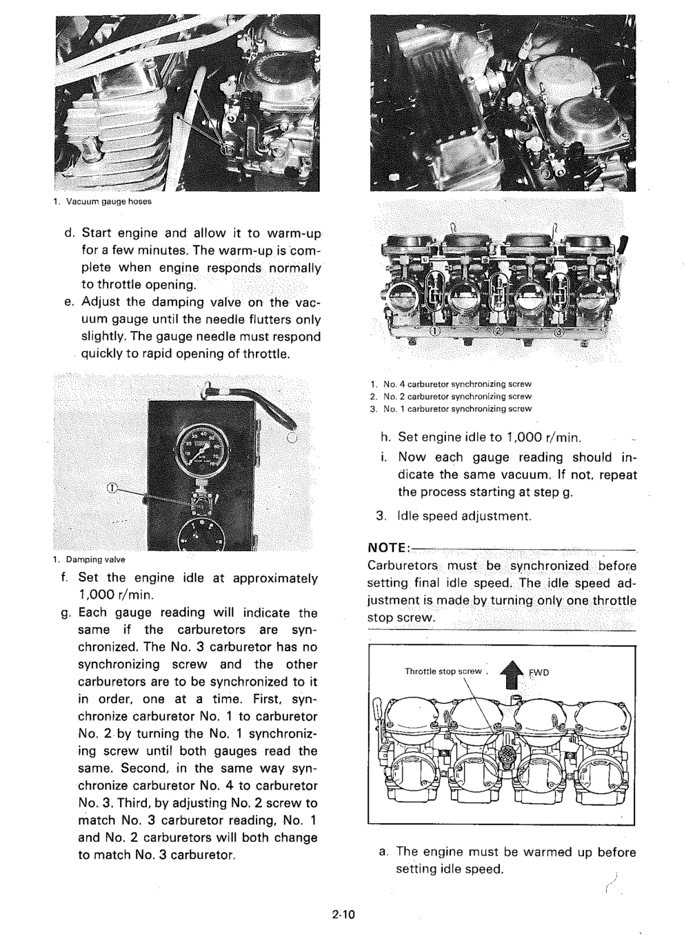

                    This is a good tech tip on how to proceed. Synchronizing the Carburetors - XS11.club Forums. The video posted above was a bit confusing when I watched it and the way the tank was situated did not leave a lot of room for connecting hoses and allowing access to the adjustment screws. Better to follow the tech tip and turn the tank around. Sounds like this is your virgin journey on synching and it will take you a bit longer so give yourself plenty of room. As stated, you need to put the petcocks on prime or you will run out of gas when the bowls empty in the on position because the octy will shut the fuel flow off when the vacuum hose is disconnected. If your carbs are adjusted properly and you don't have a flooding issue then putting them on prime should not be a problem.
