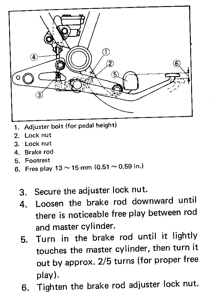

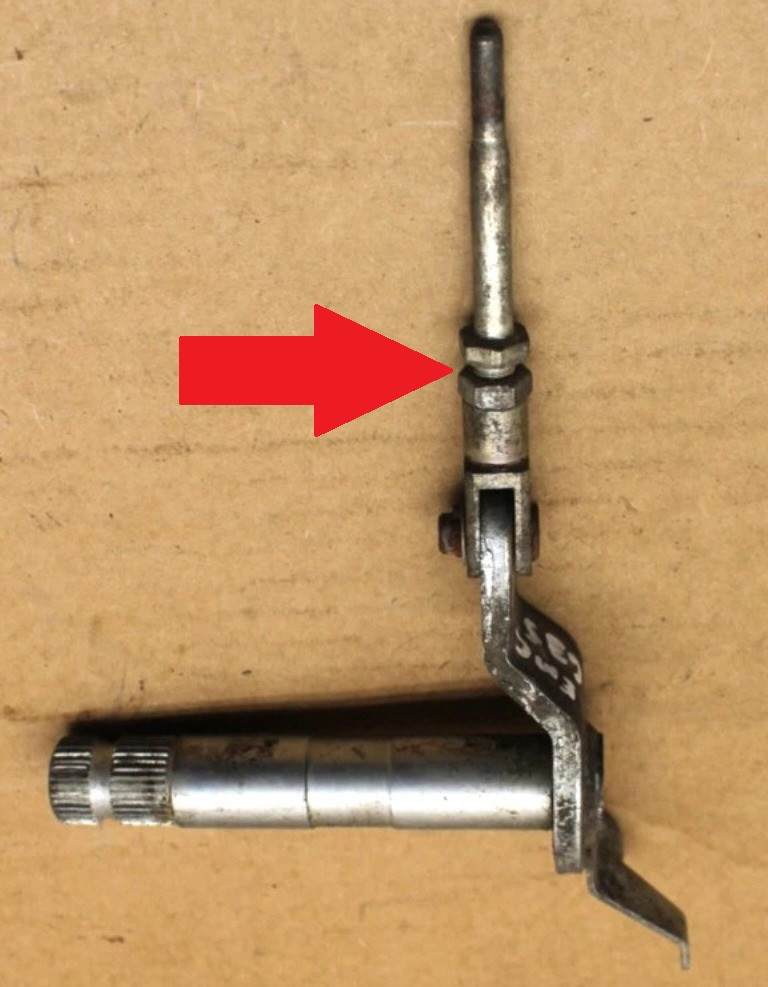

            Your original post did not answer any of our original questions. The reason I asked them. On the rear master there is also a small adjustment that can be made on the brake rod going up into the master. If that is adjusted correctly then all that is left is to bleed the system better. The only thing that is left would be crud and that is generally worse, as you know, when the bike sits up and still for longer periods of time. You, being on the move all the time probably don't have that problem. These brake systems were never the best to begin with.

                I think Cajun31 hit the nail on the head. It's the length of travel. The adjustment of the length of the brake rod that pushes the master cylinder piston up into the bore. When you used the clamp you shortened the hydraulic distance needed to have solid pressure. When on the bike, the distance was increased and just out of reach of that travel. The pads wore until the present adjustment could not reach anymore.

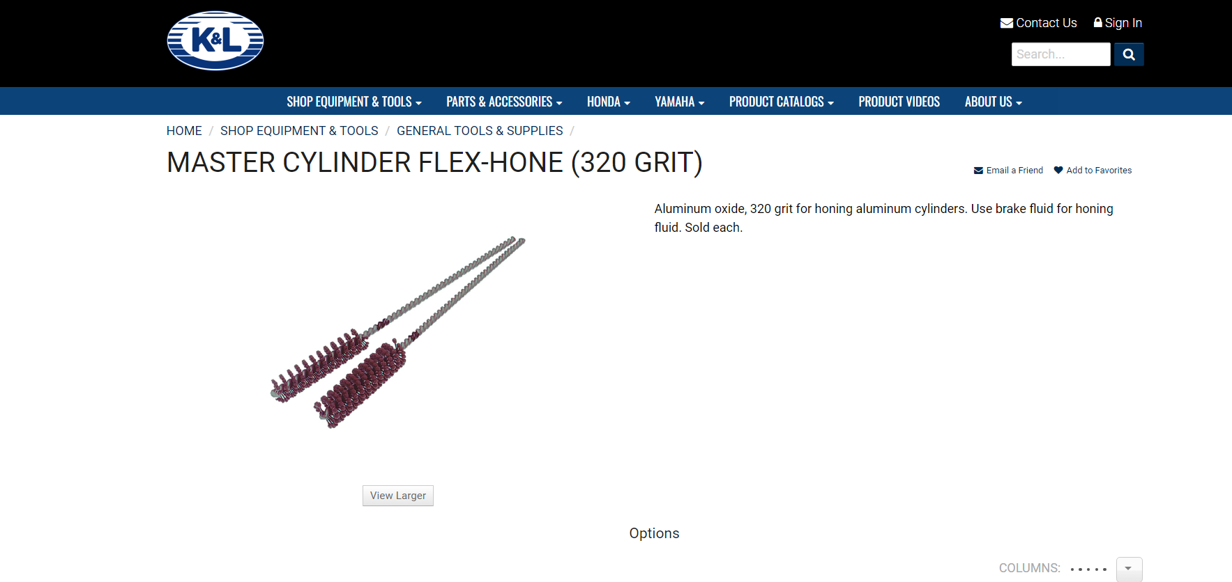

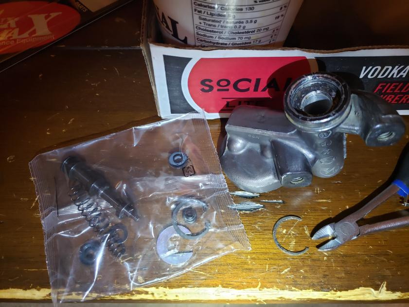

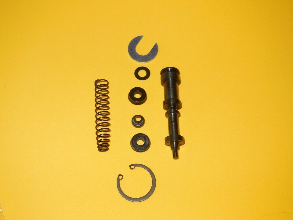

                        Another thought: The bore could have some pitting in a certain area also where it would lose hydraulic pressure. A hone & rebuild kit would repair that if necessary.
