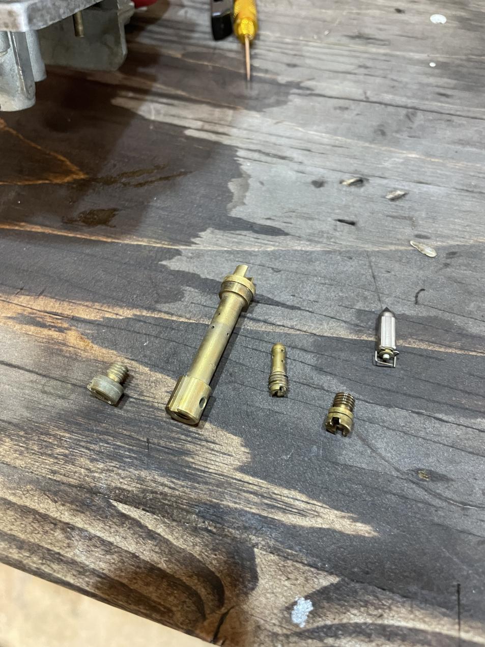

                          I got in the carb today and nothing jumped out at me, although I am a beginner. These were all the jets, tubes, and needles all seeming to be clear and open holes. Am I missing something else that needs to be cleaned?? There was plenty fuel in the bowls.

                            Make sure the passage in the bowl for the enrichment circuit is clear. There is a non removable jet in there. Spritz carb cleaner with the straw through. You can shine a bright flashlight in the lowest bowl passage and see the jet thru the top passage if it's clear.
