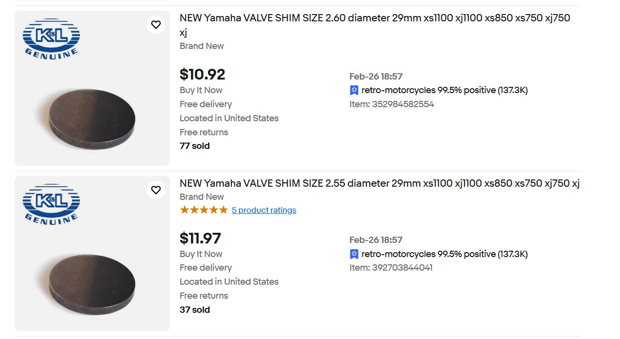

      Where does a guy get replacement shims for valve adjustment? My local dealer?

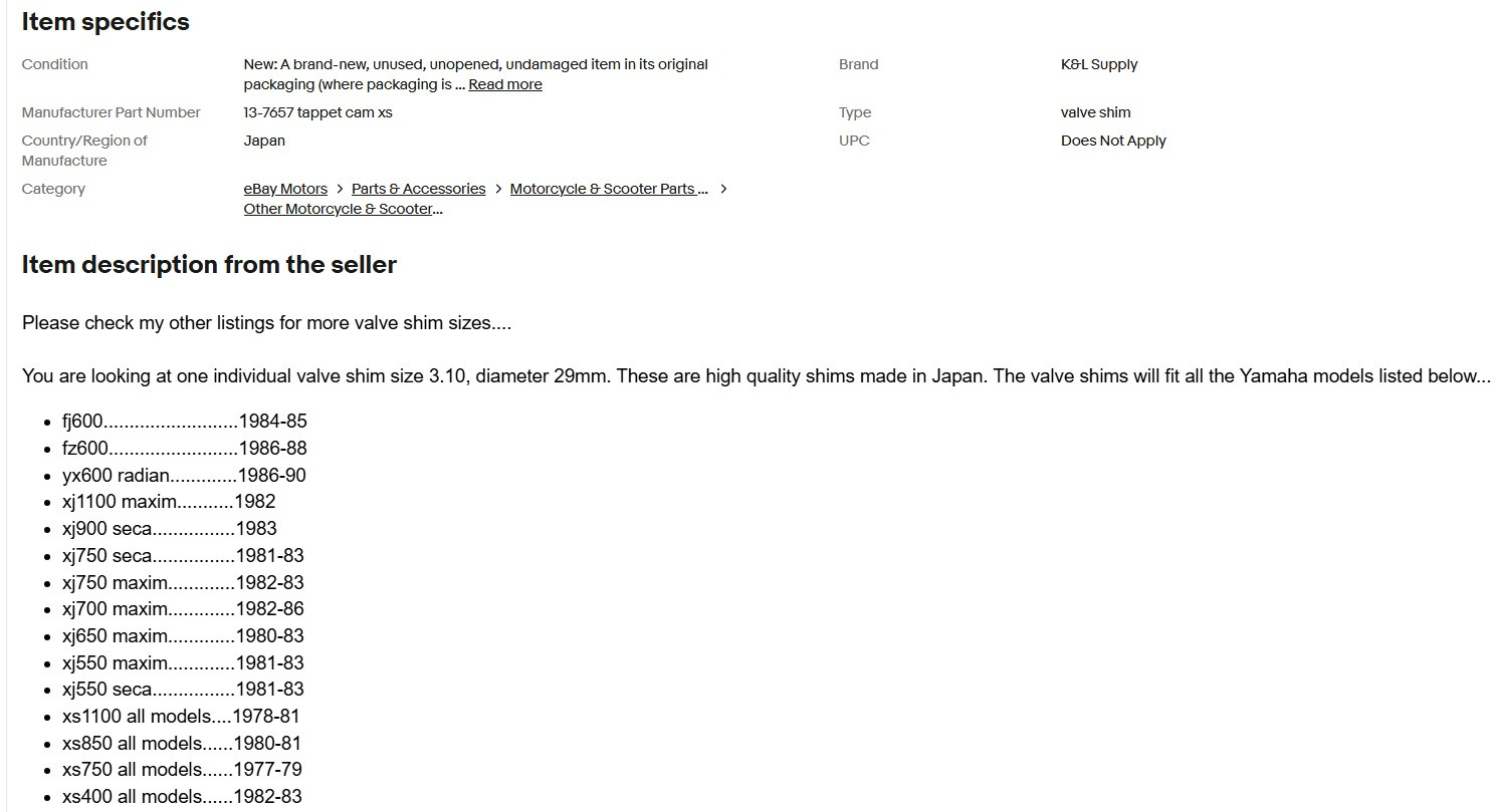

        Post a list of the shim size you need. I do a "swap", as I've collected a few in my years of owning these bikes. As I remember, Kawasaki and Suzuki both used shims of the same diameter on some of the models they produced, so that may also help. Without looking at anything, I think they are 22mm, but PLEASE double check first.
        Whatever you do, do NOT BUY "aftermarket" or Chinese shims! I tried once, and had them break under normal use!!!
          • 2118
          I believe the shims are 29mm diameter.
            • 8861
            And the Suzuki uses 29.5MM
            Ours are 29MM
              • 1971
              I have used Japanese K&L on 3 of my old bikes (Yamaha & Kawasaki) with success. Lots of Chinese crap out there to avoid.
